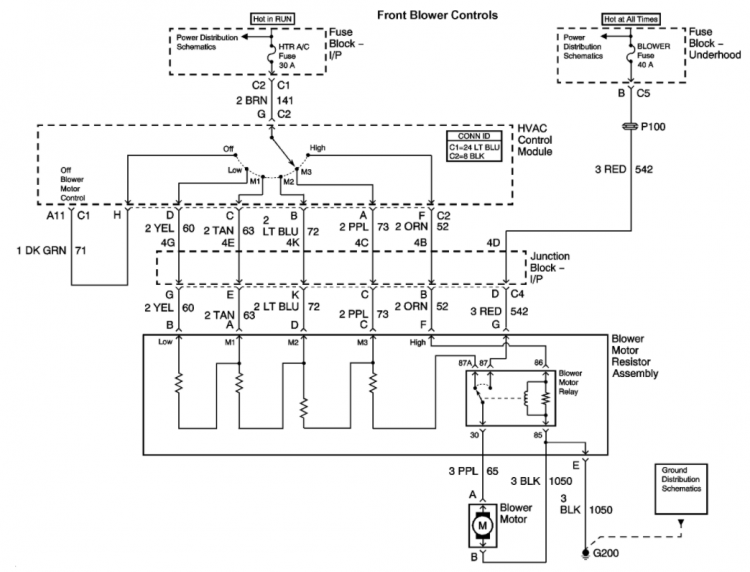

  1. Think I got it, I finally found a diagram that makes sense. The blower fuse under the hood is blown.
  2. Hey all, I recently had my blower stop working on 1, then on all speeds. Figured it was the resistor pack since I had the same issue a couple of years ago so i pulled it out to check, and found one of the pins in the resistor pack had completely melted both the male and female ends. Following a forum post from somewhere I ordered a full blower motor kit (motor/resistor pack/ new connector and partial harness) and installed it today. The blower now works like it should, except when set to 5 it shuts off. It does click audibly when the dial is set to 5, which i remember reading is proper operation, but the motor does not move. Just wondering where I should start looking. I'm guessing either one of the connections I made on the new harness isn't good enough (can't make enough sense of the wiring diagrams to see which is 5), or rockauto gave me a bad resistor.
