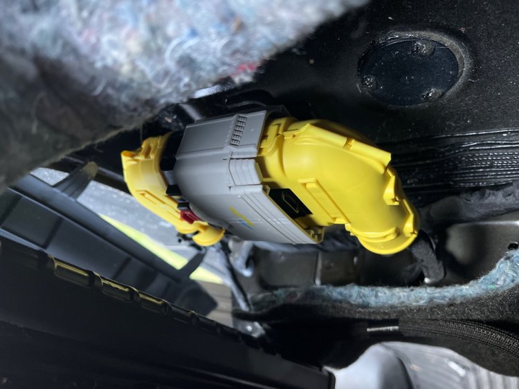

  3. Thanks for the response, my problem is I’m not finding that plug underneath the passenger seat to plug the harness from my console into. I’ve got a brick under my passenger seat that has two connections to it, one goes under the left seat track like you said but it is connected to another brick located under the center console. there is also another harness connected to this brick that goes towards the driver seat. The other connection underneath the passenger side goes back towards the dash. My Jumpseat had no USBs or power connections to begin with, so I’m wondering if my model doesnt have the hookup that yours does. I’d be willing to do some hard wiring but don’t really know where to bring the power from. First pic is the brick underneath the console, second pic is the brick underneath the passenger seat.
