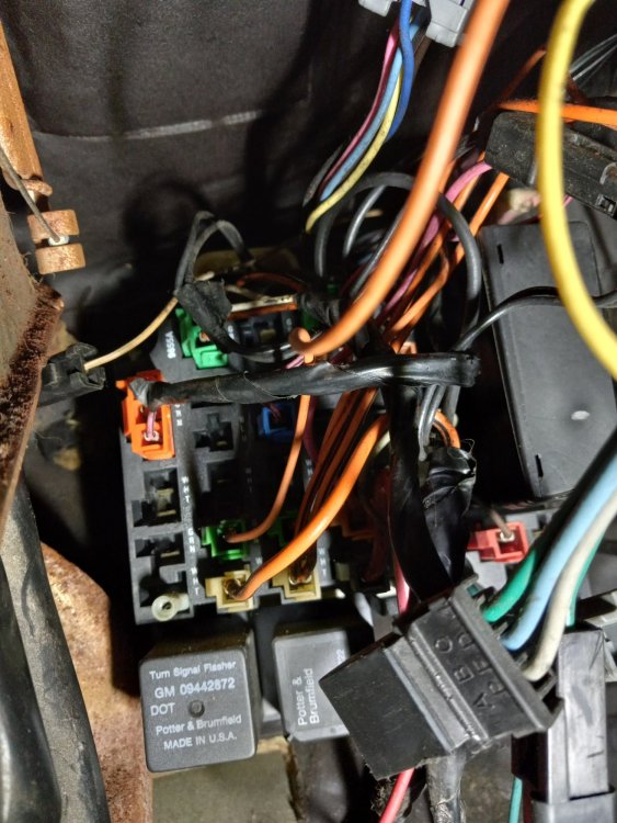

  3. So I've got a good FP relay. I was able to have someone turn the keu on. I'v got to check the exciter wire to the coil. My test light just turns on and stays on. I think i need an led test light. All my fuses are good. I've still got a clusterphuk near the drivers floorboard - see pic- The icm i installed late yesterday didn't help with the no spark from coil. Nor did a new coil, so jst trying to track down why no spark from coil, no injector pulse.
  4. On my way to make some more tests. I can hear the fuel pump if I remove the connector to the oil pressure sender and jump the 2 outer pins. (key off or on, never stops until jumper removed) There is also a 2nd smaller guage red eire "inline fuse that's no hooked to positive batter post. I have a feeling its either a power wire to charge the battery or? Gotta trace it to see. Was supposed to be running as is. Putting my effort into why no spark from coil when engine turns over. Then move on to TBI injector pulse...could be same problem. Replaced the ICM yesterday and coil. Think it may be a fuse or wiring. Looking for more info on the fuse panel below the gas pedel. There is no relay box under hood, just one FP relay thats oval. 5 Pin. I kow this isn't much info but gotta drive 30 mi to get to the truck. Will buy it if it runs. Prevoius owner just removed a security device(aftermarket) put a used FP in it. -- My main issue is no spark from coil. (it's new along with the icm i installed) distributo looks like crap but the pickup under the rotor looks ok.
