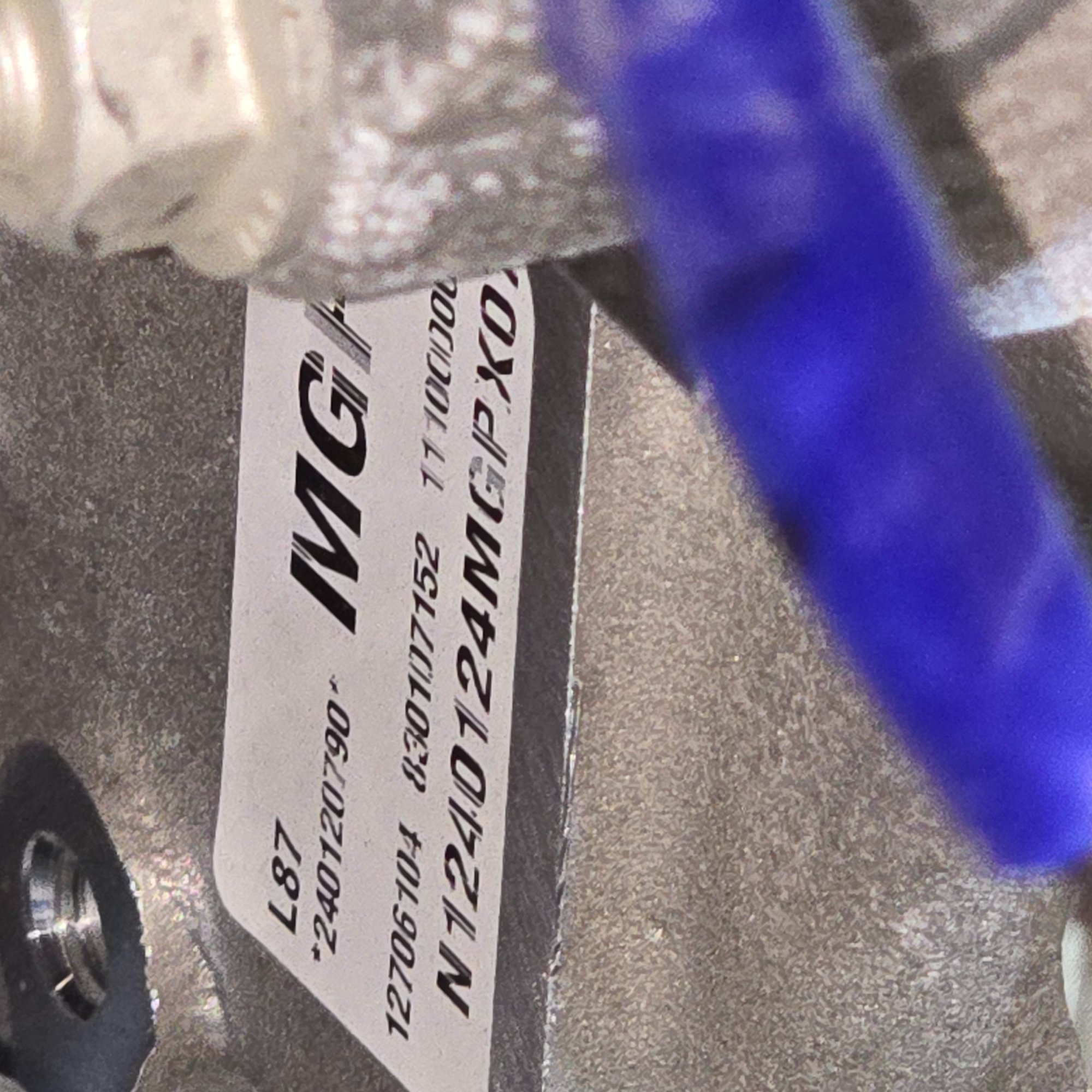

  6. Look on the back of the engine. There should be this date of manufacturing tag on the rear of the engine on the right or left cylinder head. You will probably have to get on the ground to get a good picture like I did. First 2 numbers under the L87 is 24. The year it was produced, and I believe the next 3 or 4 numbers are the number of days in that year
