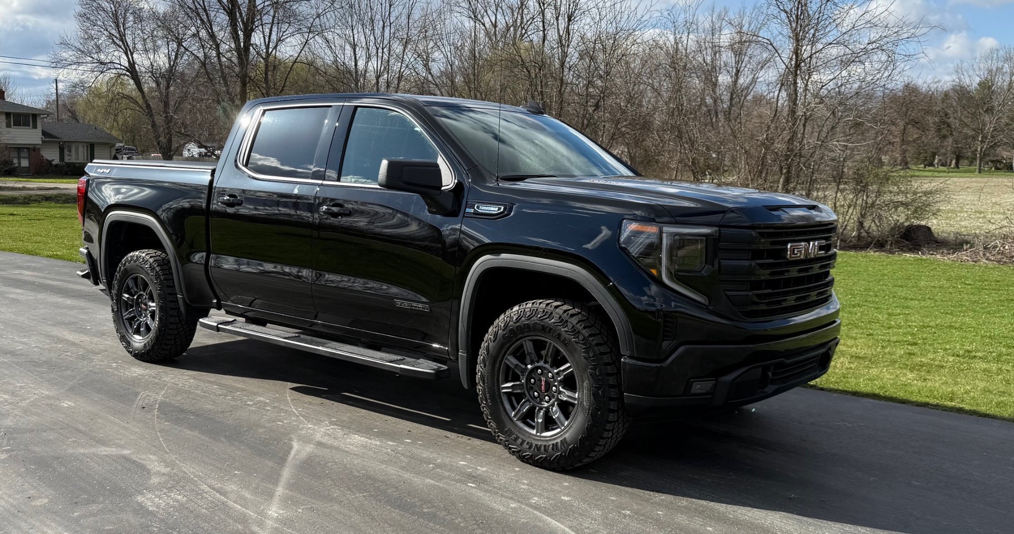

2025 Elevation 2" level bilstein 5100's and 1" rear block.. Stock Take off AT4X Wheels and Tires (275/70R18 Wrangler Territory MT ElevationX -

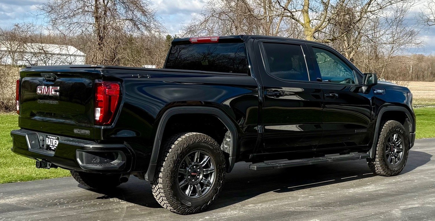

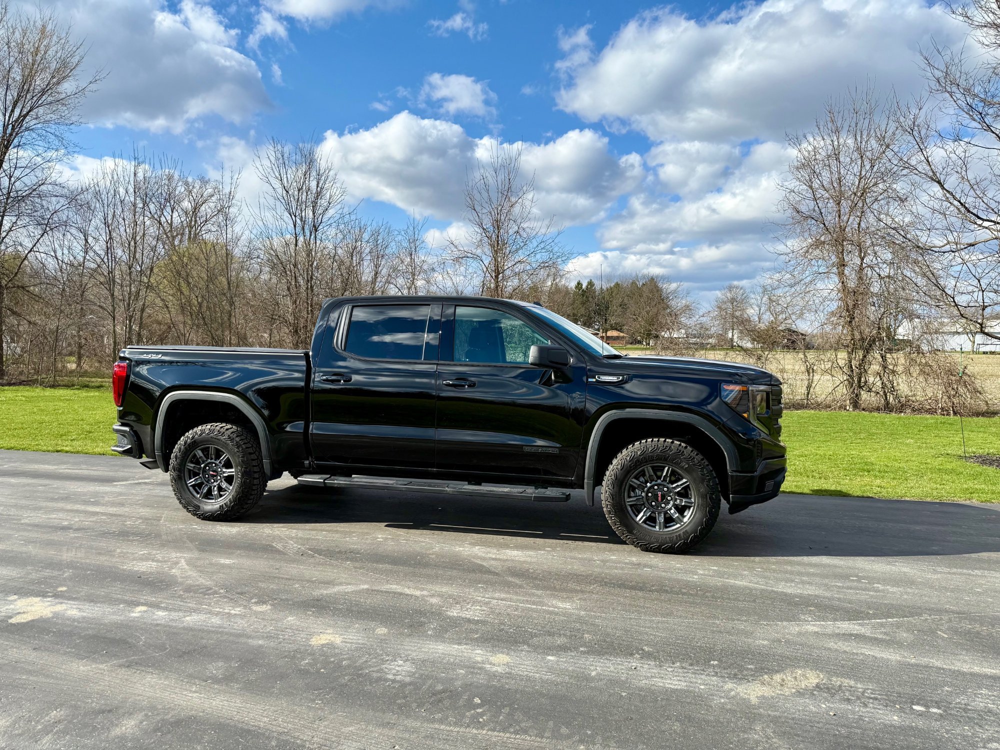

Not much traffic here anymore but I'll post my new setup. 2025 Sierra Elevation. Billstein 5100 Ride height adjustable shocks set at +2" in front 1" Rear Blocks from 2018 truck although the Ubolts changed in 25 to M14 and Round so you need to figure that out. LT 275/70R18 Wrangler Territory MT (Stock 25 AT4X take off Wheels and Tires)
I just did a leveling kit and found out about the ubolts. I had a busy shop do it and it was the first one they had seen. I asked him if we saw any other differences and he didn't thing so.
I did the Billstein 5100 adjustable ride height shocks set at 2" with 1" rear blocks from 2018 silverado on my 22 refreshed silverado. I ran 275/65R20 Nitto Recon Graplers on stock Rims. 37,000 miles and not 1 issue Drove like new when I sold it. Picked up a 2025 Sierra and did the exact same thing, except I bought a set of take off AT4X 18" Wheels and Stock LT275/70R18 Teritorry MT. Tire calculators say these are 0.5" shorter then the tires I had on the 22 but I had them side by side and these were slightly taller than the Nittos with 37k miles in them.

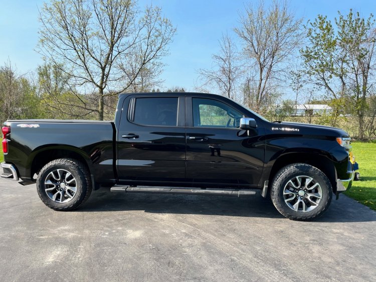

I used the 5100's set at +2" to the front of my 2022. increased the tires size from 275-60/20 to 275-65/20. Tires are an inch taller at 34" vs stock 33" The combo raised the front 2.5" and the rear 0.5". Truck is perfectly level. The Body style for the 2019-2022 makes it look a little front high sometimes so I'm adding 1" rear blocks this week to give it just a little rake. No other leveling kit was added (i.e. spacers) I think the shocks are the way to go for leveling and there is no need tor spacers unless you want to go higher. The pic is how it currently sits with out the rear blocks. -

I'm on 34's (275/65R20), Stocks are 33" (275/60R20) The Height is 2.5 Inches taller than stock. 2 Inch from the suspension and 1/2 Inch from the tires. In the picture there is no lift in the rear other then the tires. It almost exactly level but sometime it looks nose high because of the Silverado front fender body lines. I have some 1.2" rear blocks from the previous gen trucks that I'm going to install just to level it out to the eye a little more. I parked next to a trail boss the other day and the front of my truck is about 1/2 taller, the rear is about 2" lower as the Trail Boss has a pretty big rake. -

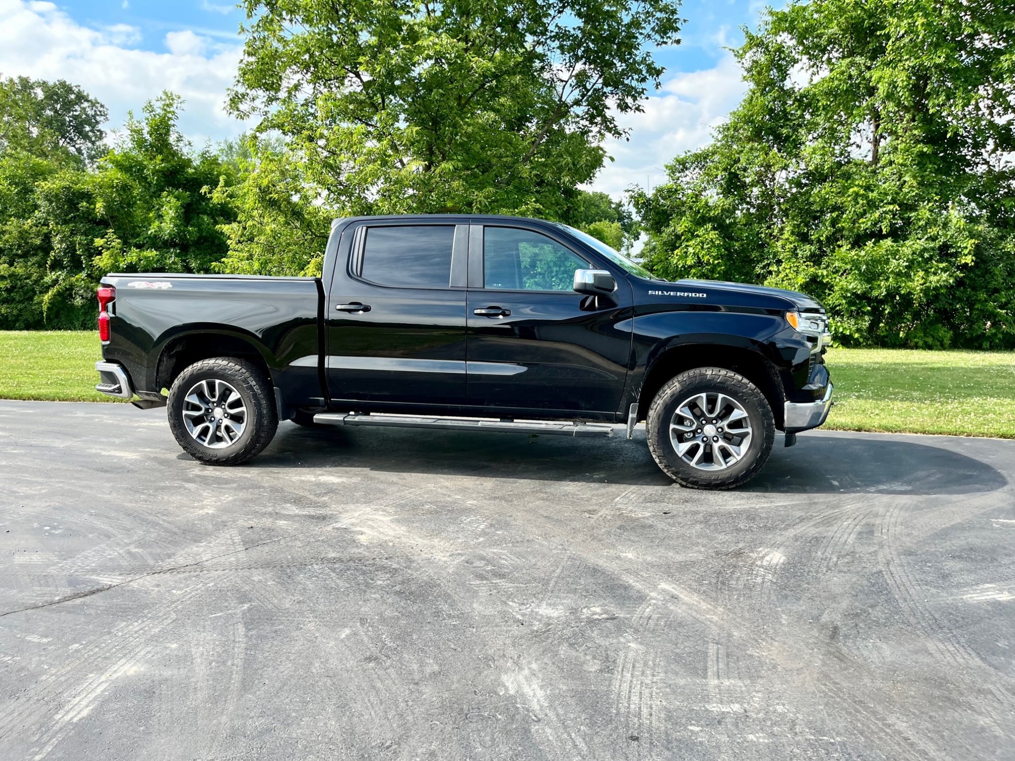

Nothing extreme but I did a 2" lift with Bilstein 5100's and Nitto 34" Tall 275/65R20 w stock wheels on my 22 refreshed Silverado LT 2.7L. Nitto is the only 34" tire you can get in non Light Truck load and it only weights 4 lbs more than stock LT tires are all 13-18 lbs heaver each and its that unsprung weight that really kills MPG. Fuel economy was not effected in my case and I looks way better than Stock IMO. RIdes better too. -

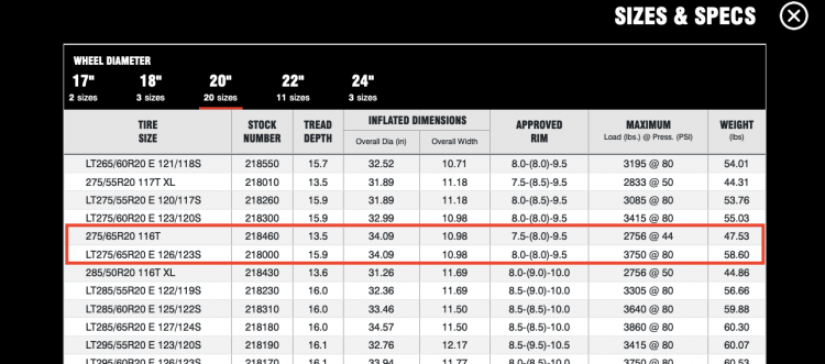

Lots of non LT in the stock size 275/60/20 (33" tall) its the 275/65/20 (34" tall) that no one makes in a non LT. Im happy with the ride of the bilsteins, better than stock for sure. I looked into both the eibach and bilsteins. they actually list the same way. They both have adjustable lower spring perch positions to set the ride height. The Eibach's do come with new springs but both the stock and the eibach springs are liner rate springs so to me it was hard to justify the extra costs. For the rear blocks I called a local suspension shop and they gave me a set of blocks from the previous gen truck, they had a pile of them laying around going to scrap. They are 1.2" cast iron. 5 mins in the sandblaster and some black paint and they looked liked new. OE Ubolts from 2018 truck fit perfect.
Sorry for the delay, Hard to tell if the ride is much different from the Tires or the Shocks. No Noticeable difference in MPG. I think the tire weight of the Non-LT tires help (11lbs per tire lighter then the LT's, unsprung mass is bad for MPG). Nitto is the only MGF the has a Non-LT tires in this size and the make both the standard and the LT in the same size so you have to be very specific on what you order. I got them from Discount Tire.
