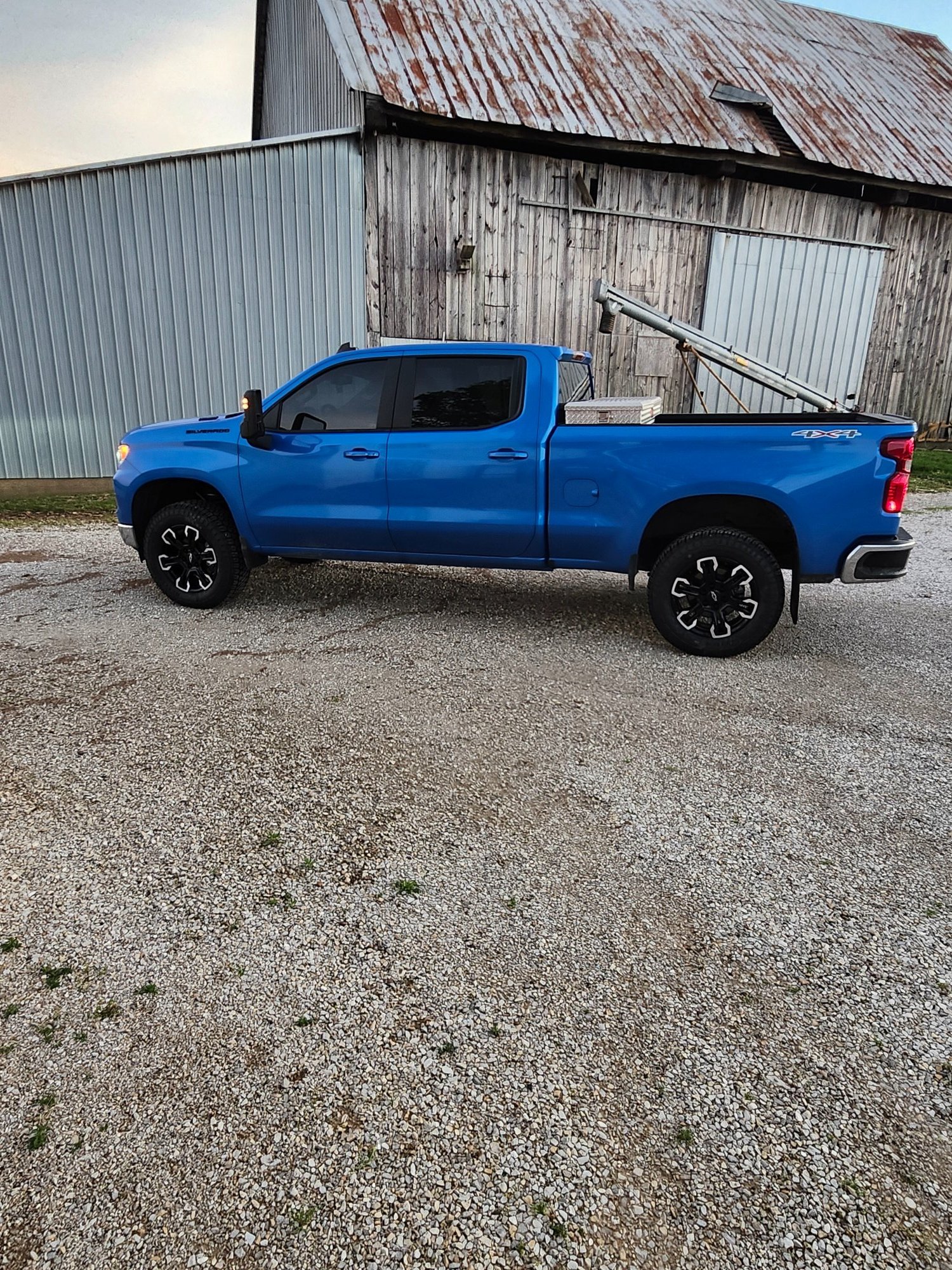

  1. 2025 Silverado LT 2.5" motofab spacer in front with suspension max UCAs. 1.5" suspension max rear block, also roadmaster active suspension which gave about another 1"-1.5" of lift. Peak suspension sway bar relocation brackets. 20x9 4Play OE Wheels cv65 +26mm offset. 285/65R20 Firestone Destination Xt tires. Only rubs on driver's side at the front of the wheel liner just before full lock. I think it's due to the alignment, the shop couldn't get the caster on that side as good as the passenger side.

  8. Truck looks great! The new wheels definitely look better. What do the front suspension angles (cv axles, balljoints) look like with the 3" superlift kit? That was one of the kits I've considered for my truck when I get around to doing it.
