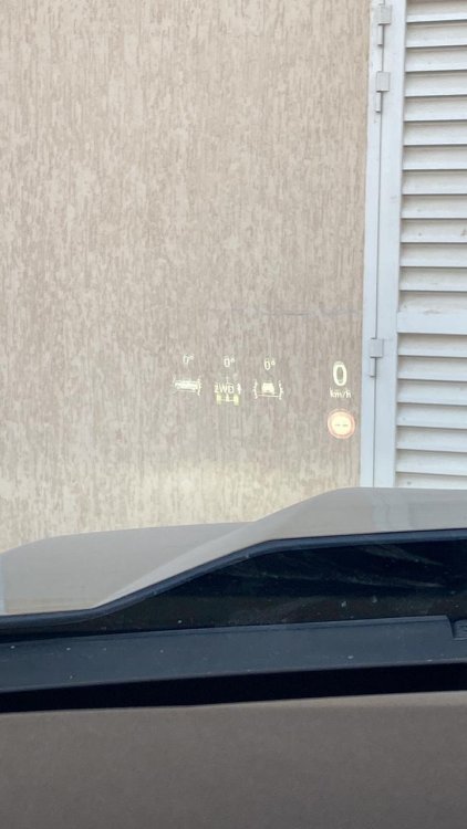

  1. thanks newdude Thanks for your time, information and help Everything is fine and the HUD project was successfully run 2021 Chevrolet Silverado 1500 thanks agn
  2. thanks newdude Thanks for your time, information and help Everything is fine and the HUD project was successfully run 2021 Chevrolet Silverado 1500 thanks agn

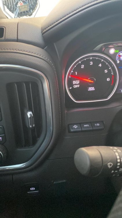

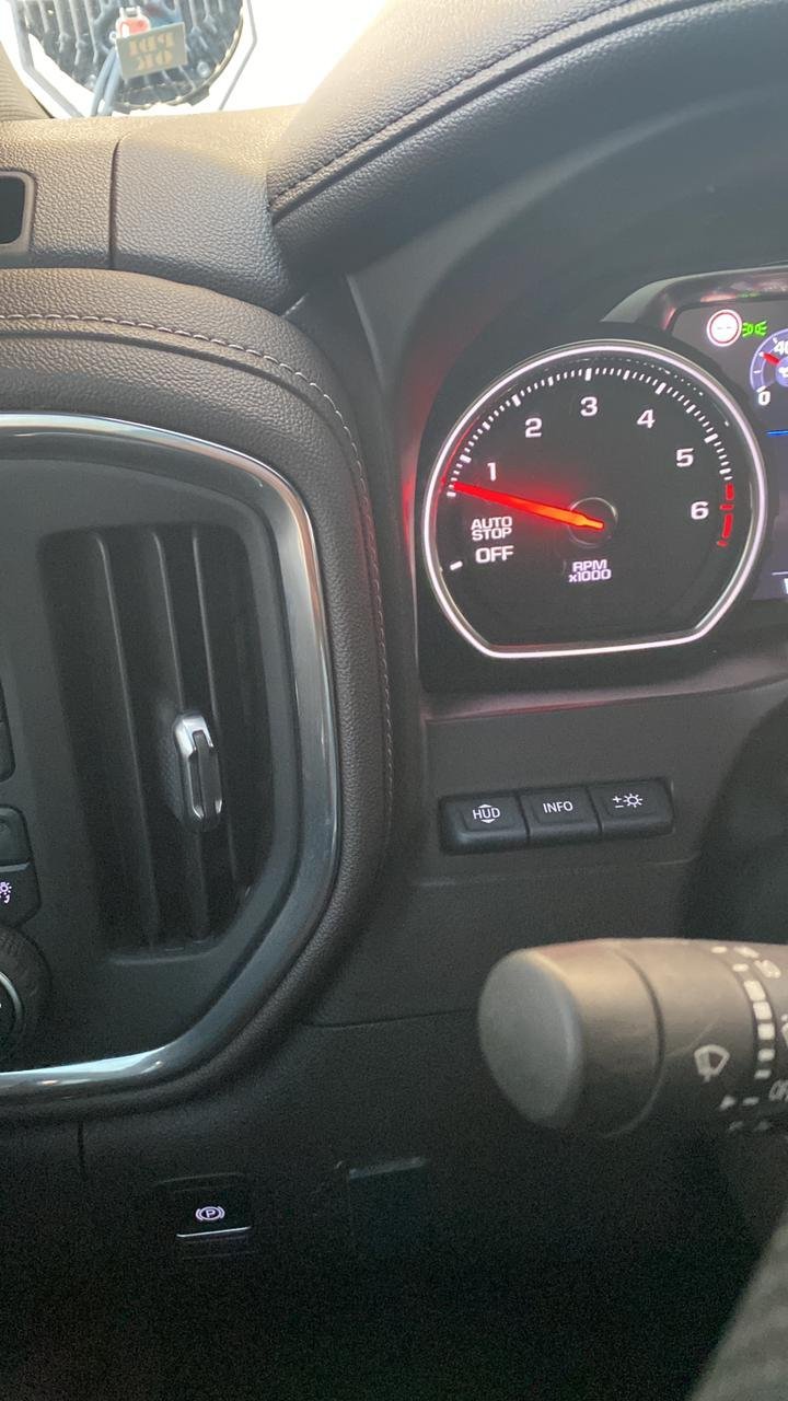

  5. Thank you I installed heads up display in 2021 Silverado 1500 but not working I just want to make sure that the correct wires are connected

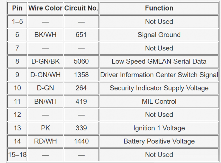

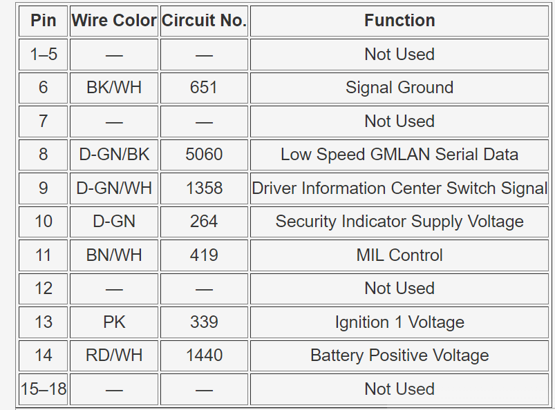

  6. Thank you I want to know the wires and their work Pin Wire Color Circuit No. Function in attach this for 2007 i want for 2020 thanks newdude

  8. I have a Silverado 2021 time to install the Heads up display feature I installed these parts Mount Bracket: 23407367 Driver Information Display Switch: 84456360 Instrument Cluster: 84804721 Instrument Panel: 84553050 Cluster Visitor: 84054788 Head-up Display: 84395830 Reinforced Beam Deflector: 23387335 Outlet Duct: 23391609 Windshield: 84398043 WAM VIN Programmed Phil's custom harness -2014 - 2018 Silverado / Sierra - HUD Retrofit Harness - Harness Dr. DIY Done Right but not working I have a question about Regarding the wire that goes to the Clusters the wire into the block connector Cluster PIN 21 Is the 2018 model the same for 2021 and about yellow wire to x51l fuse x2 - pin 3 LED Backlight Dimming Control red wire x51l fuse x2 - pin 35 Battery Postitive Voltage This is for the 2018 model What about the 2021 model May I know where I can install these wires? thanks
