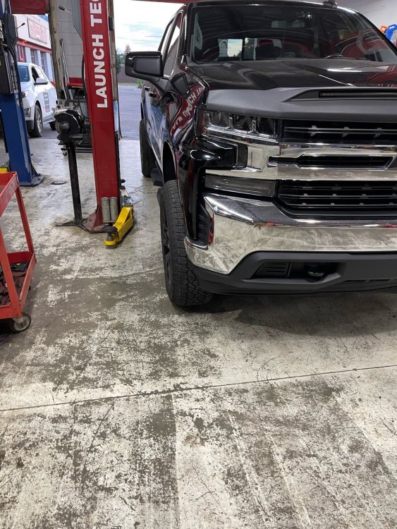

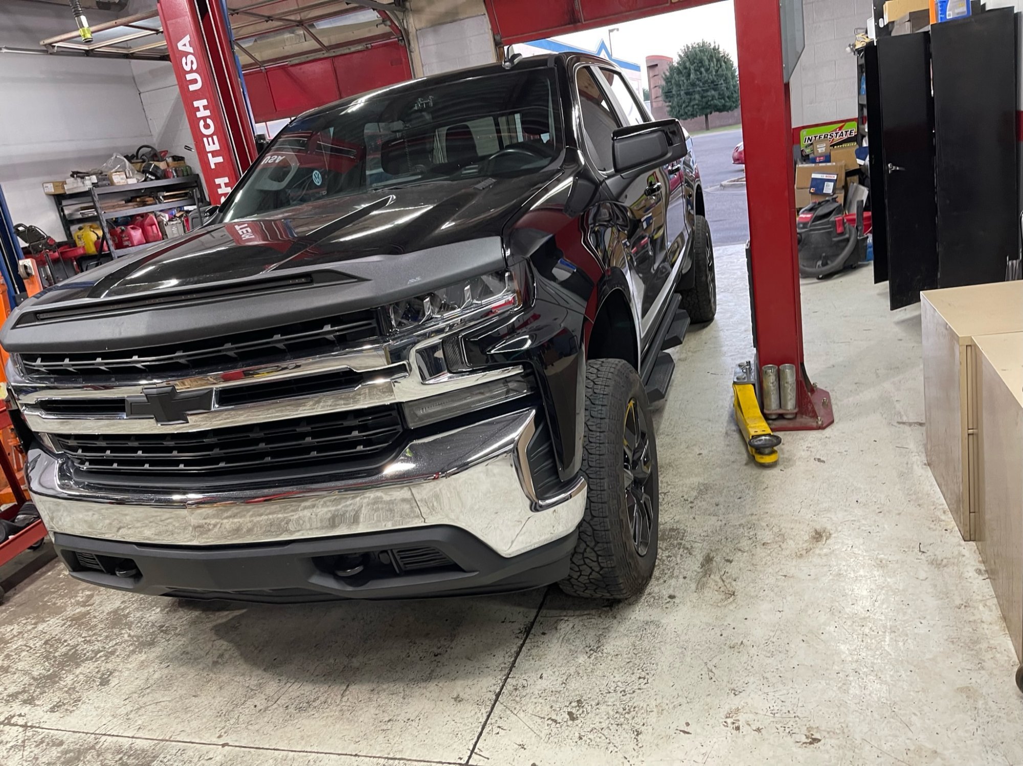

  1. Just did a full suspension install. 5100 on the front set to 2" 1" Motofab spacers under the 5100s for total 3" front lift. Motofab UCAs 5160 in the back with Motofab extensions Motofab 2" blocks on the back Firestone Rite Ride airbags were already installed on there. Might need spacers for them 2" Bora wheel spacers all around for a little wider track. As it sits right now there's about 3/8" -1/2" rake still but I'm ok with it. I could still raise the 5100 one more notch to bring them up another 1/2" to make it 100% level, or take out the front motofab spacers and raise the 5100 the other 1/2" to be back where I'm at right now. Probably won't touch them though. Ride is spot on now, but the real test comes in a couple of weeks when we take the 30' camper out. Main reason for all the work was to hopefully smooth out the front bouncing on the concrete highways around here when we tow. I have the weight distribution hitch spot on to spread the load 50%-50% . The Airbags in the back helped a TON with that, but the front was a complete ****** show. On some stretches it's so bad we stopped camping on the west side of the state to avoid those highways.
