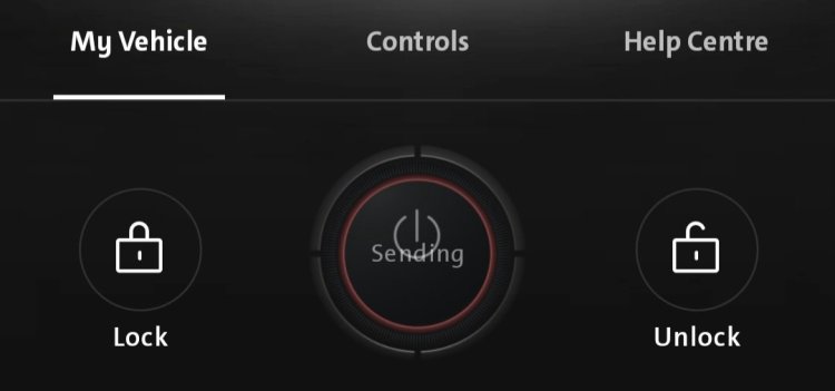

  8. Thank you. I used the chat option for GMC support on the app and an agent said to sign out/force stop the app on phone,, uninstall, reinstall. Problem now cleared. Haven't tried to start it yet though.
  9. 2023 GMC Sierra Pro 2.7 I tried starting the truck with the MyGMC app this morning (has worked many times before) but it did not work and for hours now the button to start is stuck on "Sending" and is grayed out and you can't do anything. Have restarted app and phone and truck was started and stopped manually but the app remains the same. Anyone have this problem? Will the app eventually free itself?
