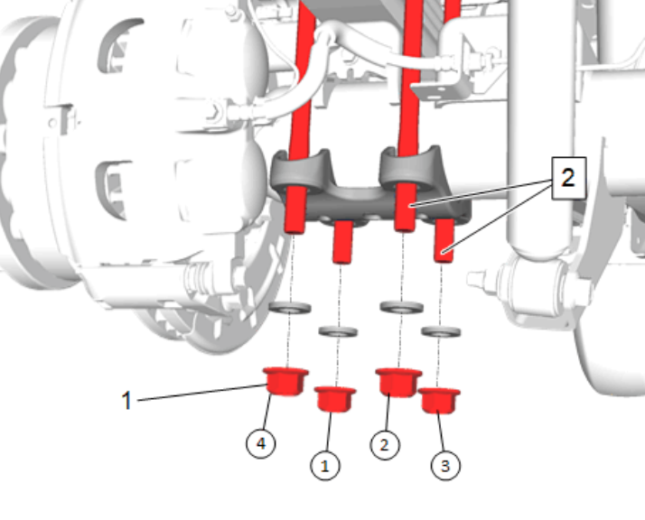

  1. Just as a point of clarification since it may not jump out, there is a sequence in addition to the stepped torque procedure, see the numbers on the nuts: Each of the steps would be done to the four nuts in the numeric order above before moving onto the next step.
  2. I think it's the unfixed lower plate that creates an issue with a straight torque value, unlike most standard fastener torque ratings. These don't appear to be torque to yield. I try to always use a tell-tale like a paint pen to watch for loosening fasteners. Install and torque then mark across the bolt/nut/surface. I use these: https://www.amazon.com/dp/B09D9M2R5R?ref_=ppx_hzsearch_conn_dt_b_fed_asin_title_5&th=1
  3. This isn't ZR2 specific, it is the only value listed for the 24 2500HD.
  4. Rear ubolt sequence and values from Alldata:

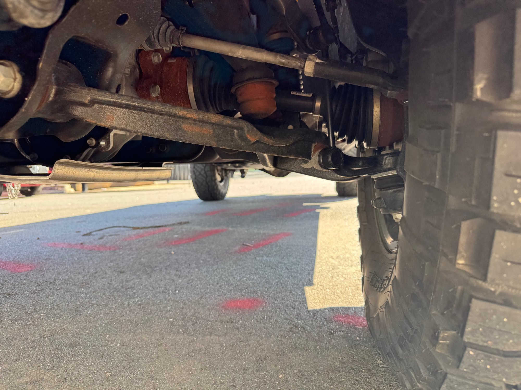

  8. Is the front LCA insertion location moved, maybe?
  9. Let me know what you hear.
  10. To be fair, I chatted them, but I waited 15 minutes to be connected so I assumed it was one of the cognito guys. Only thing I can think is that a different location in the LCAs require a different length that would even matter.
