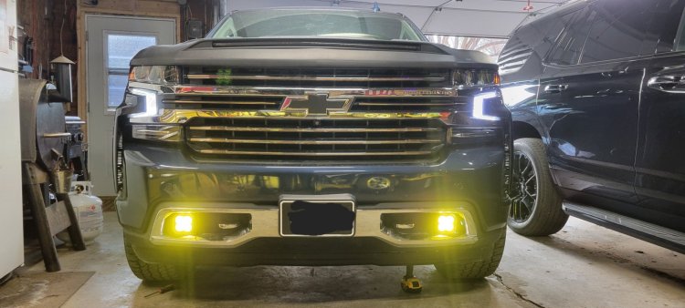

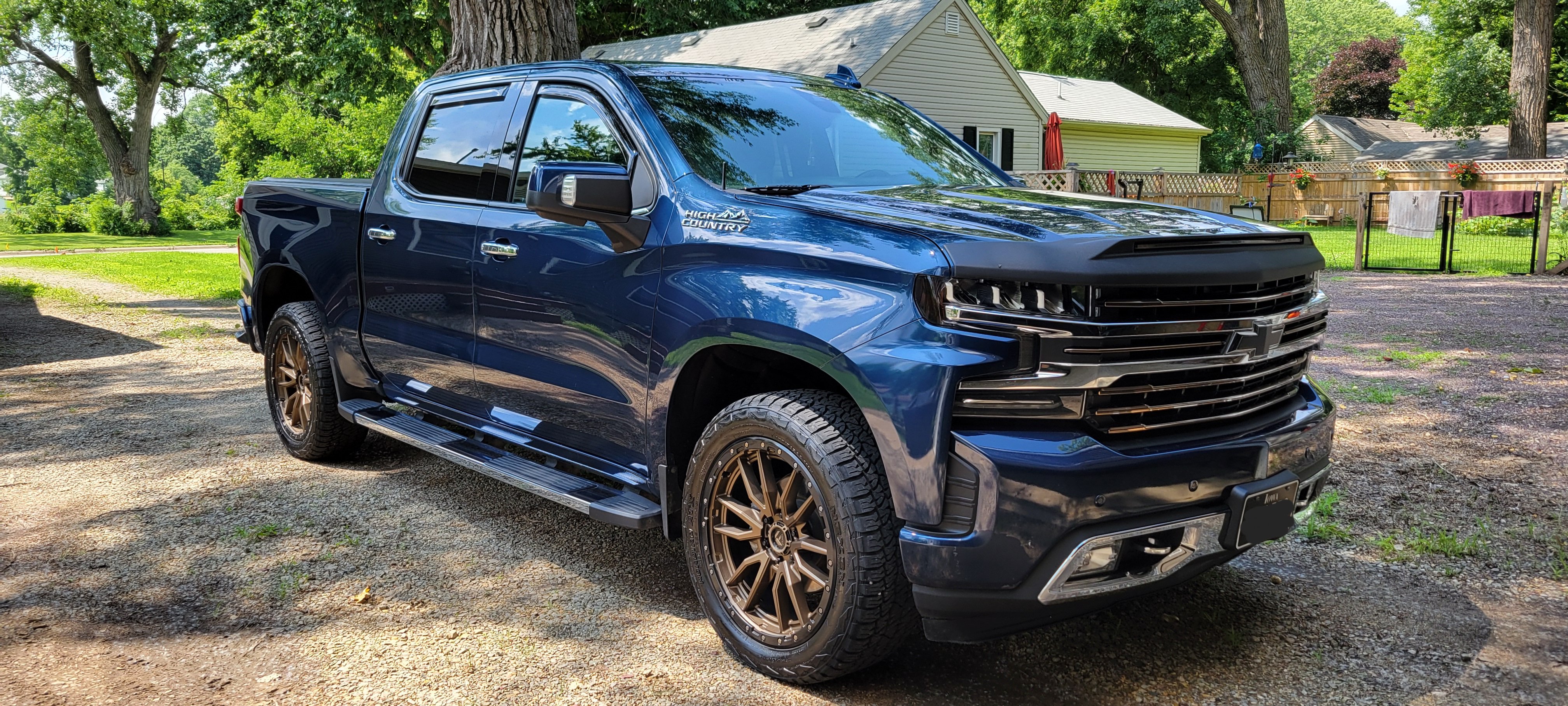

  3. 2019 chevy 1500 high country and my 2022 chevy tahoe high country. 2019 chevy 1500 5.3L has been blacked out, 22" fuel wheels, diode dynamics fog lights and avs lighted bug deflector. 2022 Tahoe 6.2L has been blacked out, tinted tail light
