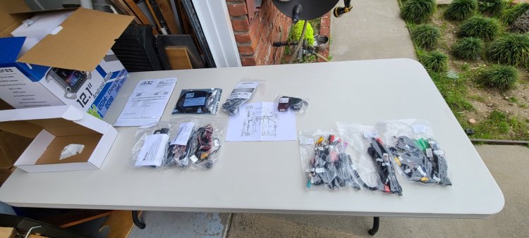

Most of my day today was spent either running around for do-dads or waiting on replies to my questions to ADC Mobile. I did get the XM in no sweat, 2 connections. But the cameras were somewhat of a stumbling block for me. Replacing the rear backup OEM cam with a higher def cam was simply plug and play after opening the tailgate up and R&R the camera. I did have to drop the spare tire down a bit to get to some of the harness retaining clips. The front and right side mirror cams were not detailed in any written or video guidance. There are a handful of loose pigtails that have no connectors and the labling leaves some doubt as to what goes where. Additionally, there's some toggling of settings behind the factory settings menu that need to be made and are code protected. These settings are not published nor did I find videos covering them. Walt briefed me in a very short, concise email. It worked as advertised. Once I had the affirmation of the wiring connections from Walt, I ran around town until I found some single conductor Molex style connectors which made the wiring cleaner. Walt has been great. Couldn't have done without him. Wish Linkswell was a lot more detailed on their instructions for the optional equipment. I mocked up the cams and tested the right turn indicator actuation of the right mirror cam and tested the front cam as well. Tomorrow I should be able to route the wires for those cameras -

Got the gen5 yesterday. Started installing today. Got the basic wiring done today and fired it up. All ok. Tomorrow, I'll wire the xm and cameras.
