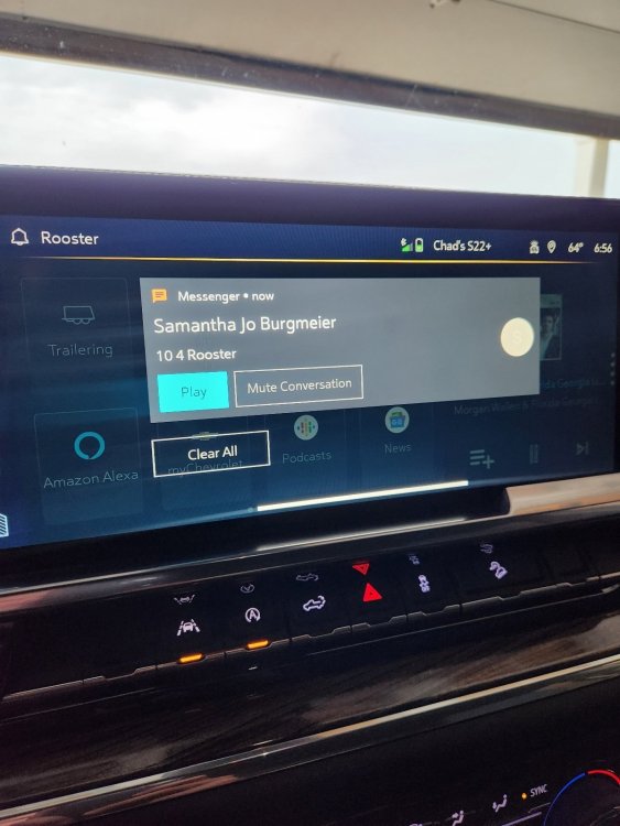

  6. Do you maybe need to download it from the play store? Also, do you connect your truck to your home wifi for updates? Might want to look to see if you have a system update to install.
  7. Settings - Apps - Show all Apps - Show System - click on Amazon Alexa and then Enable.
  8. Looks like playing text is now working. I believe that alexa may have been the culprit. I disabled alexa so Google assistant is now the default. This caused a notification access screen to show up where I selected Google assistant to be active. After that it seems to be working. I told the dealership as well and they were glad to hear.
  9. Thanks @dieselfan1. I feel like I'm making progress slowly on this, but the feature is still not working. I disabled alexa so Google assistant is now the default. This caused a notification access screen to show up where I selected Google assistant to be active. However when looking at the Bluetooth connection, audio is unselected. I have tried to select it but it keeps automatically unselecting. Maybe this is my issue?
  10. @dieselfan1 What truck do you have that it works? 23 ltz high country in your profile? Also what is your default assistant? I changed mine to alexa and I'm guessing that might be why it isn't working. But I can't figure out how to change it back. The dealership is telling that it is normal not to play the message. Trying to gather some proof so they will take a look at it. Thanks.
  11. There are two things that might help that I can't figure out. 1. I changed the default assistant to alexa when I set that up. I can hear text messages through android auto so I'm hoping to change the default assistant back to Google. Anyone know how to do that? I can't find the setting. 2. I might have to set up a trusted device. I have went into the mychevrolet app, but I can't find anything about trusted device.
  12. Thank you, that is what I assumed. Is there a button on the steering wheel I need to press for it to play? Or wouldn't pressing play on the screen work as well?
  13. Ha, nailed it. It was my son's idea to name the truck rooster after top gun.
  14. New 23 Silverado for me and trying to understand if this is an issue or a crappy feature. Infotainment displays I have a text, however when I press play, nothing happens. I assume it would play the text over the radio. If it doesn't, why even show this message. Talking to the dealership too, but looking for additional perspectives. Thanks.
