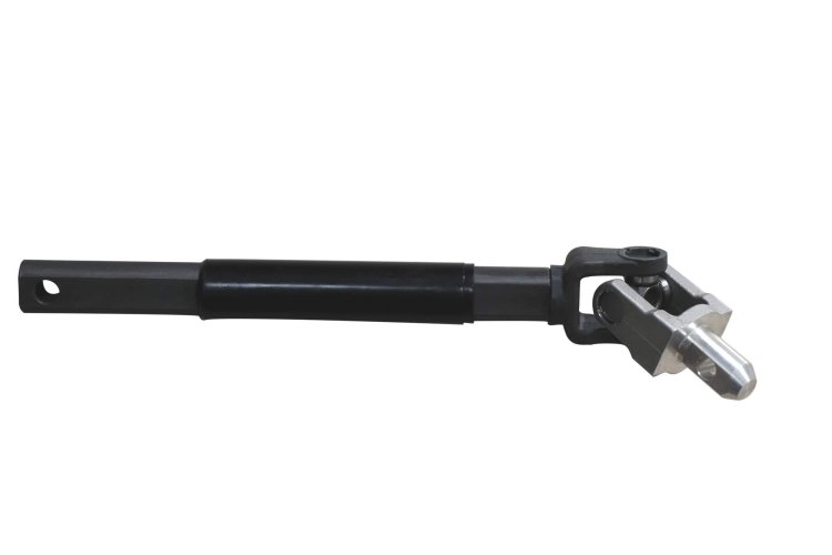

  5. I'm holding the steering wheel 5 degrees to the right to keep the truck traveling straight - more-so if the road crowns off to the left (i.e. left lane of the highway). If I take my hands off the wheel the wheel naturally returns mostly center but the truck veers to the left. I agree with an alignment issue, I'm just unsure of how it would've changed. The intermediate shaft is squared on both ends (a female and a male). I don't see how this would've caused any change as there's really only one way to install it. I suppose I'll have my shop take a look, just figured I'd see if anyone on here had some wise insight.
  6. Over the past year, I’ve noticed my steering wheel is pointed 5 degrees or so to the right when traveling straight down the road. It was spot on prior, as I had my shop ensure it was true when installing a new set of tires and aligning (2+ years ago now). The only thing that’s been done in the meantime is I’ve installed a new intermediate steering shaft trying to solve a clicking noise. However, I secured the steering wheel when doing so, and there’s really only one orientation for the shaft to install; can’t see how this would’ve caused the offset. Any steering gurus out there? Do I have a bad tie rod end? 2015 Sierra with 95k miles. Also noticing some prominent random vibration on the highway. I had my tires re-mounted and balanced last fall, thinking that may be a cause. Also noticing a low end whine coming from the steering column at low speed when cranking the steering wheel, such as backing into a parking spot.

  9. I finally found the fix - the noise was coming from the steering position sensor. The plastic housing is somewhat loose, so I put a little duct tape around it. I also rolled up some tape and wedged it between the housing and sensor. The noise is completely gone. Hopefully this helps someone with a similar issue. It’s been driving me crazy for a while now.

  12. I've been trying to troubleshoot this issue as little noises are a huge annoyance to me. My steering wheel clicks when slightly moving the steering wheel back and forth. As you're driving down the road and making tiny adjustments to the steering wheel, its just click, click, click non-stop. I thought it was coming from the intermediate steering shaft knuckle, so I replaced it. Then I thought maybe it was the actual steering shaft boot, replaced that, but no fix. Has anyone had this same issue and/or found a solution?
