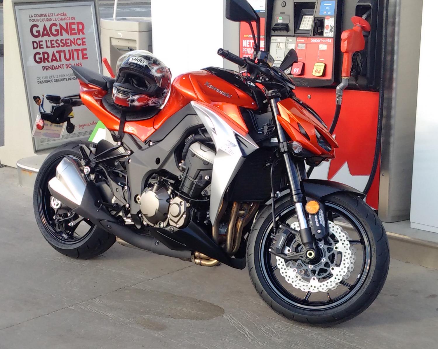

  13. Oups I forgot to include a pic lol
  14. Nothing on my truck but just bought this awsome brand new monster
