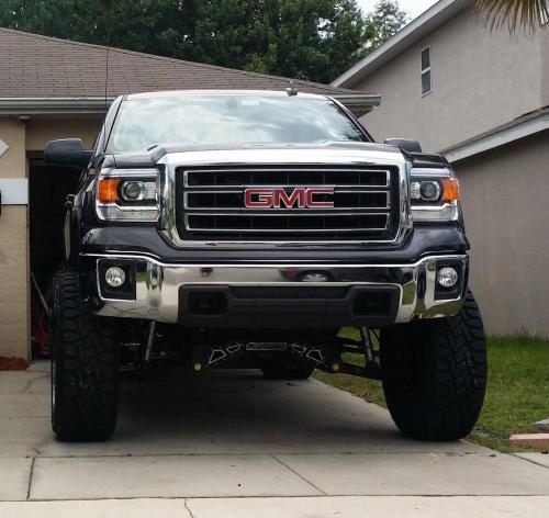

  8. Lift is set at 9inches 22x12 fuel rims 37x12.5r22 too R/T tires
  9. 7-9 McGaughys set at 9 22x12 Fuel with 37x12.5r22 Toyo R/T

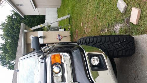

  10. 22x12, 2 piece FUEL Nuts, -44 offset 37x12.5r22 TOYO R/T's
  11. The rims are 22x12 with -44 offset and the tires sick out about 4 inches. I will add some more pictures this weekend.
