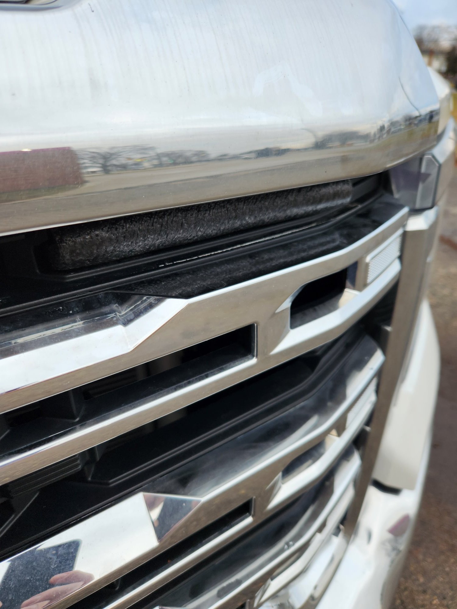

  1. Pipe foam inserted where I taped is my latest solution.

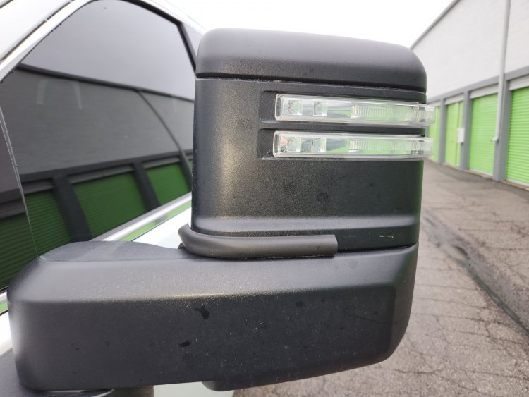

  2. The mirrors and front grill are two areas I've pinpointed. I've used duct tape and weather stripping to address both.
  3. I have this issue with tow mirror driver's side 2021 GMC 2500. Been trying to tape off areas to pinpoint but seems to be something internal catching the wind and whistling.
  4. 2021 GMC2500 SLE current issues: 1) Whistling noise from front edge of hood over 50+ mph. Very annoying. I had the tech link for 2020 and still whistles (20-NA-035). If I put painter's tape along entire front edge of hood and over the weather seal strip I can stop it, but obviously I don't want tape on there and can't open the hood without removing tape. Has anyone had this issue and found a solution. Only option is leaving at dealer for them to try things but I have a feeling they won't get anywhere. 2) Whistling noise from driver's side tow mirror that goes away when I fold them in. 3) Squeaking from rear leaf springs, there is a tech bulletin (21-NA-138). Just have to get into dealer for them to confirm and order parts. Anyone had success with this tech bulletin? Otherwise I like the truck. Thank you in advance for any help.
  5. JMac72 let me know what they figure out please, I'd like a cleaner solution other than blue tape. Ironically when I tried using clear smooth 3m tape in place of blue paint tape, the whistle came back. From what I hear, GM moving onto the next model year and most likely no other updates will come out for 21 model.
  6. Josh, taping off the front edge of hood over the rubber seal on the front edge of hood seems to stop it. I'm still trying to find a clean way to make that permanent. MTU alum said the problem is somewhere near that fake intake on hood. I'm thinking where I'm taping is disrupting air flow enough to reduce whistle noise. I'll try and get some pictures on here.
  7. Update. Replacement parts were exact same parts that were on there and did not fix whistle noise. Dealer said they would contact GM again. Disappointed.
  8. Update: Dealer ordering parts for 2020 fix as that is what tech support advised them to try. Waiting on parts currently. I did put blue painters tape over along the front edge of hood and whistling stopped, so I believe that is most likely the problem. I just hope GMs replacement weather strip replacement kit resolves it as well as the painter's tape.
