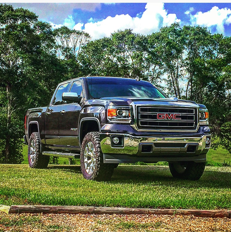

  2. For anyone who was wondering about tire fitment with a 4" lift, here are a few pictures of my truck. I ended up going with a 4" Fabtech and 295/60R20 Nitto Trail Grapplers with stock wheels. Rides great and only slightly rubs the plastic wheel well and full lock. Hopes this helps anyone who was curious.
