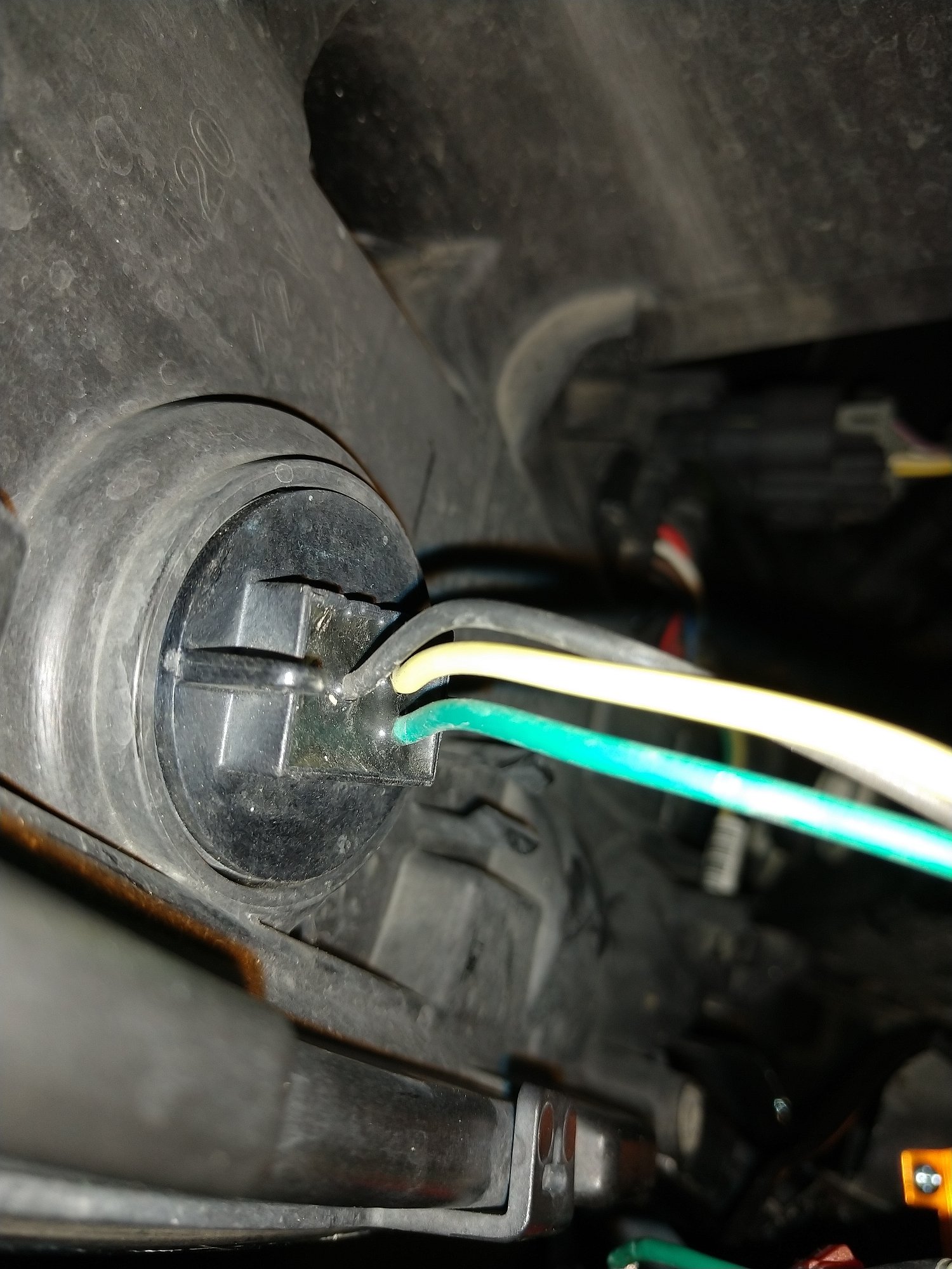

SOLVED. So the front turn signals are a bit different than the wiring on the taillights. There is green, black, and yellow. I originally copied what I did to the taillights (tapped into the black and green wires) but I ended up changing the fronts from the green and black to yellow and black and now they are working. The resistors were getting hot so I know that it was the right one. Wondering why the taillights worked differently unless its because they also have to function as the brake and then that would explain it when its brighter. Very happy with the light output, definitely a huge difference.
I have the resistors installed and they are still hyperflashing. I have them connected to the green and black wires on the front turn signals. The rear LEDs work fine with them. I need help figuring out the fronts. There is nothing available online or anywhere that I can find that confirms how they should go on the front turn signals.
2015 GMC Sierra 1500 SLT. Yes I have the DRL bars on mine. I called TRS and they are saying adding resistors to the leds with built in canbus can also be a reason they are still hyperflashing... so they recommended a different bulb. Since the rears work, I guess I'll just swap out the fronts for the non-canbus ones and keep my fingers crossed?
I put all LEDs in my front turn signals and taillights. I had to use resistors even though the bulbs were canbus. I got all the taillights working properly, and I did the same wiring setup on the front turn signals, but they still end up hyper flashing and my information center shows the front turn signals have failed. Can someone confirm how resistors should go for the front turn signals?
I got 6 resistors from TRS. I got the tails installed and they work fine. I did the exact same setup using the same color wires for the front turns but they still hyperflash and throw an error in my DIC. Is there something I am missing for the front ones? The rears I used the two outside wires (black and green) to tap into. The fronts the wiring configuration is slightly different but I used the same black/green combination. The 3rd wire was off white in color.
So TRS sent me load resistors to be installed with the bulbs. All the youtube videos I find consist of the person saudering the wires together instead of using the T-Taps. From what I gather, its the outer 2 wires leading to the bulb that you want to deal with, but as far as how the resistors actually connect into them with the T-Taps, I can't seem to find anything that shows how they need to be installed. The kit comes with Red and Blue colored T-Taps, is there a difference between them? I couldn't find anything on youtube or even this site with a search.
