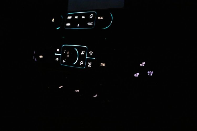

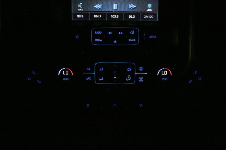

hey Phil which "blue" of mine are you referring too?? control buttons? overhead lights? footwell lights? here's a better image of the hvac/radio controls (bahahahaha... let me rephrase that ... better if the original pics in photobucket showed up) the blue gel i used is a little darker than the stock chevy blue, but honestly, it doesn't bother me at all. i lightened this pic a bit to bring up the contrast between the stock and added blue let me know if you want more/specific pics and i'll get them this evening once the sun goes down

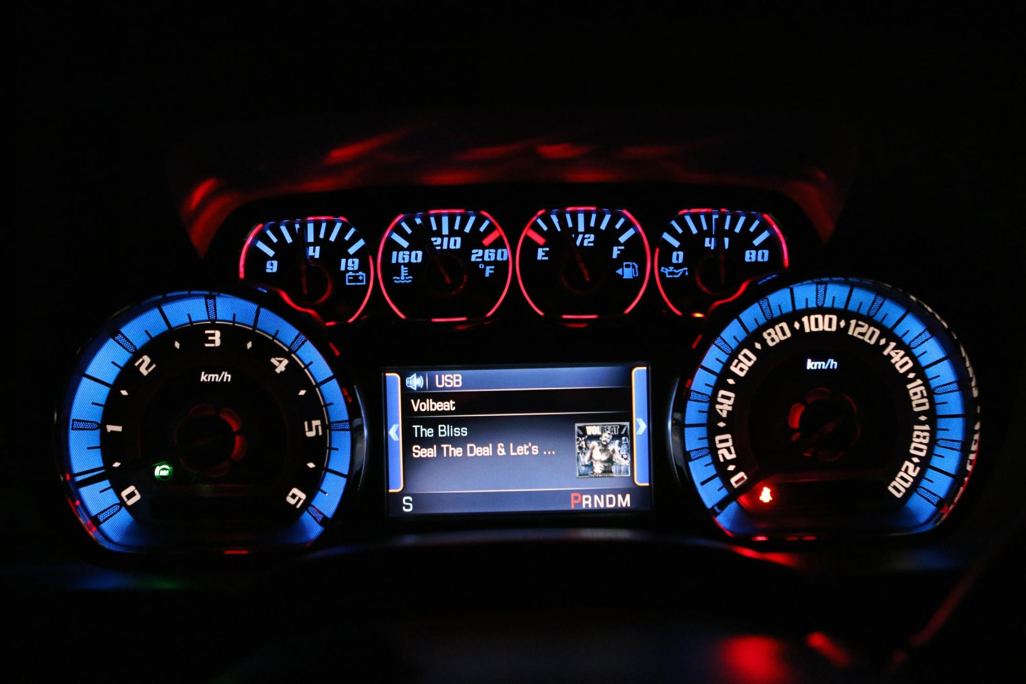

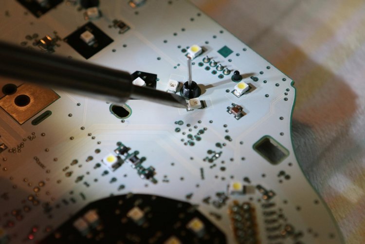

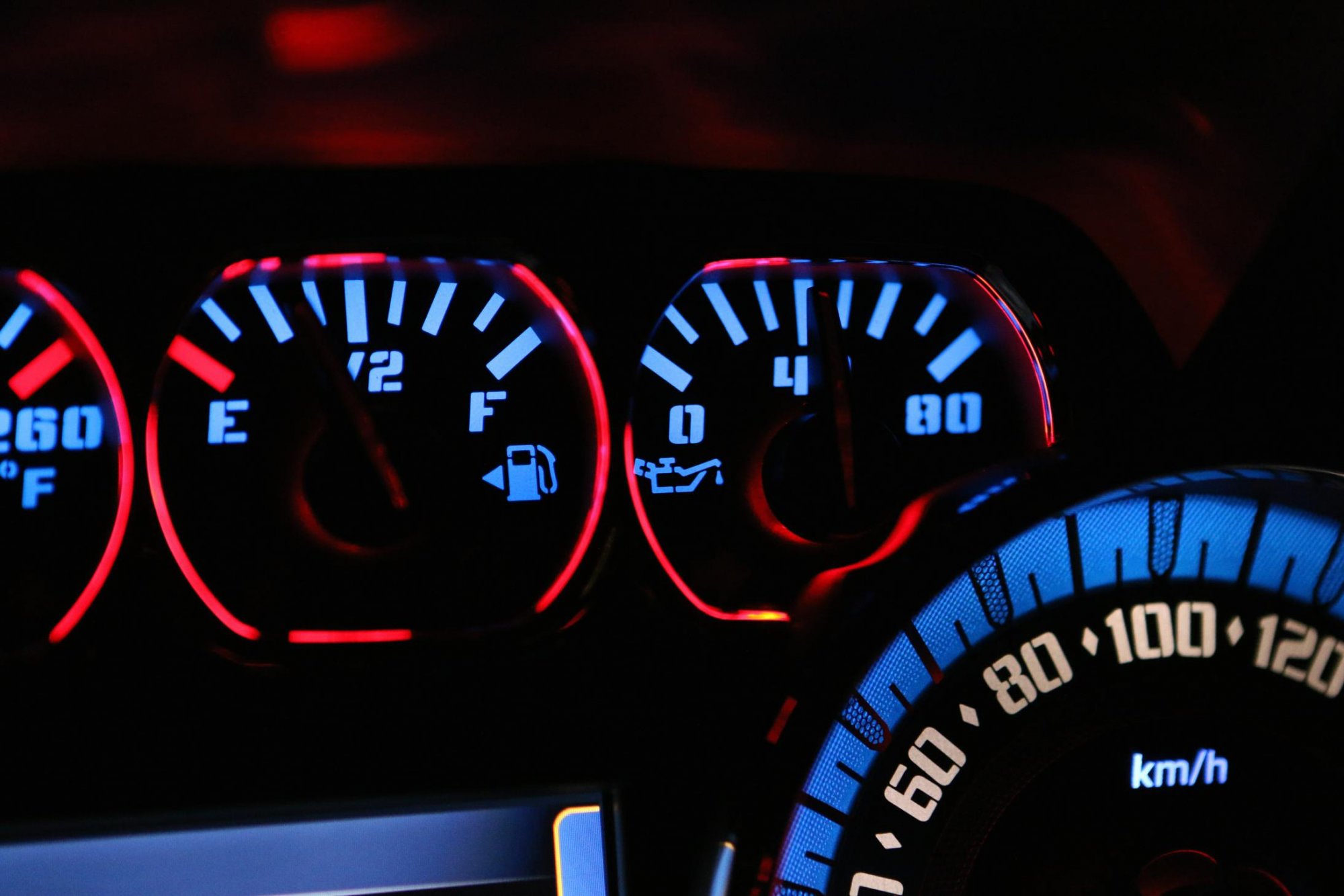

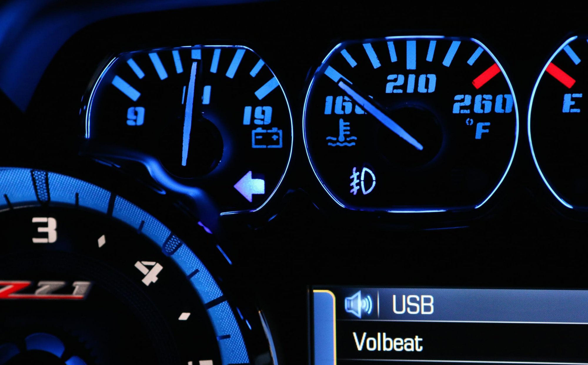

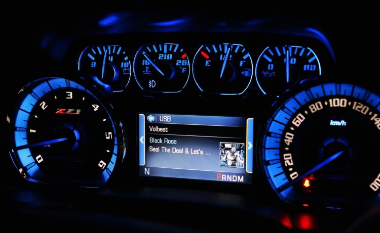

hey lapoolboy why don't you just change out the surface mount LEDs on your dash cluster - it's not hard. i did that on mine and the results were fantastic.... and i had zero soldering experience before attempting this (i actually had to go buy a soldering iron/gun! ha!) here is my stock dash... added an inlay from usspeedo.com..... pulled the dash cluster and changed surface mount LEDs to blue... and the final product.... i absolutely love the dash - i think it looks really good the surface mount LEDs were from oznium.com.... https://www.oznium.com/plcc-2 **order some extra... i'm glad i did (like i said earlier... i had never done anything like this before but i got the hang of it pretty quick!) -

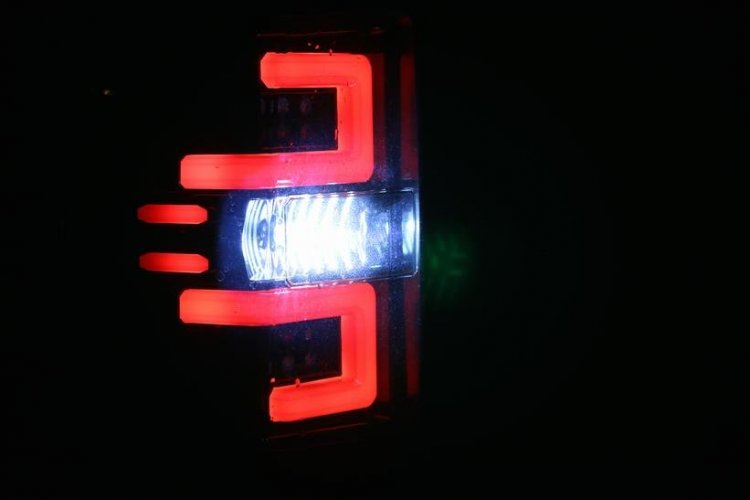

@jrob56 i'm not sure of the link for the spider tail lights in gruve's post, but i have a very similar tail light from recon - very happy with it https://www.gorecon.com/product/670/264238BK-SMOKED-LED-Tail-Lights-14-17-Chevy-Silverado-15-17-GMC-Sierra-Dually -

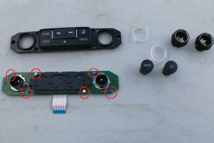

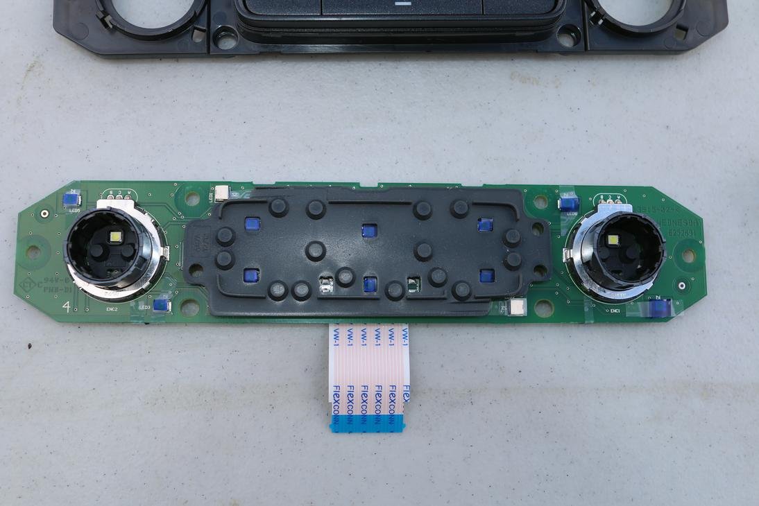

i'm pretty sure the LEDs are already blue or red... below i've added circles to the LEDs that i think are the lights that give the illumination you're talking about. the light 'travels' thru an opaque plastic - you can see some of these plastic 'rings' that are from the menu and power/volume knobs in the second pic. if you can change these LEDs it would likely do the change you want. sorry i'm kinda vague on this - i did all this last summer (so over a year ago now) and it's just tough to remember -

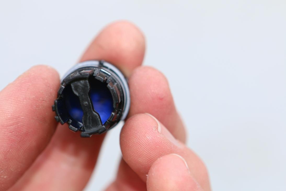

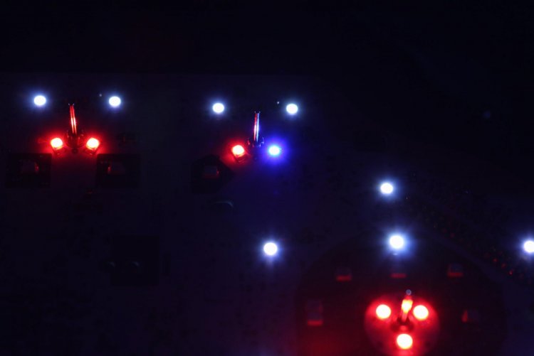

ok - those are 'easy' to change... i covered the white LEDs with blue lighting 'gels' i "blued" out all of the white LEDs. eventually i'd like to replace all the white LEDs with blue LEDS, but for now, the blue gels are doing a great job.... the final 3 pics show a before/after of the entertainment controls with the LEDs covered in the blue gel (filament) - but it's the same idea with the hvac controls. i found it was easier with the knobs to put the gel inside the knob as opposed to covering the LED - i just use double sided clear tape to hold the gel in place -

wouldn't you just have to change the surface mount LEDs on the dash? it's soooooo simple. i did it to my 14 (red to blue) and it looks so much better. my experience doing this kind of thing can best be summed up with this statement... i had to go buy a soldering gun to do this... never done anything like it before. i got my LEDs from oznium.com first 2 pics are stock chevy dash, with dash overlays added from http://www.newtruckstuff.com/US-SPEEDO-CUSTOM-TIMELESS-EDITION-STAINLESS-STEEL-GAGUE-FACE-SPEEDOMETER-KIT-BLUE/productinfo/TMGM31B/# 3rd pic = removing the first red LED from dash 4th pic = testing the first blue LED 5th & 6th pic = blue LEDs installed -
