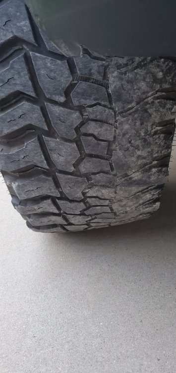

  2. I've taken it back to the shop every time I've noticed the popping noise. This photo was taken 9/25/21. Only 1 month prior to my previous pics. No beavers in my area.
  3. What should I have done, take it back to the shop? I did. They torqued the nuts at install, retorqued at 1k. I took it back to the shop at 6k because there was a problem and they retorqued again. Now at 16k the nuts are loose again? BDS claims, if the install was done correctly, the UCA nuts would not have backed off repeatedly. I have to agree.
  4. I have no visibility over their garage area.
  5. I have the initial estimate and final invoice. There is no statement of warranty in either.
  6. Hey guys, I'm needing a sanity check on an issue. In February 2021, a local, authorized BDS dealer installed a BDS 2.5" lift with BDS upper control arms and Fox coilovers (with DSC) on my 2020 Trail Boss. With this lift, they also put on Moto Metal Kraken 20x9 +0 with Mickey Thompson Baja Boss MT 35x12.50 R20. Eight months later (16k miles on lift) my front tires are shot. I'm very religious about tire rotation (every 5k-6k miles with dealer receipts as proof). The odd part is, there was no abnormal tire wear at first. It was only the last 3k-5k miles that my truck began feeling "different". I was hearing a random "pop" in the front end and upon closer inspection noticed an obvious positive camber. This is when I saw the tire wear. The installer's inspection revealed that both UCAs had loose nuts (one was actually missing)! They have fixed the suspension, but are insisting that I'm responsible for the cost of new tires. Below is the timeline for this project: Feb 2021 (< 10k miles on the truck) Installation of lift, tires, wheels, intake, exhaust, etc. Over $11k invested March 2021 (1k miles after install) installer retorqued everything. May 2021 (5k miles after initial retorque) another retorque and re-alignment. My steering wheel was off-center and the front end was "popping". October 2021 (10k miles after last retorque, total of 16k miles on lift and tires) front end popping, positive camber and tire wear. I'm intentionally not naming the shop until I get some feedback. But, they are insisting that they aren't at fault, saying "these things just happen". It seems obvious to me, but am I missing something? Shouldn't they be responsible for the cost of new front tires? Any feedback is greatly appreciated.

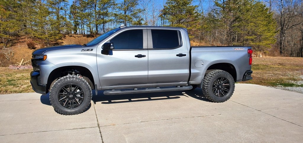

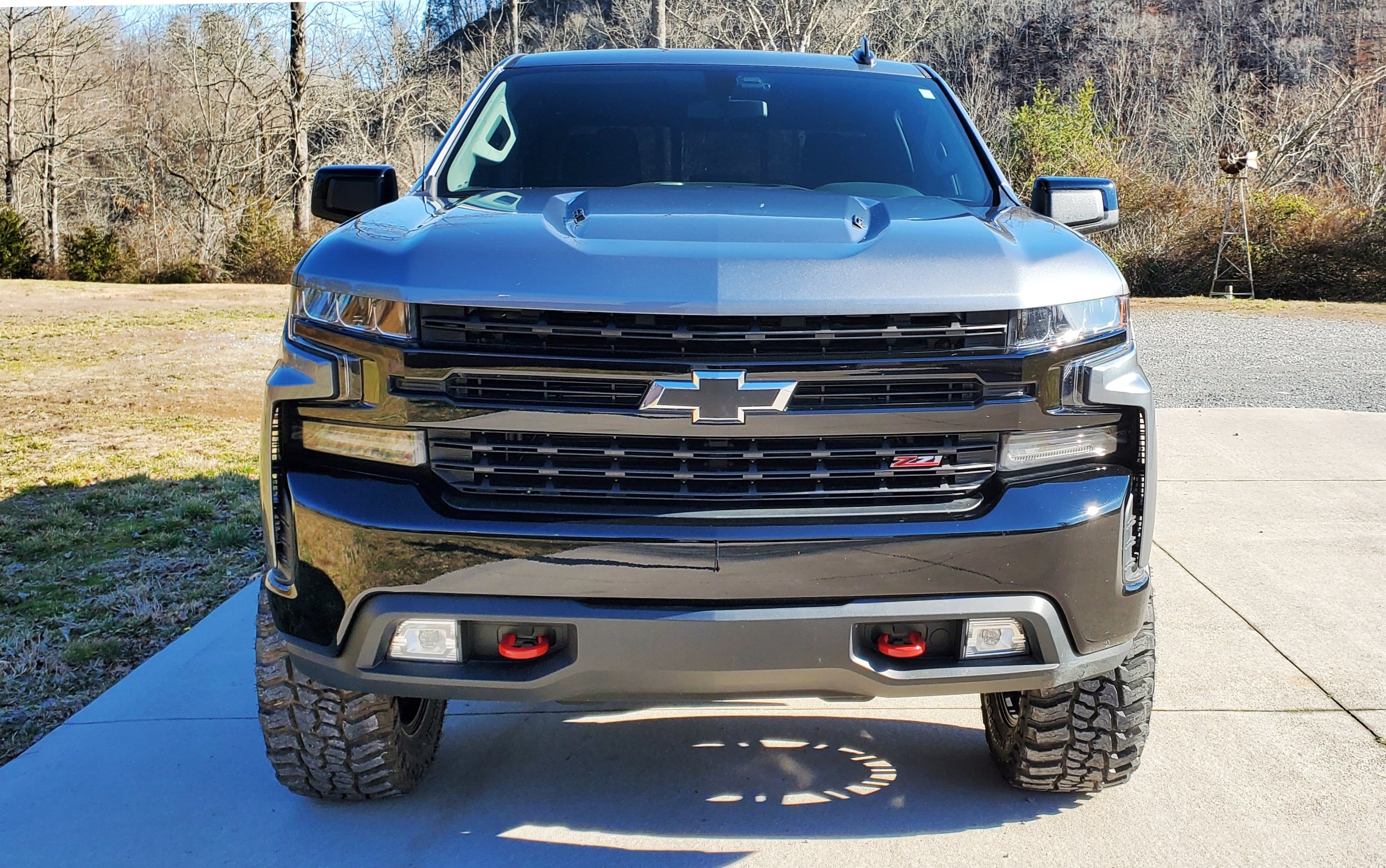

  7. 2020 Trail Boss LT. 35x12.50/20 Mickey Thompson Baja Boss on 20x9 Moto Metal Kraken - 0 offset. BDS 2.5" lift (on top of stock 2" lift) with Fox DSC coil overs. Very slight rub inside front fender well under compression at full lock. Pulled fender brace forward with zip ties about 3/4". Absolutely no rubbing now. Rides like a dream.
  8. I actually had to make fewer modifications. The bumper does not have to be modified, only the bumper mounts on the truck. The only real difference was, I needed to notch the frame (where the e-brake cable passes through) more than the instructions state.

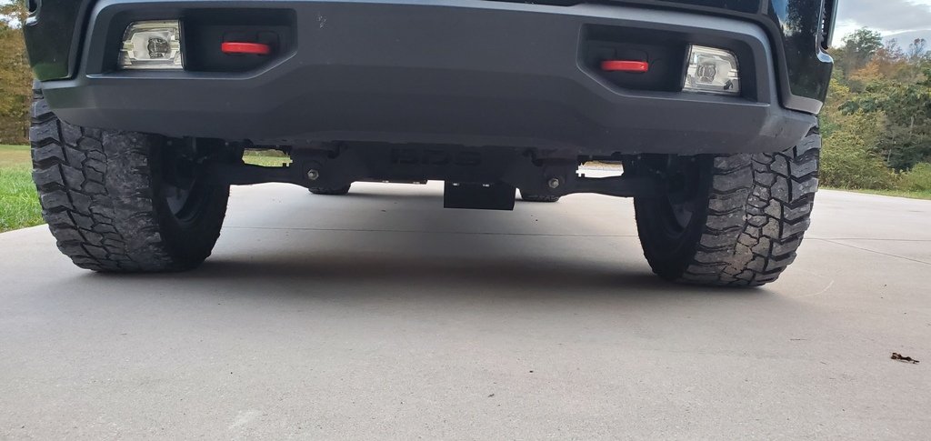

  15. Pics of the hitch after Zone 1.5" body lift
  16. Rough Country steps Rear of wheel well to middle of front step ~23" Wheel well to rear step ~65"
  17. It didn't rub with 2" level.

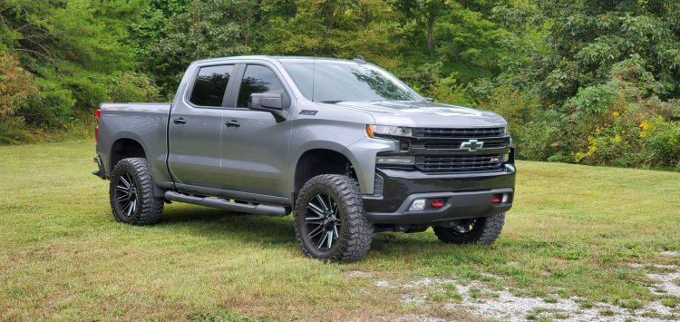

  18. Thanks. No trimming needed with this set-up. My only complaint has been the drop in mileage due to the weight of the tires. I still get 16/18 mpg and I would definitely do it again. Here's a pic with the added body lift. A close up of the Wheel/Tire combo
  19. The body lift is to get a little extra height without affecting suspension angles or ride quality. The exhaust pipe now exits 1.5" lower (notice the gap between it and the body). It bugs me, so I'll have my muffler shop change the angle so that it sits close to the body again.
