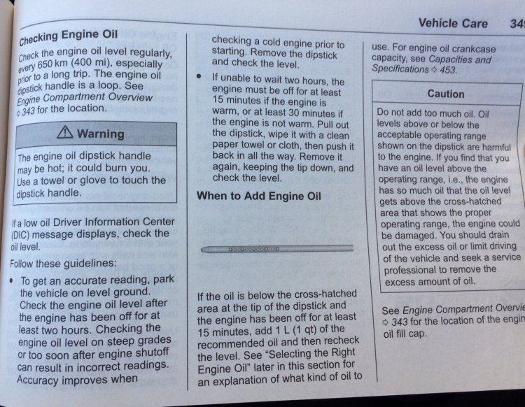

  5. My guess is putting 8qts in with the stuff left in the system was causing a lifter or something issue. I took a qt out and the noise went away. I hate how the dipstick reads. After sitting over night, the hatch mark side, inserted facing the firewall, showed plenty over top hatch. I took out a qt and its still over hatch and the opposite side of the stick reads at below the dot by tip. Say what? I think this stick reads weird.
  6. Nope. this freaking dipstick. It’s reading above hatch mark now and below the dot by the tip on the other side. That’s a huge difference. And was after I took 16+oz out, basically a little over a quart. I gotta imagine there’s quite a bit left in there even after draining for 30 to 45 minutes, becuase the new oil is dark when I drained that amount. So I have 7quarts new in there, plus whatever was left in the system from the drain, puts it over hatch and under tip dot. Freaking baffling dipstick and changing oil is not something new to me.
  7. Oil is at the 2nd dot away from the tip.
