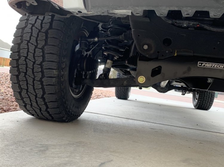

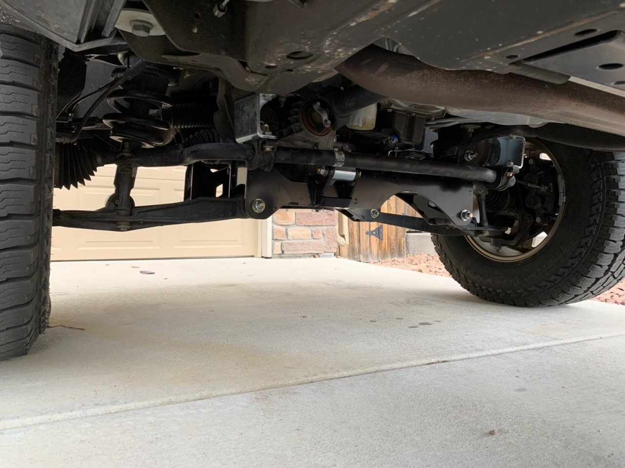

  1. Sorry for the late response. It’s been a year since installing the lift. It doesn’t get mentioned enough or nobody cares but I’ll tell you turning radius is going be affected. The truck rides better than the 3” wanna be lift I previously had. It still corners great and the les swab tires are surprisingly quiet and amazing in deep snow . I’ve been told the fabtech coil overs for this kit a night and day difference. I’ll tell you the stock front struts do work but it’s only been a year and 16000 miles. I can’t tell you how it tows because I haven’t tried it yet. But no regrets and get lots of compliments.

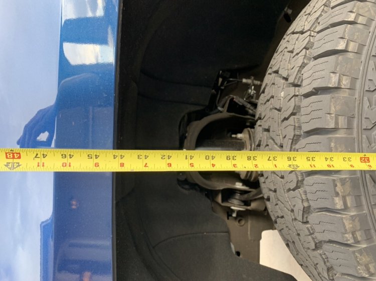

  4. Fabtech gen 2 kits have no track width increase. the mcgaughys 7-9” adjustable only has like a 1/2” increase set at 7”. If 8” isn’t to high for your liking the 8” BDS only has 3/8” front track width. So there are options in the 6” and higher lifts without front track widths. If memory serves the 7” ready lift is very minimal front track width.

  11. Spend the money for the kit with their Upper Control Arm replacements. These spacers kits leave the UCA at safe but also undesirable angles. The kits with UCA will correct this. Without it guys claim to be blowing out the upper ball joints prematurely. If you go off road I wouldn’t recommend it without them. I didn’t like the ride with just the spacer. I get that budget drives a lot of us . If you want a great ride and stance without valor of height. Go for a BDS or Zone counterpart in a 4” lift. I’d went for the Fabtech 4” but wanted more lift. All three of these kits give great angles and a smooth ride. i went fabtech because of the zero front track width increase. But bds and zone are great. In closing if 2.5” is your thing , sting for the UCA upgrade. Hope this helps.
  12. After a year of reading this forum got the 6” gen2 Fabtech lift. Thanks everyone for all the info and great pics that got posted. 2015 Silverado 1500 18x9 -12 offset Raceline Defender Open Range 35x12.5
