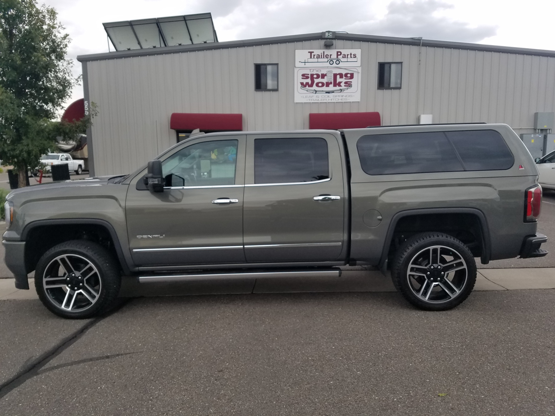

Thanks! I have been really happy with the way it turned out. I just have some chrome to remove and I will be all set! The tires are great - I feel like it is a visually a much better balance once the level kit was installed. It feels and looks more like a "truck" in my opinion!! I opted for the 1 inch lift in the back (actually a 2 inch block replacing the factory 1 inch) to keep a small amount of rake as I tow motorbikes through the summer and didn't want to end up nose high. To me it still looks much better than the front squat that it comes from the factory with! (2.5 inch front/1.0 rear). Here is a photo the day the lift and shell were installed but before the tires were changed. Tires run pretty quiet, minimally louder than stock but with the awesome noise reduction cab almost unnoticeable unless I have the windows down and driving 35-45 mph. Definitely some rubbing - actually there was some minor rubbing after the level kit was installed before the tires were added. Due to the shaped felt wheel well liner, lowering the position of the wheel relative to the liner meant that the "equator" of the tire was now rubbing against the bottom of the liner at full lock forwards and backwards. Not surprisingly this got worse with bigger tires!! I definitely experienced more rubbing than others have reported during turning, not just at full lock. But nothing on metal, just mostly the liner and a very small piece of the plastic trim. I could see no meaningful way to move the liner enough with zip ties but 10 mins with a box cutter and some mild trimming of the lower portion on each front wheel well liner has resolved 98% of the problem. There is now just a tiny rub at full lock on the very lower inner corner of the plastic trim at the bottom of the wheel well. I will likely shave this down and I think that will eliminate 100% of the rubbing problem. Good luck. With your mods - post some pictures as. You go!! CHEERS Sent from my iPad using Tapatalk

Finally got some photos of modifications to date........ SuspensionMAXX 2.5/1.0 level kit Nitto Terra Grappler 285/55/22 1A Auto tow mirrors Leer 100xl with Yakima rack Sent from my iPad using Tapatalk
Finally got a couple of photos of modifications to date. SuspensionMAXX 2.5/1.0 level kit Nitto Terra Grappler G2 285/55R22 1A Auto tow mirrors Leer 100xl with Yakima rack Now just need to get rid of some of the chrome and it will be all sorted! Sent from my iPad using Tapatalk
