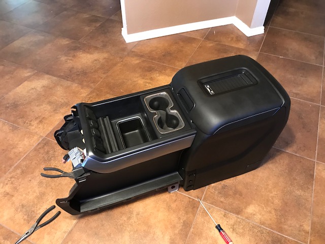

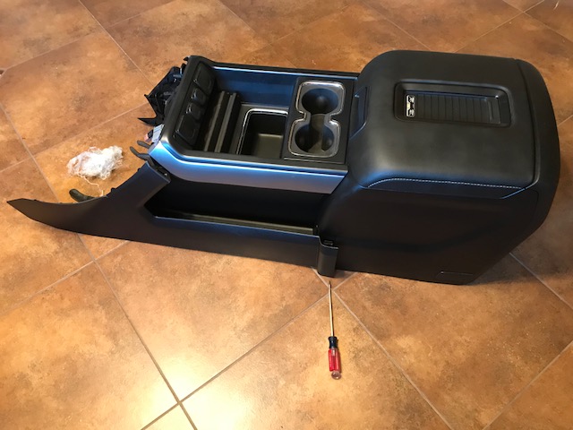

total newb here, read through the thread and I think I am ready to give it a try. Just got my "new to me" truck yesterday and had the console delivered last Friday lol. I love the truck so far and really like the way it rides and handles. First chevy ever for me, minus the 1972 short bed back in the early 90's, which I only had for 1 month. I am not overly concerned with all the plugs in the front working, but I am concerned that all the plugs and light works inside the console. I am by no means a wiring technician, but I think I can do it with all y'alls wonderful tips/comments. Anyways here is my truck and new console to be installed soon lol. I had to order the bracket from chevrolet since my console was ordered off ebay from the guy in New Jersey. I hope all goes well.
