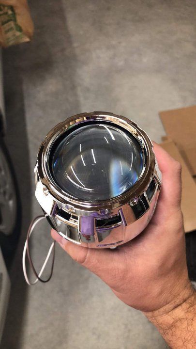

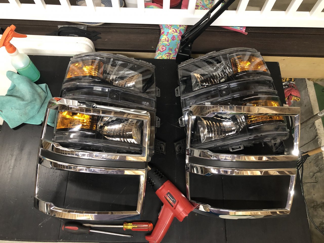

  3. So started this project the other day and I said I would document it. Below are the headlights I got off a friend for a good deal. Here is the kit from Fast Headlights First things first, remove the trim. Used a head gun and flat head to pry them off. Had to be careful about the tabs A couple nights later I had the time to crack them open. I did 270°F for 15 minutes at first, then put them back in at 5 minute intervals after that. All in all it took me roughly 2 hours to split the headlights. The first took me about 1.25hrs because I wanted to make sure I wouldn't mess them up. Second set went much quicker. That's all for right now. Next step is to clean out as much of the sealant as I can and then mount the projectors and test them.
  4. Just ordered the retrofit kit from Fast Headlights for my 14 LT. Also picked up a set of LT headlights to retrofit off of a buddy for cheap so I can take my time putting this all together. I'll make sure to take lots of pictures and post them when I'm done.
