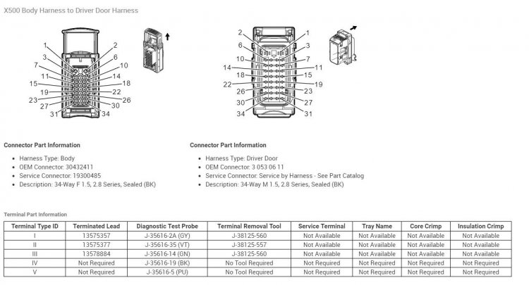

  1. As Phil said this would be a DYI project, factory did not provide wiring for lighted mirrors https://www.gmupfitter.com/files/media/photo/759/Canyon_Colorado_Electrical_Body_Builders_Manual_Service_Manual_2017_en_US.pdf
  2. Sorry I had a typo on the RH Mirror P/N it should have read P/N 23241467 and there is also a P/N P/N 23241469, both are listed as discontinued on the GM part web sites with no description. I assume one is for gas and one is for the diesel (temp sensor), I cant tell if these are DQS, the P/N's are close numerically to the LH side which is P/N 23241465 , any ideas on these? Another interesting thing, GM #PI1255P Instructions for changing to camper outside rear view mirrors, dated Oct 23 2017, for the DQS swap from DL3 lists P/N 22960565 LH and P/N 22970649 RH, both of which are listed as discontinued??? It seems strange they didn't list P/N 84041609 LH and P/N 84228892 (RH Gas) or P/N 84228894 (RH Diesel).
  3. Question about OEM P/N's Looking at a used P/N 23241465 LH assy I think this is a older RPO DQS, when looking at GM parts web site it states this P/N was replaced by P/N 84041609, so I assume this older part would work, can you confirm? Also looking at a P/N 23241467 RH assy, GM parts web sites say this p/n is discontinued with no replacement options, is this a older RPO DQS? Thank you Correction on RH P/N I had a typo
