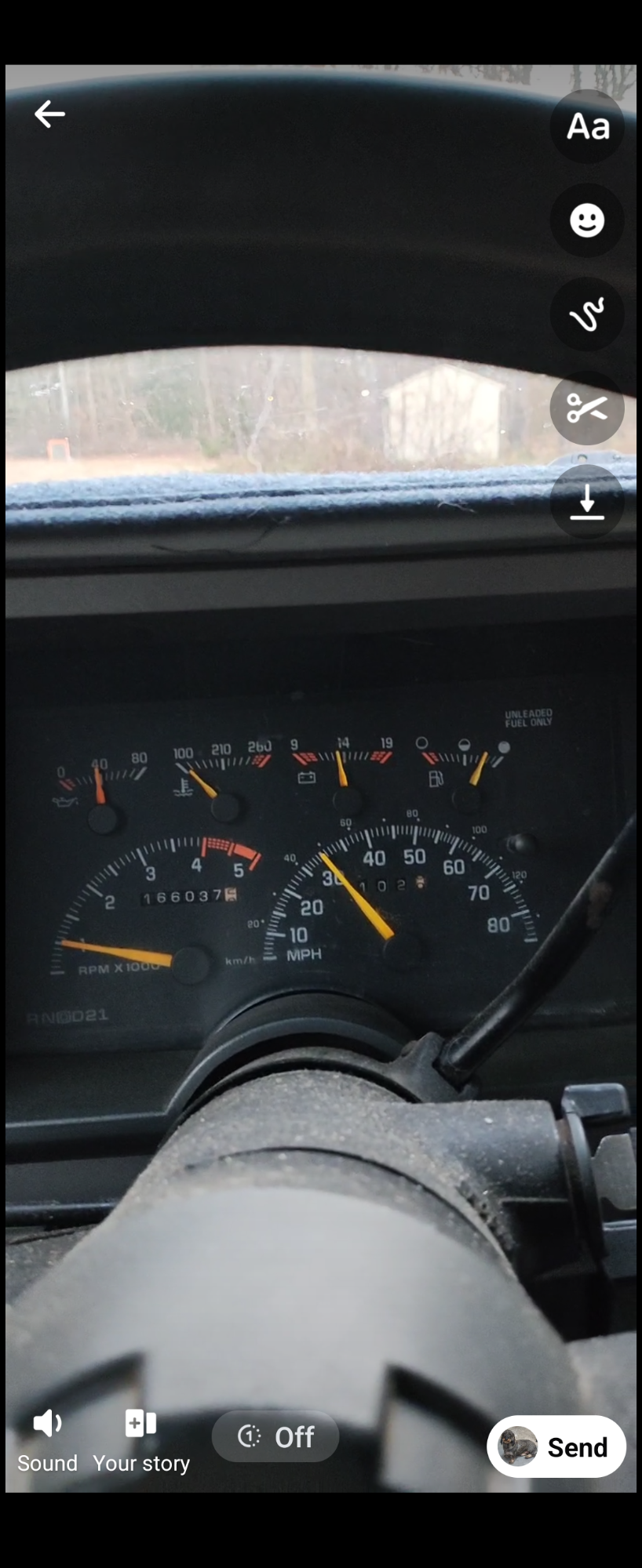

  12. My brother '99? C2500 Heavy 7.4 automatic; speedo is weird. Pls. see attached video. I think it's the sending unit. Doug
  13. Replace the oil pressure sensor. If you ever worked on a small block tou know where it's located, get a GM sensor.

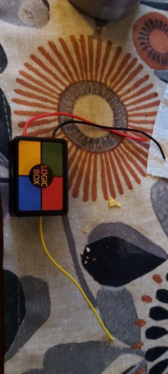

  23. I want to remove the AFM from my 2015 Silverado with the 5.3 I currently am using a data link that shuts it off. Who makes a great kit for this. I have seen ONE kit on Amazon for $500.00 or so. Recommends for a kit maker, part number, source would be much appreciated!
