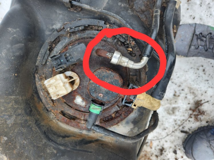

  2. Anyone have a link to an exploded view for the fuel system for 2014 silverado wt with lv3.With the lines and all not just the tank or pump. I cannot find the fuel hose that runs off the pump and connects to the line that feeds the engine. Changing my pump but the metal end of the fuel pump was rusted off and stuck in the hose it snaps into.The 4 little retaing clips are no good.Need to replace that hose.Ony thing on the line is gm213m and I cant find anything that has that part number
