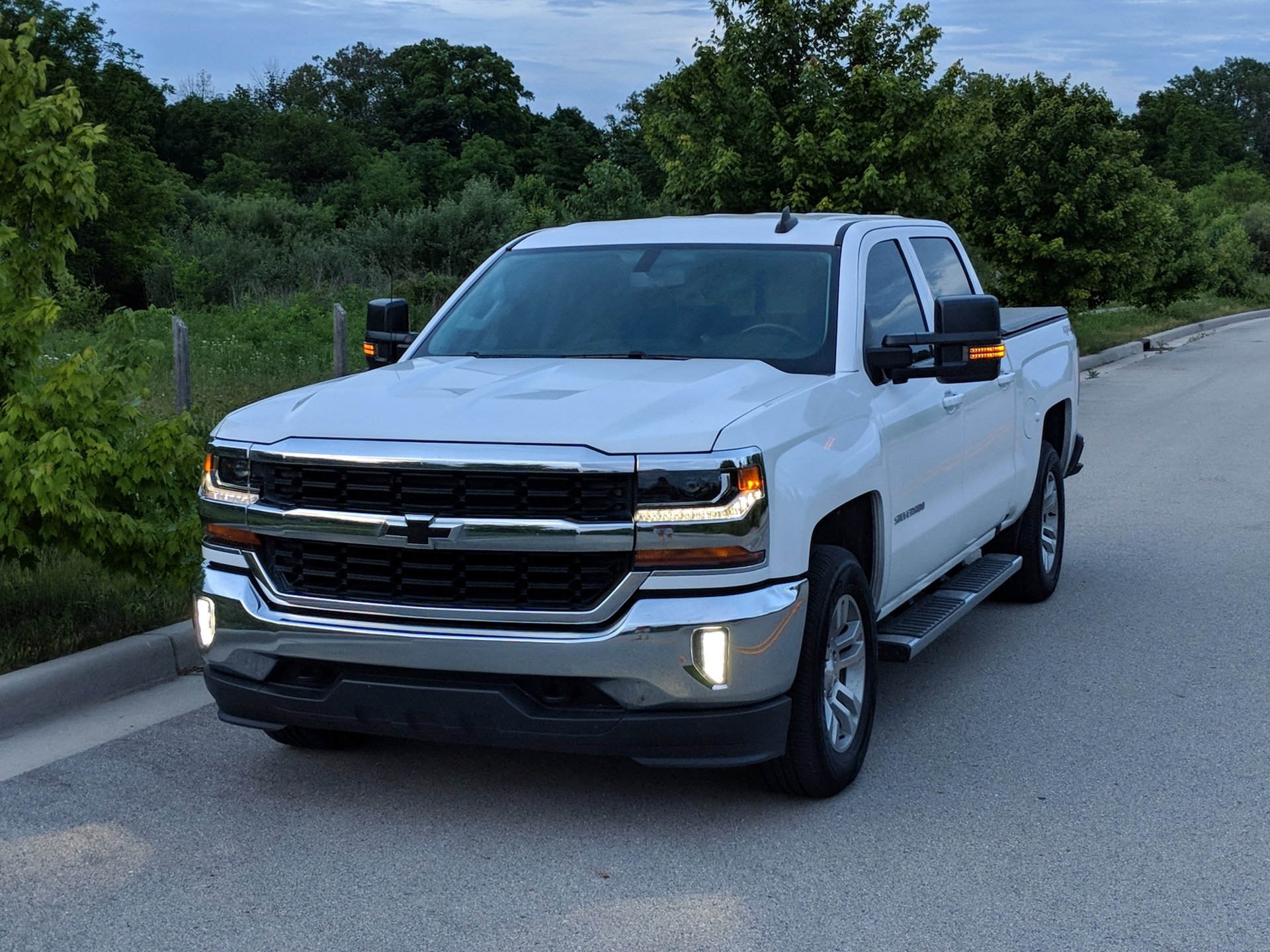

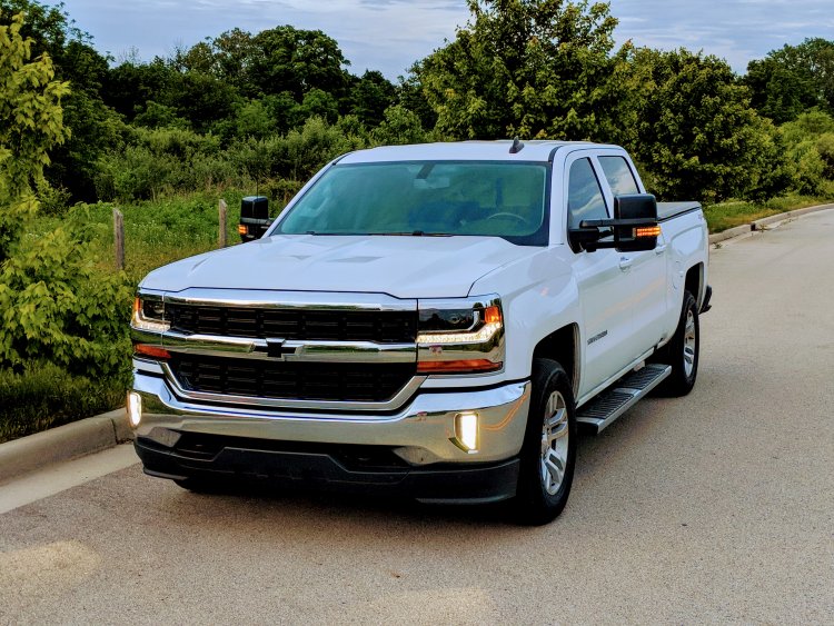

  10. So for me, the long weekend is a break from the hectic day to day... and the time I needed to finally get the tow mirrors installed! Thanks to @Aaron1121for the mirrors themselves. They were just what I was looking for. And of course to @pgamboa for sending out the DIY kit for the harness modification. Everything worked exactly as expected! Of course, I probably spent more than double the time a normal person would take just for triple and quadruple checking the connections. Plus I modified the wiring slightly to add the front park/signal upgrade. Weird as it sounds, I actually enjoyed the project, and @pgamboa's instructions made it easy. If I can get it cleaned up, I'll post a pic later this wknd. I hope everyone has an awesome holiday weekend!
