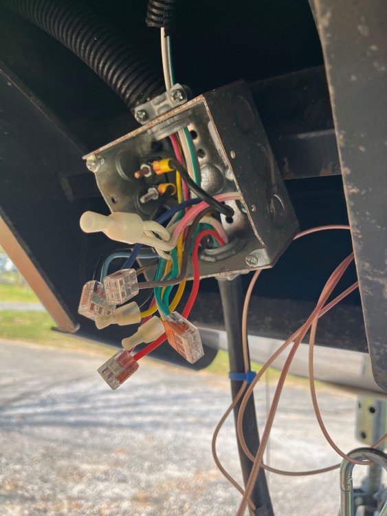

Replaced all 4 brake assemblies. The first one was completely trashed with burned wires and zero brake lining. Second one the magnet was partially melted. The other 2 looked OK but replaced them anyway. Also replaced the breakaway switch. Drove 60 miles to our next campground with no issues. -

*** Update *** The mobile tech was a no-show, so I checked it out myself and found 1 wheel shorted. The others tested seemed OK on the multimeter. Ordered 2 replacement magnets (so i'd have a spare). Tried installing it this morning but when I removed the hub, the remnants of the brake material fell out and the wires leading to the magnet were completely fried.. Didn't bother checking the others. So, now I have 4 complete new brake assemblies coming tomorrow. -

I have a short on the brake circuit on the trailer. Possibly a bad magnet. I have a mobile RV tech coming on Friday. -

Thanks for the responses. I haven't had a chance to look any closer. Will be checking again tomorrow. The trailer is 4 years old but has been towed less than 1,000 miles in that time (including 300 yesterday). We're based in Florida, so not a major rust area. I will probably replace the breakaway switch anyway but still curious about the black device. -

To add to the above... Ran the trailer diags in the trailer app and that shows a problem with the electric brakes. -
Took the first major trip of the season yesterday (about 300 miles) towing a 5th wheel. Trip was uneventful until about 5 miles from destination when I had to take a sharp (about 120 degrees) right turn. As I made the turn, I heard a pop from the rear of the truck and immediately got the message to check trailer connections. I pulled over and checked. removed and reseated trailer connector and could smell an electrical burning smell. As we were only 5 miles to go, I proceeded anyway (dumb, I know). When we arrived, the connection box in the kingpin was warm to the touch and can still smell burning. I removed the cover from the kingpin connection box and the wires were still hot but don't see anything visibly burned. This morning, I'm trying to troubleshoot. When the trailer is connected, the trailer app shows it connected and all connections are OK. Lighting test works. The only problem now is no trailer brakes. The truck doesn't recognize there is a trailer with brakes attached. No light on the trailer slider/switch. Although when the trailer is connected, I get the message "trailer brake gain restored". The 30A fuse #84 for the trailer brake is good. I suspect the "pop" may have been the trailer breakaway connector getting pulled out. Not sure but it was disconnected when we got to site. Below is a picture of the wiring box on the 5th wheel. No sign of burning. Any idea what the device is at the top-left with 2 studs? It has 12V on both sides with or without the truck connected. Any ideas where to go next? TIA

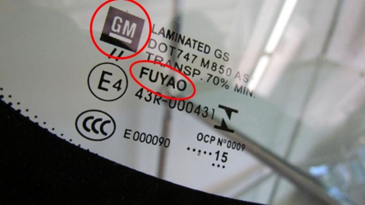

There should be a label on the bottom corner of the glass with the tint level (transparency %). In this example, Transparency of 70% equates to 30% tint.

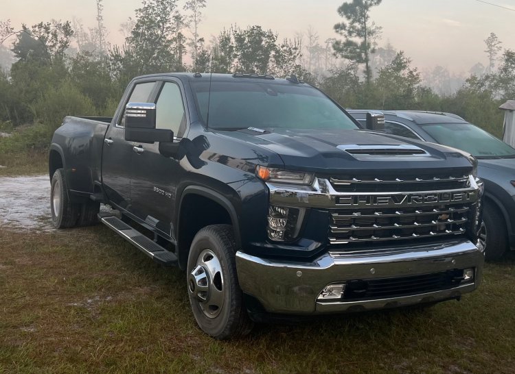

I did a drive-by and saw it on their lot. Checking their website today, looks like it's already sold. Although the one I have is 2 years older, it is better equipped. Over the one I ordered, it has navigation, alloys, blind spot warning, running boards, heated rear seats, not to mention heated/cooled seats and heated steering wheel that actually work. The only regret is that this one doesn't have wireless carplay. I don't think I've seen or heard of anyone that has actually got their "later retrofit" yet.
So the original truck, ordered last September and built in February, finally showed up at the dealership.

Tint removed. Problem solved. -
Finally ran out of patience. Found a 2020 truck almost identical to the one on order. Same color, same trim but with some extras that mine doesn't have, including working heated/cooled seats, heated steering wheel and heated rear seats. Also, has parking sensors, blind spot monitors etc. Picked it up on Saturday. Now, to try and get my deposit back.

What is compounding the issue is the previous owner had aftermarket tint installed on driver and passenger windows and what appears to be almost limo tint on the rear window making the interior very dark. I think I will need to get the tint removed. Not confident doing it myself for fear of damaging the heating elements. -
Just bought a 2020 Silverado 3500HD LTZ. The backlighting for all switches/buttons is very dim unless I have the headlights on. In regular daytime running, It's difficult to see/read the switches. This includes dash switches, door controls and steering wheel controls. If I turn on the side or headlights, they are illuminated and can be adjusted using the brightness controls. Turn the lights off or switch to auto and the backlighting turns off (or extremely dim). Any ideas? I can't find any setting to change it. TIA
