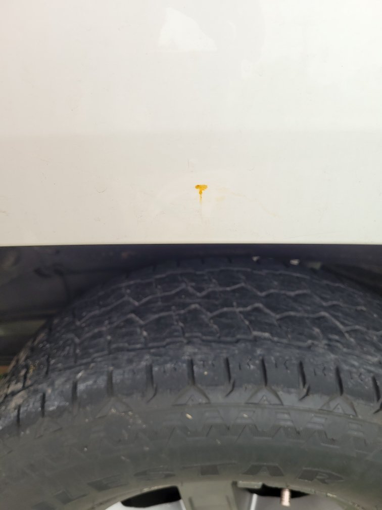

Where are the frames known to crack on the NNBS trucks? Other than the wheel arches starting to rust the rest of the truck is rust free. The entire undercarriage was coated with a thick layer of some kind of greasy undercoating which protected it well. I don't know what it is and can only describe it as spray undercoating mixed with grease of some kind. Makes working underneath a very messy job. -

Surprisingly the inner wheel well is unaffected so far(from the outside anyway) but I'm sure the inside is all rusted and it will start showing soon. If it wasn't for the oil leak and the transmission shifting weird I would fix it but I'm not too worried about that now. To fix it and not have to worry about it again in 1 or 2 yrs requires cutting the metal out and welding in new patch panels which isn't something I'm set up to do anymore.(Nor want to I hate body work!) The transmission is what concerns me and I don't know if it's ever been worked on or rebuilt before. Of I had to guess I'd say no and that it's 100% original. I've always had very slow shifts in this truck since I got it which may be normal for it unfortunately. I have never driven another vehicle with the 6L80 in it to compare. What I mean by slow shifts is that while accelerating at average speed sometimes it won't shift until I let off the gas or it does shift but very late and high in the RPMs. Also sometimes it will flair, I don't know how else to describe it other than a flair. It's almost like a slip but finally catches itself and continues driving. It also will downshift strange sometimes as well. I notice it mostly in traffic when just letting off the brake and coasting enough to hit 2nd gear then hitting the brake again. I'll get a clunky downshift. I've owned multiple GM vehicles and trucks but they all had either a 700r4 or 4l60 in them. None of them shifted as poorly as this 2011 does. -

I have a 2011 Sierra with 210k miles on it now and is in excellent physical condition inside and out with the exception of rust just beginning to form above the rear passenger wheel well. Mechanically it's been better than most vehicles I've owned until recently the transmission started flaring shifts sometimes but not always and it seems to have lost power. At the same time this happened I noticed my oil pan started leaking around 3/4 of the perimeter! I just bought this truck a little over 2 years ago with 150k on it and spent $13,500 on it cash. I really can't afford to have the transmission rebuilt without going into personal reasons just know it's not an option in the time frame I need it done. I am a competent mechanic but have never torn a trans down only remove and replace. I'm looking for suggestions on what you guys would do in my situation? I'm seriously considering attempting the trans rebuild myself. I know the clutches will need replaced and seems to be the problem with it. Edit: Truck has the 5.3 and 6180 with towing package and heavy duty cooling
