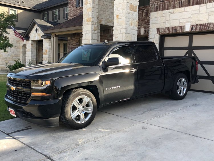

To have the truck level, you need a 3" difference between front and rear. Almost every 2/4, 3/5, 4/6 drop that I have seen will result in a little rake. Here is a pic on my truck, it's a Crew Cab, and I have a 3/5. That's with a full tank of gas and some tools on the bed. Bed empty and it is more noticeable.

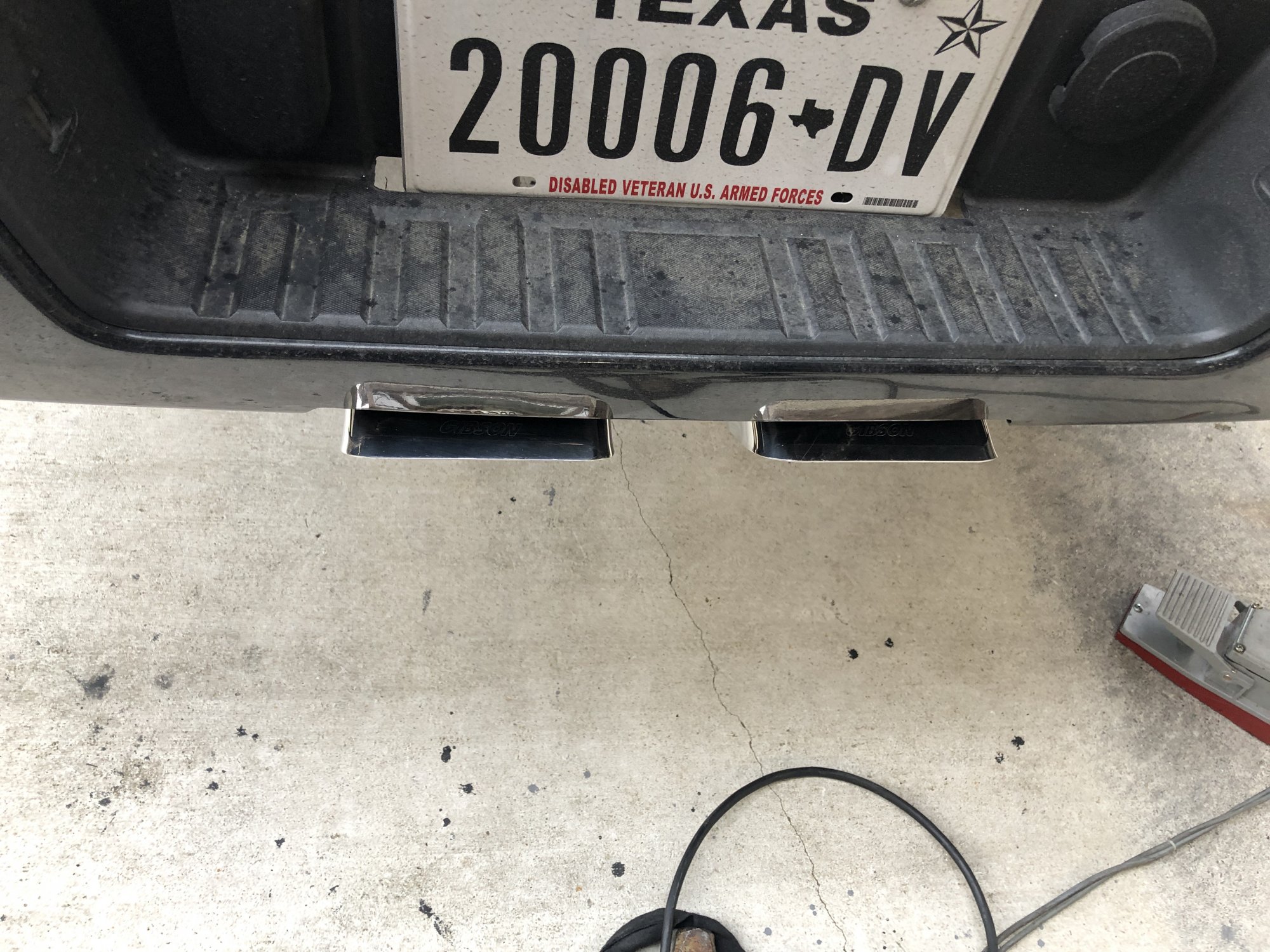

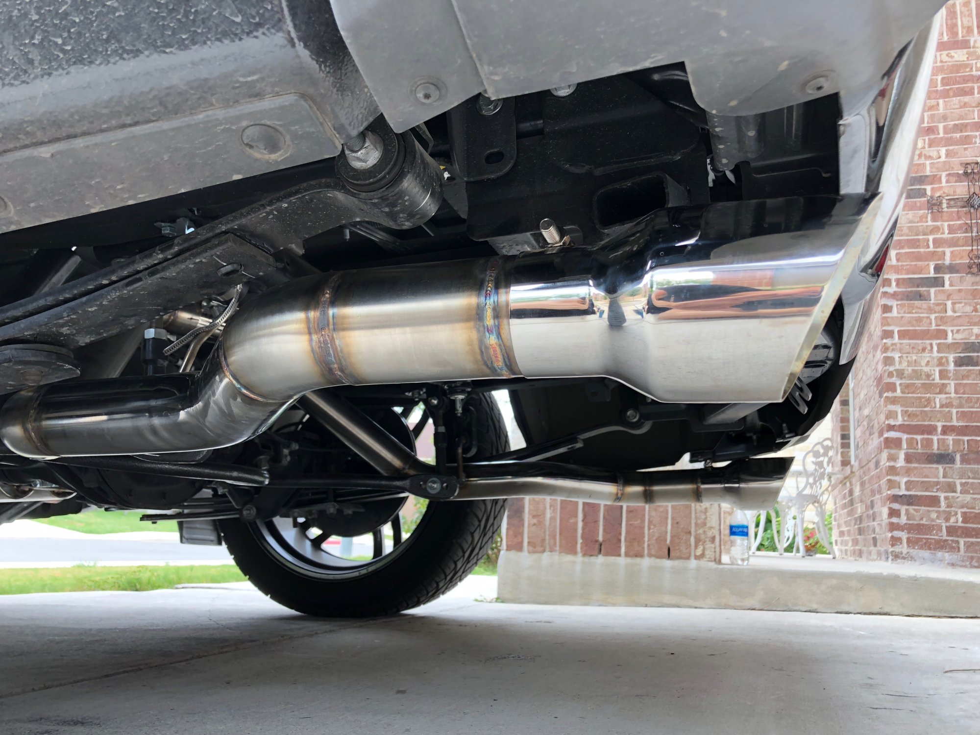

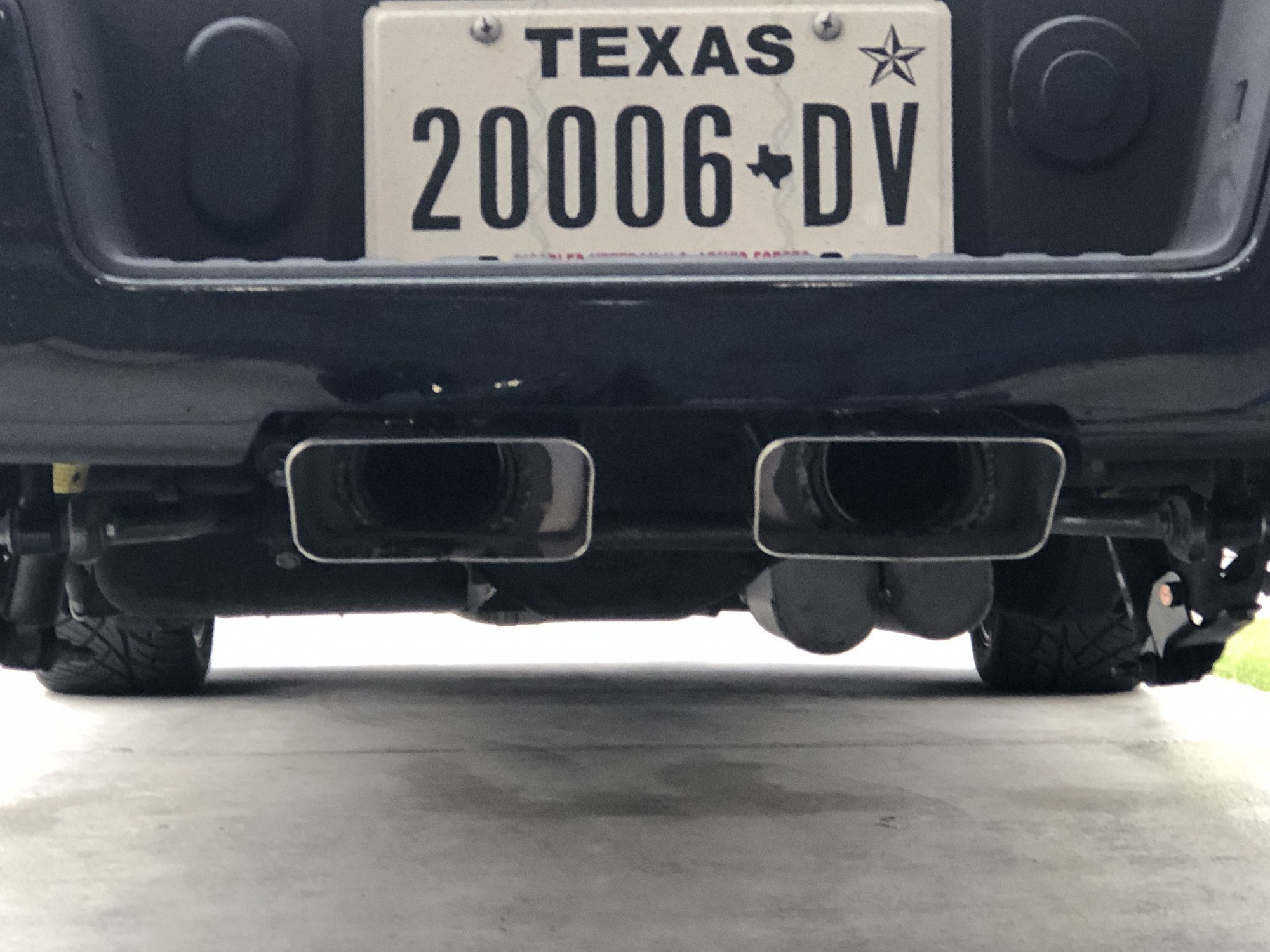

got the tips installed. Exhaust companies need to produce more 3" tips... Magnaflow, Dynomax, Pypes, Gibson, Borla, all the tips that are decent in this line that I could use were 2.5". The ones I got were 2.5" but I made a 3" to 3.5" round to oval connector and welded it after cutting the end and matching the hole to the 3.5" oval size. The truck drones a little more than with the round tips, but I think it is because the opening on the Gibsons is so big that its resonating under the bed at cruising speeds. I think I will probably extend them all the way out and cut the excess from the top and re-polish.

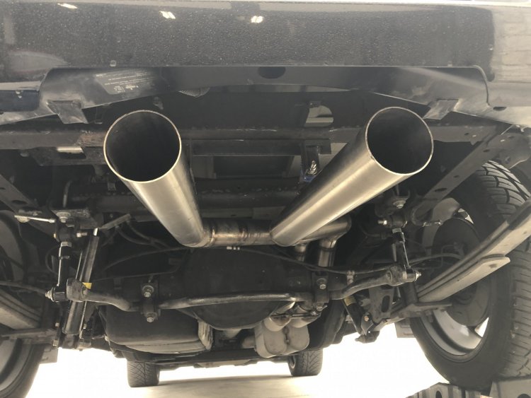

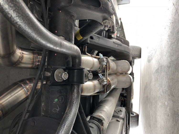

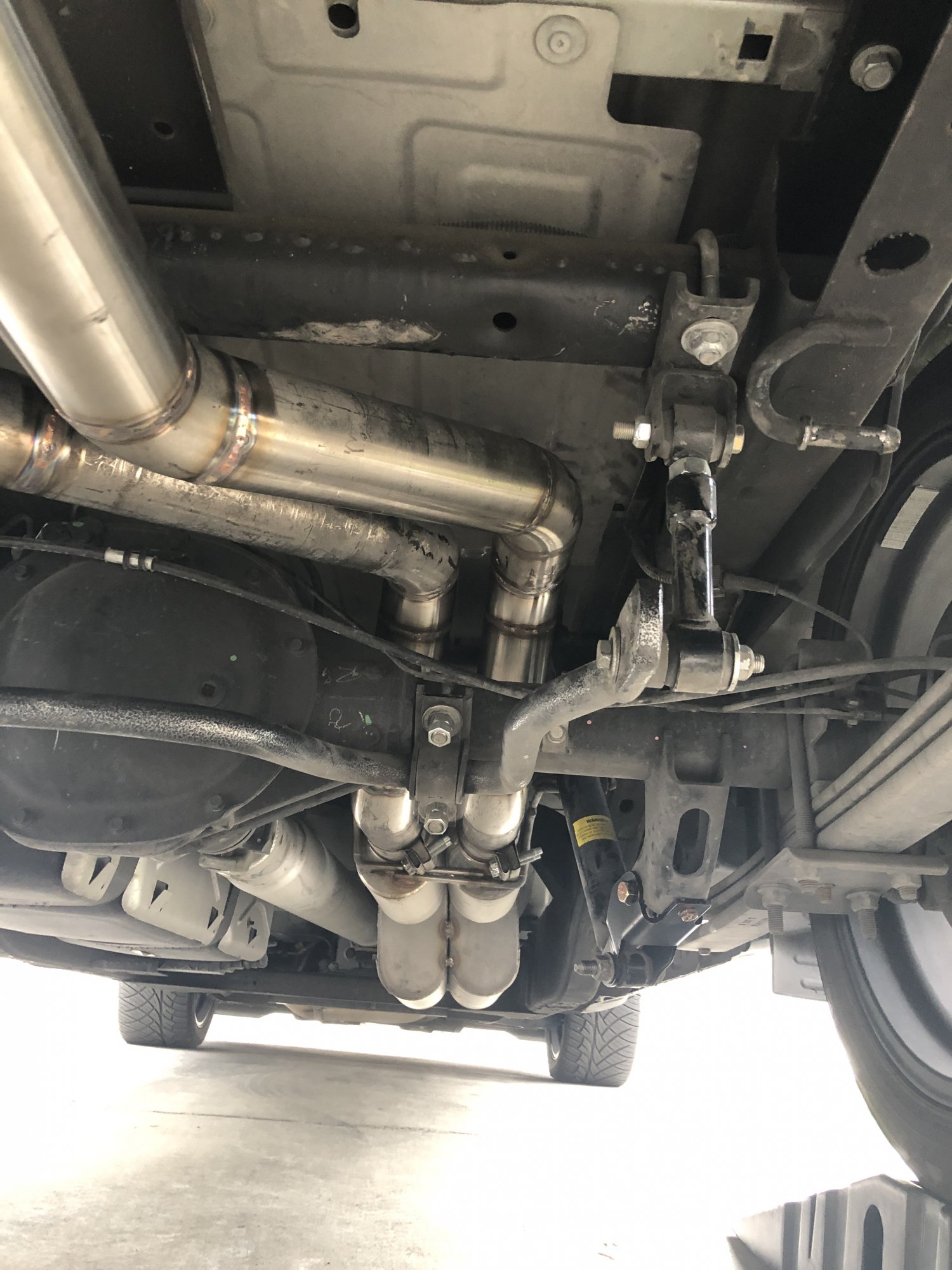

last 2... I wish the site would compress the pictures. The big mufflers are Dynomax, they are getting swapped soon with two Magnaflow 6" round x 30" long mufflers... just waiting to fab up a new transmission crossmember to run my duals down under the driveshaft yoke instead of under the transmission into the passenger side. Also, decided on this configuration if I need to install J-pipes (quarterwave resonators). They will be a lot easier to mount parallel to the straight runs on the bak rather than in the front next to the mufflers.

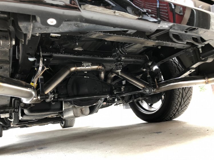

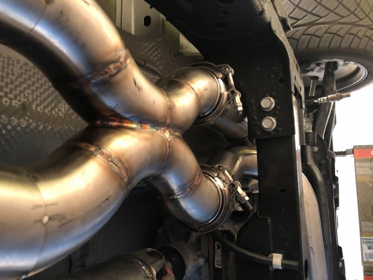

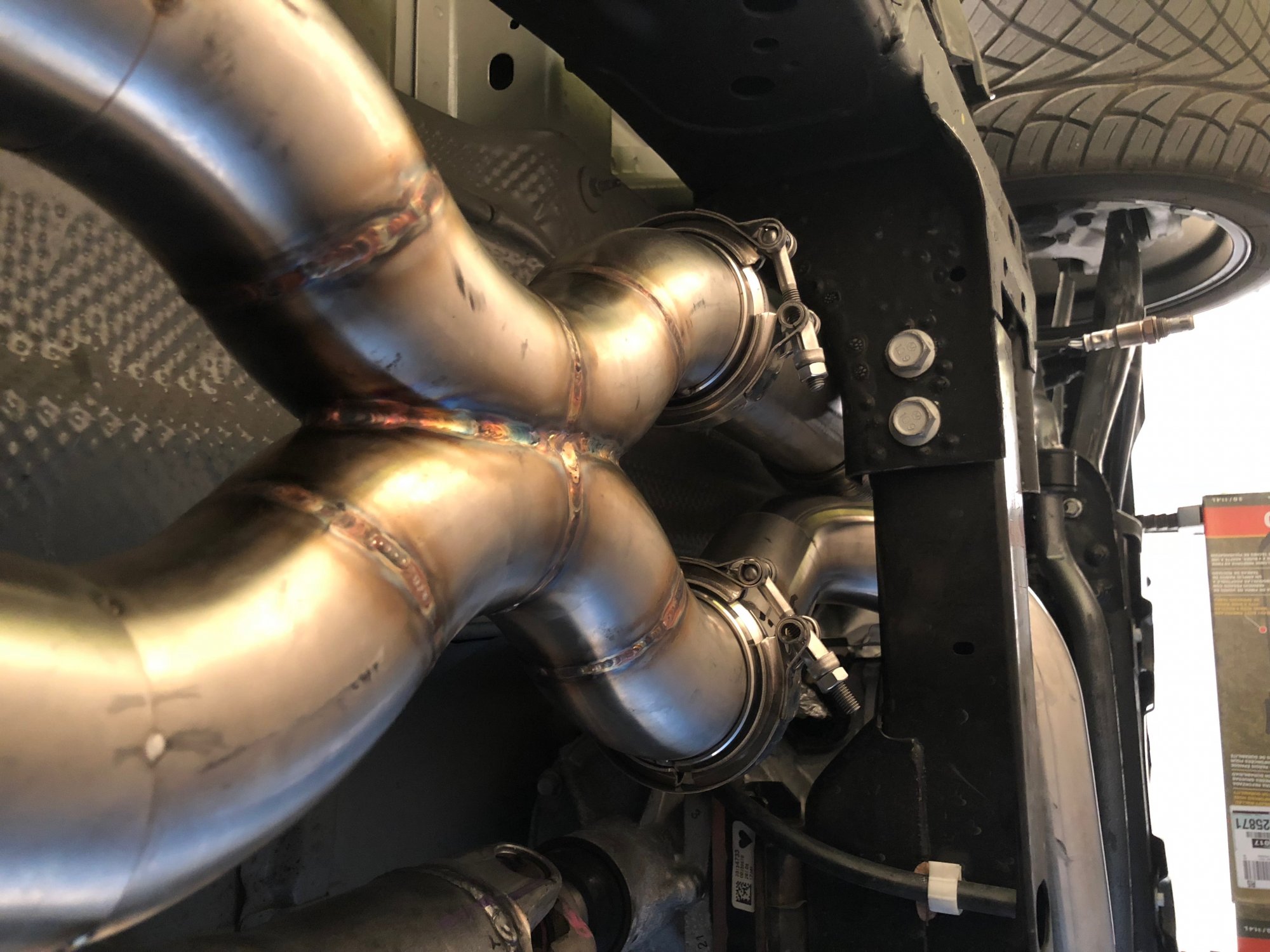

Time for a version 2 of my exhaust, not because I wanted, but because I needed to. I added shock extenders a few days ago, and the driver side tube was in the way of the shock, so I was forced to re-do that side... problem is that there is no space to run the tube now because on the back side I have the Hellwig link and on the front GM placed the "splicer" for the brake lines. So I decided to do a center out exhaust. The original plan was to run the same set up as the Gen4 SLP CME exhaust, but I didn't feel like paying over $150 for a set of knock-off cast aluminum pieces that I would had to modify to make them work, so I decided to just run them down the center, as I don't keep my spare under the bed anymore. I am still waiting on the tips to arrive, I ordered Gibson's rectangle sport exhaust tips (which I will still need to modify just easier). I don't know if I will end up using them as I keep changing my mind between them and a quad set up... Old exhaust routing New set up.

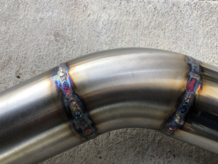

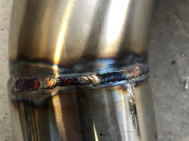

Well, not that much better, the new exhaust on most of our trucks and cars now it’s 409, so it will not rust through. You will get surface rust, but that’s just cosmetic. And yes, Ti would had been almost triple what I have spent on this, not counting the argon, as for Ti you need a lot of flow as compared SS. Thanks! -

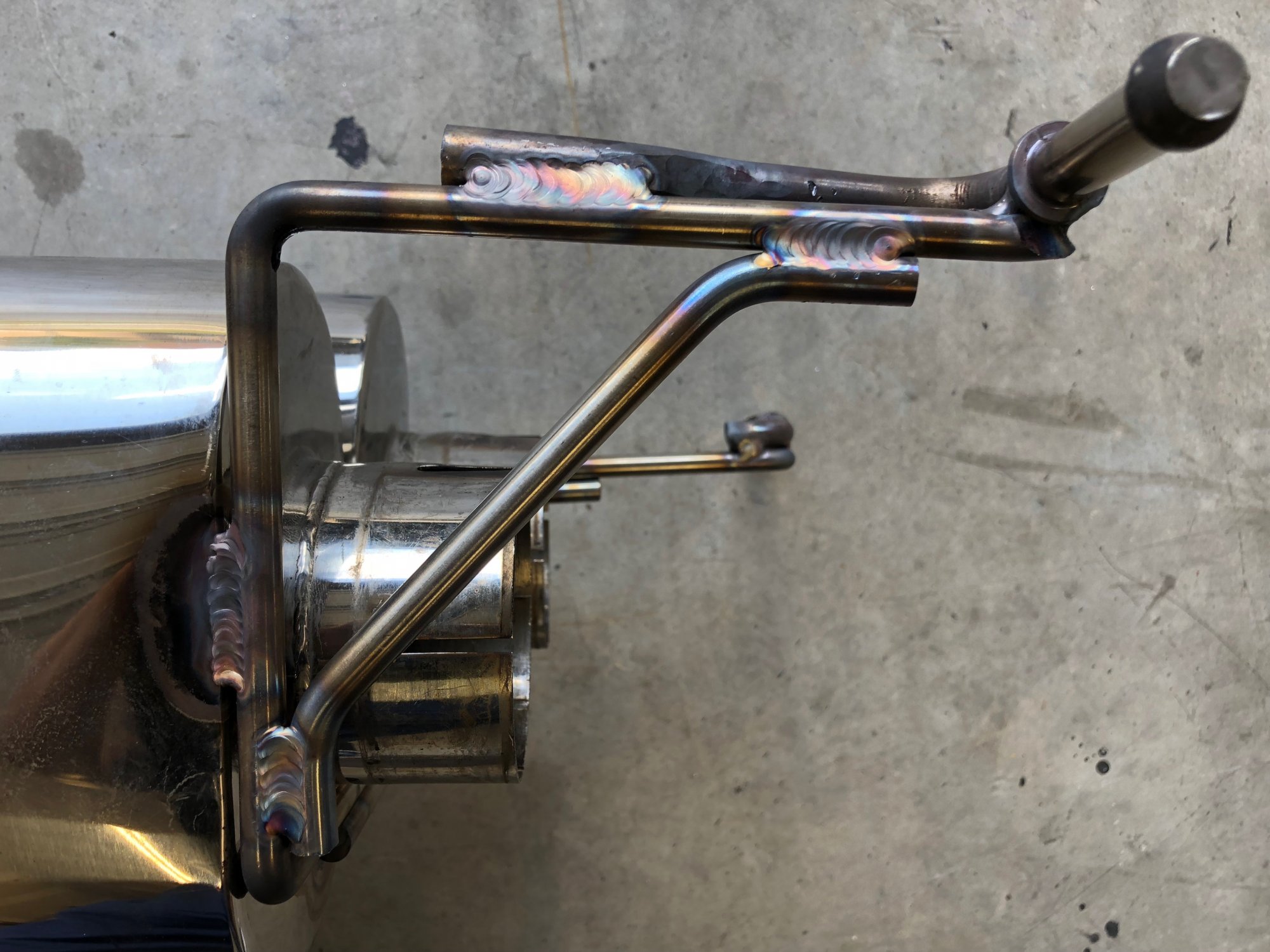

I wish that was titanium... plain old 304L stainless... but done right (or wrong depending on the code) you get a lot of nice colors. -

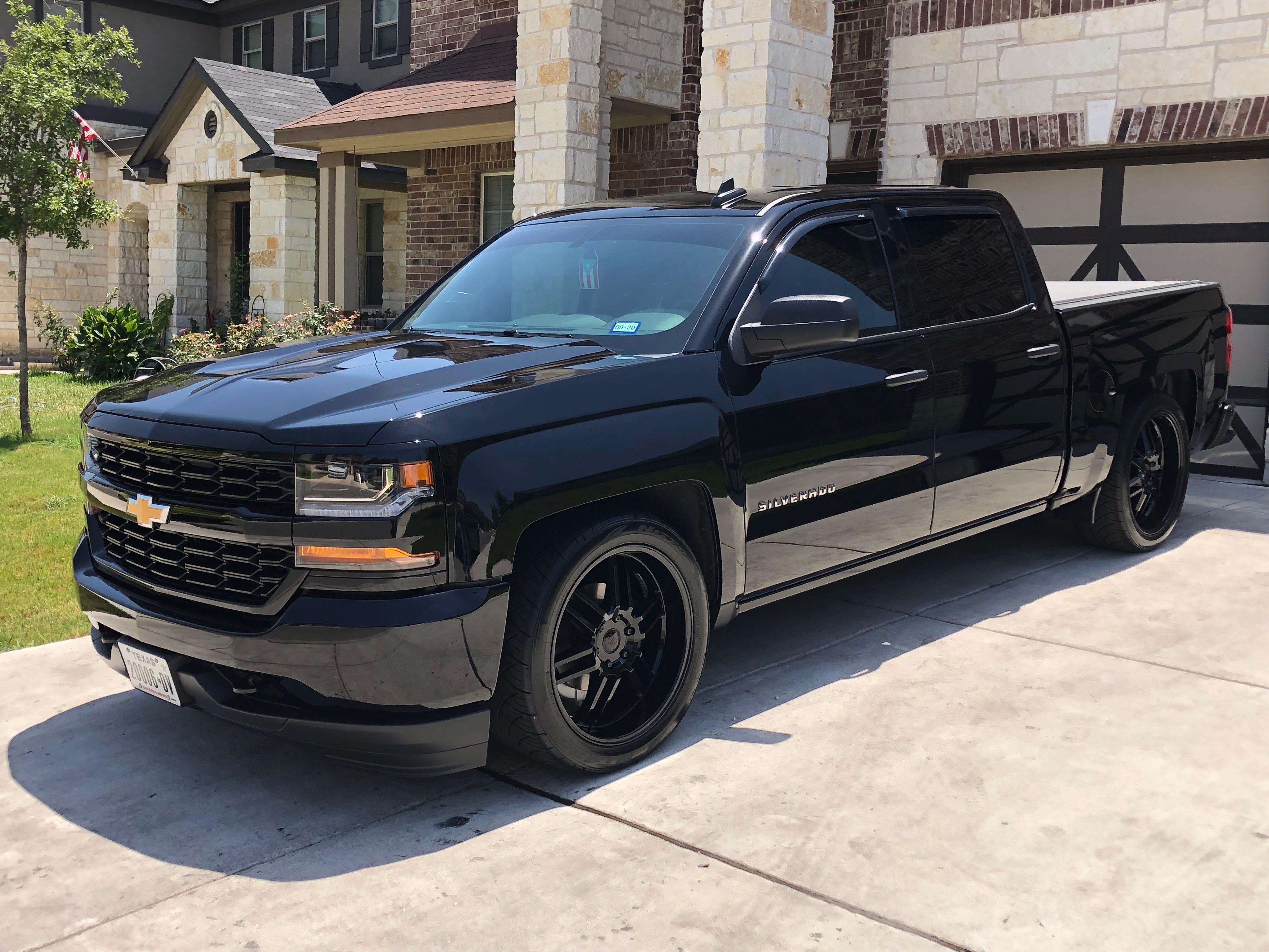

New guy here, bought a 2018 Silverado Custom (traded my 2011 Camaro SS) after deciding to start my own detailing business (part time for now)... anyways, can't leave my cars stock for too long, so I have been doing several mods within the last 6 weeks since I bought it. I lowered 3/5" with a MaxTrac kit, added some Black Rhino Katavi wheels with Nitto 420S, Bak Revolver4 tonneau cover, Speed Engineering LT headers, and my own custom exhaust. Added both front and rear Hellwig sway bars, and deciding what traction bar to get. Truck has a full tune by Henderson Performance Technologies. Changed the door handles for OEM black ones, and I am painting a "paint ready" tailgate handle soon a long with the lower front bumper valance. Still a lot to go, planning on de-badging the truck soon, doing full paint correction (possibly sanding from 1500 - up, but uncertain as this paint is one of the thinnest I have seen in a while for a brand new America car/truck) and installing Opti-Coat Pro+. And I would love to swap the rear bumper cover for the one without the climb assist holes in it. A 2 piece aluminum driveshaft is coming very soon, as we found out the single piece like to go kaboom at high speeds, we tuned in 2nd gear, averaging 300RWH, and in a quick shot at 4th gear stopping around 120 the truck hit around 330rwhp, not bad for an auto 305, when my 04 GTO M6 with headers did only 321. Once the cost of performance parts start to go down for the LT platform I will be fabricating twin turbo (we are hoping in about 3 years if not sooner). -
Exhaust... I like to think outside the box and what's available on the market... the only one that kinda got my attention was Speed Engineering Tru-Dual set up... so I decided to make my own. Speed Engineering LT headers, 3" dual 304 stainless, 2 (17547) Dynomax mufflers welded together followed by 2 (off brand) 5x7x12 stainless mufflers... I wanted to make it quiet, which it is not... tuned by Henderson Performance Technologies in New Braunfels, TX. Can't say enough good things about Corey... if you are near the area and needs to get your truck (or car as he specialize in Corvette and Camaro) give them a call or a visit. Truck is lowered 3/5, and I am running 22x10et25 with 305/40/22 Nitto 420S. This is the first version of the exhaust... already thinking about changing a few things, but in the meantime I can say that the sound is unique, especially at WOT.
