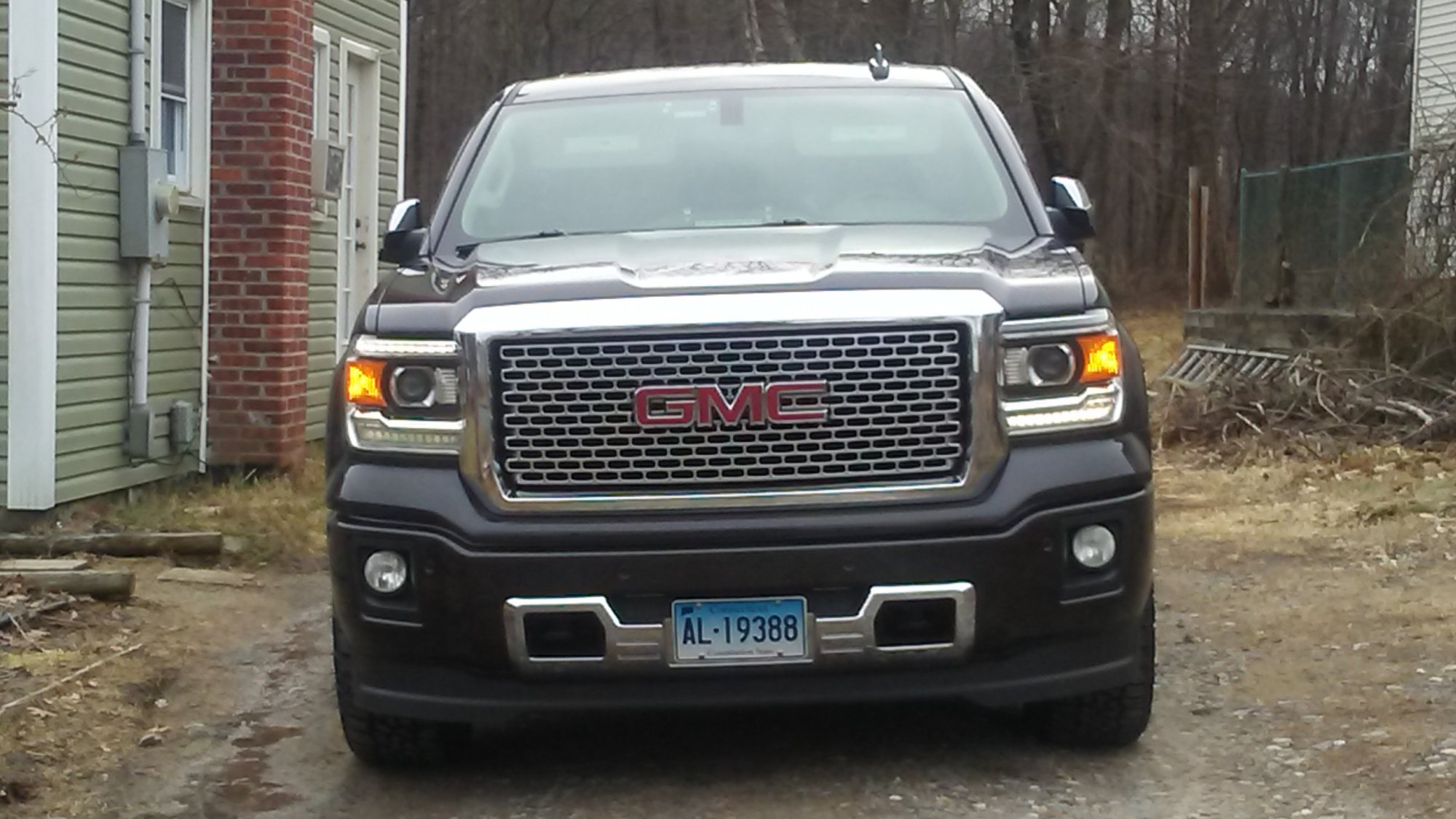

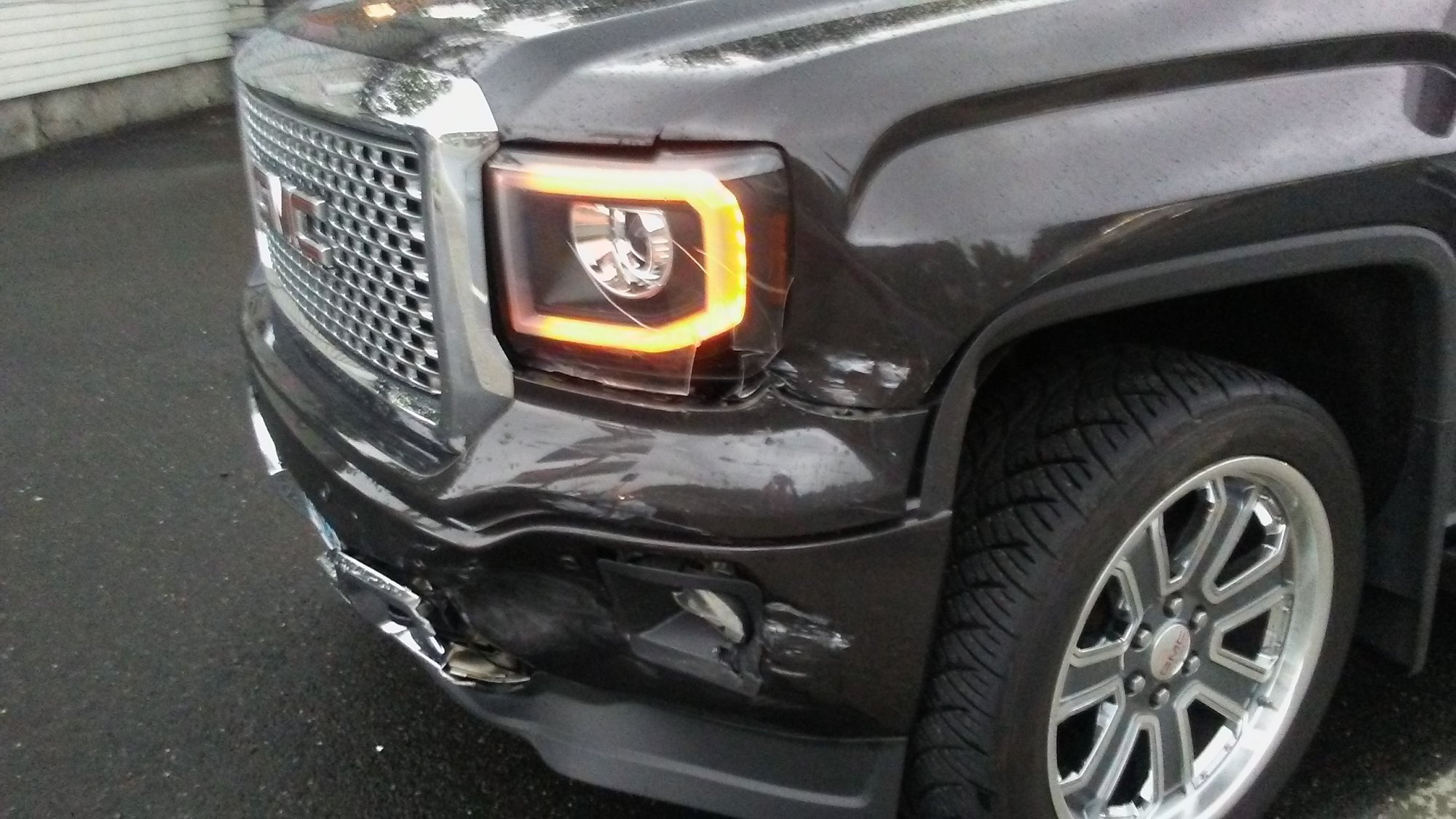

Hey guys & gals. Kinda new here, & I see the post is older, but sure it doesn't hurt to learn more. So just over a month ago I had a 19-20 something year old jump 3 lanes of traffic & slammed me head on......... Since I bought this truck about a year ago, I've been looking on this site & others to see what people are doing, what works & what doesn't. When I saw the pic of the 2 door silver Sierra with the hood done on it, I knew I was ganna do it, saving my cash & then the accident happened, so I spoke to the shop owner & he agreed (since the cost was about the same) that he'd do the "Ram-Air" style hood for me.... Well got to tell u guys I didn't know (since he never told me or asked me if he could do this other stuff to it & just did it anyway) the shop owner did a 2019 Frontend Conversion to my 2015 Denali..... This is by far that one time you don't mind a shop did other stuff & didn't ask/tell u..... So I'll throw a pic up the day I bought her & the day they finished the work. You all can judge & let me know what u all think? Enjoy..... -

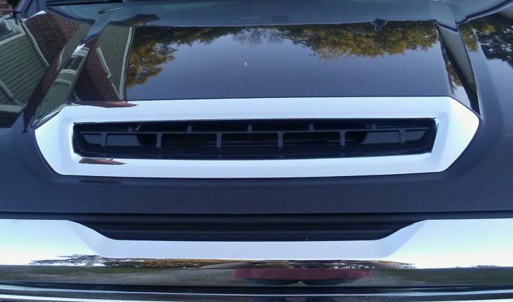

It actually is on the right side of the hood, when closed it's kinda like above the steering shaft. So there doesn't seem to be anything that it could/can rub against.

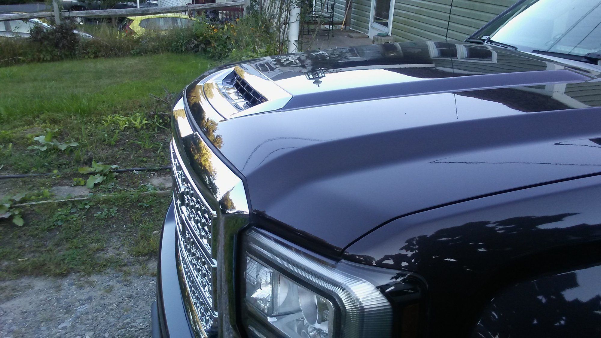

My bodyshop guy had to get the 2500 hood springs, for two reasons, the 2500 hood is steel, not aluminum & the holes in the hood are in a diff spot. So long as u get them u should be good to go. I know we did a test fit before paint... In the last pic I threw up u can see its all done & the body lines are mint.... Do what I did & don't cut corners.... Any other questions ill try to be of help. Is your truck a Sierra? Or Silverado? I only ask cuz I've read with the Silverado there is some other stuff u need to change as well. But being I've got the Sierra, i kinda didn't read up on it, sorry...

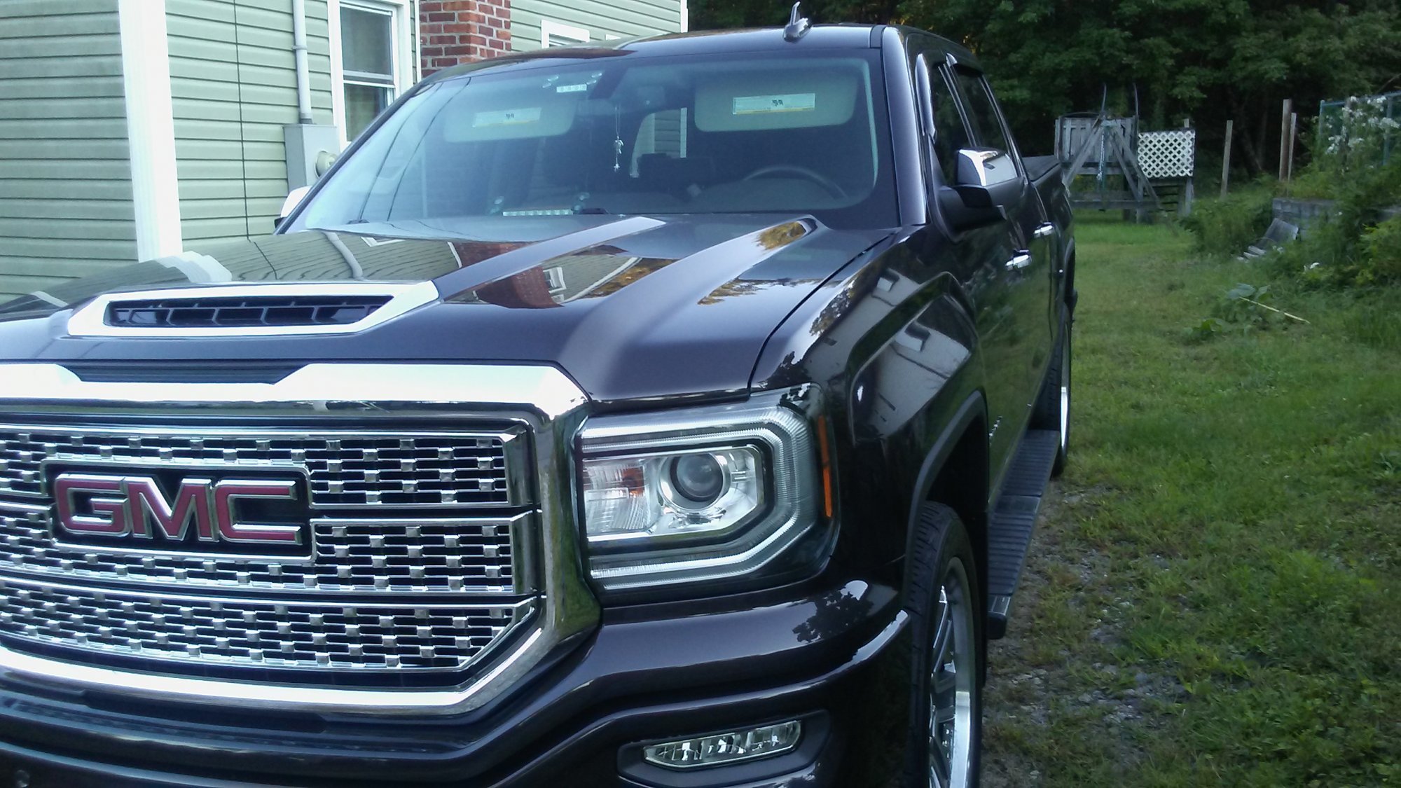

So my advice to anyone here, if you have the means, or if you are unfortunately like I was & had a head-on-collision, get the hood. I was gonna do the hood anyway, but since the accident, everything had to be replaced anyway. So the shop looked up the parts & cost & told me it's not going to matter much if he did the 2019 parts..... The only couple of things that were more expensive were the hood (which we knew, cuz of the added parts for it), The headlights & Aux Driving lights, or some people call them "Foglights"..... I really feel like I'm 5 again & it's Christmas & I can see my gifts under the tree, just can't touch them yet..... LOL. But hands down TY to the people that did the hood before me, if it wasn't for them, i might not have tried it......
And now the final product........ When I pick her up tomorrow, I'll take more pics of the sides, close-up of the hood & lights, etc....
