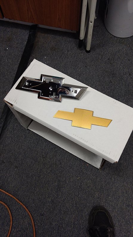

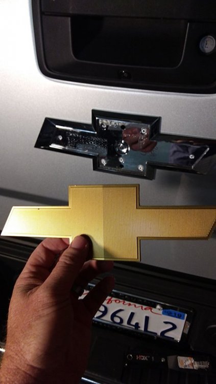

  3. the gold portion is held in by plastic tabs that are press fit from the back to hold them in place. All you do it get a Super thin paint scraper, heat up the gold portion, and slide the paint scraper between the gold and chrome and cut the tabs.

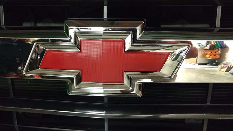

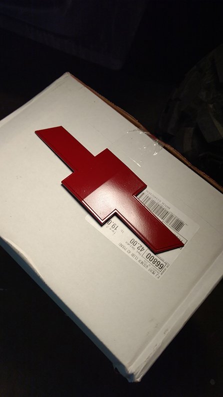

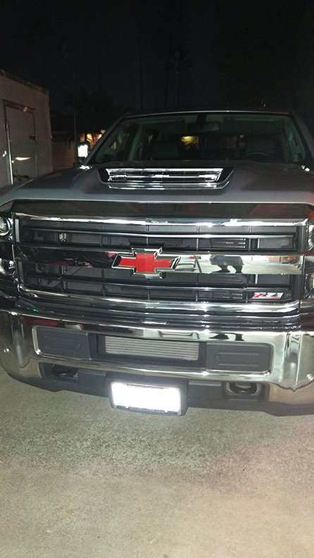

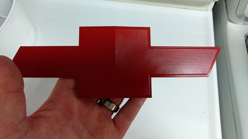

  4. I just redid all my emblems. I pulled them off and painted them myself. Looks totally factory! For all wondering, on the 2017-2018 2500 HD's, you can fit your hand down through the top with the hood latch is to get to the emblem. You DO NOT have to take off the radiator shroud. You can feel the tabs from the backside and pop out the emblem. Also, the gold portion is held in by plastic tabs that are press fit from the back to hold them in place. All you do it get a Super thin paint scraper, heat up the gold portion, and slide the paint scraper between the gold and chrome and cut the tabs. Sand smooth and re apply with 3m double faced tape. Painted with Caliper paint... Cost was about $20...
  5. 2018 Silverado 2500 HD Duramax/Allison Z71 Ice Metallic Silver... Just changed the emblems...Can't stand Gold. Did Vinyl! I may buy another set of front and rear emblems and paint them. I can't find anyone that sells red. Everyone has black or silver.
