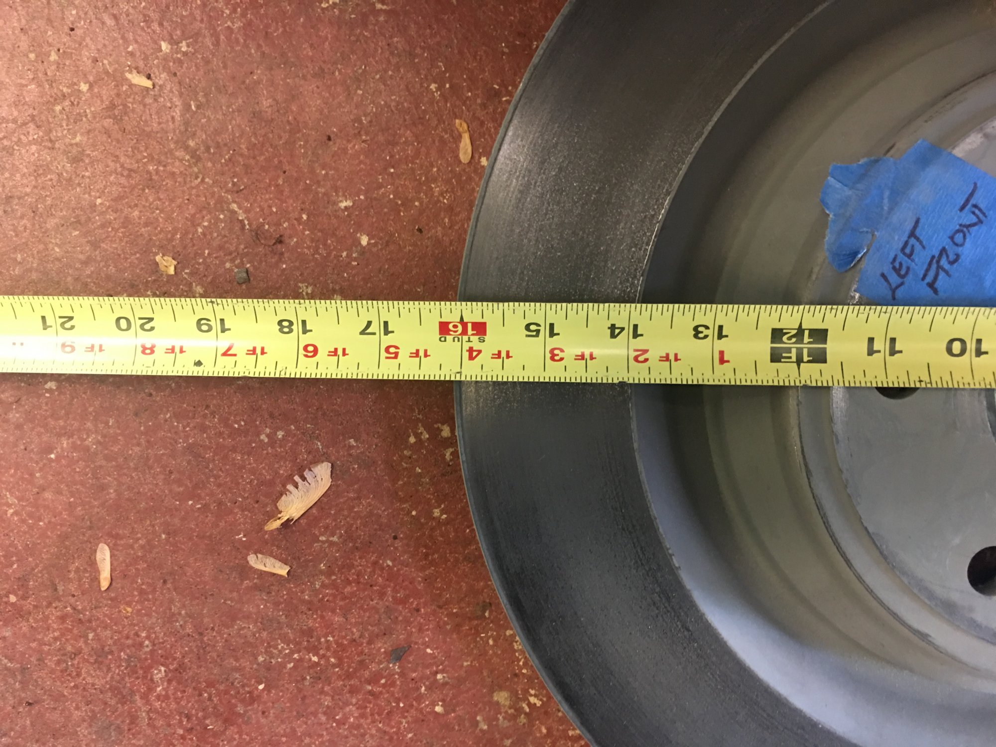

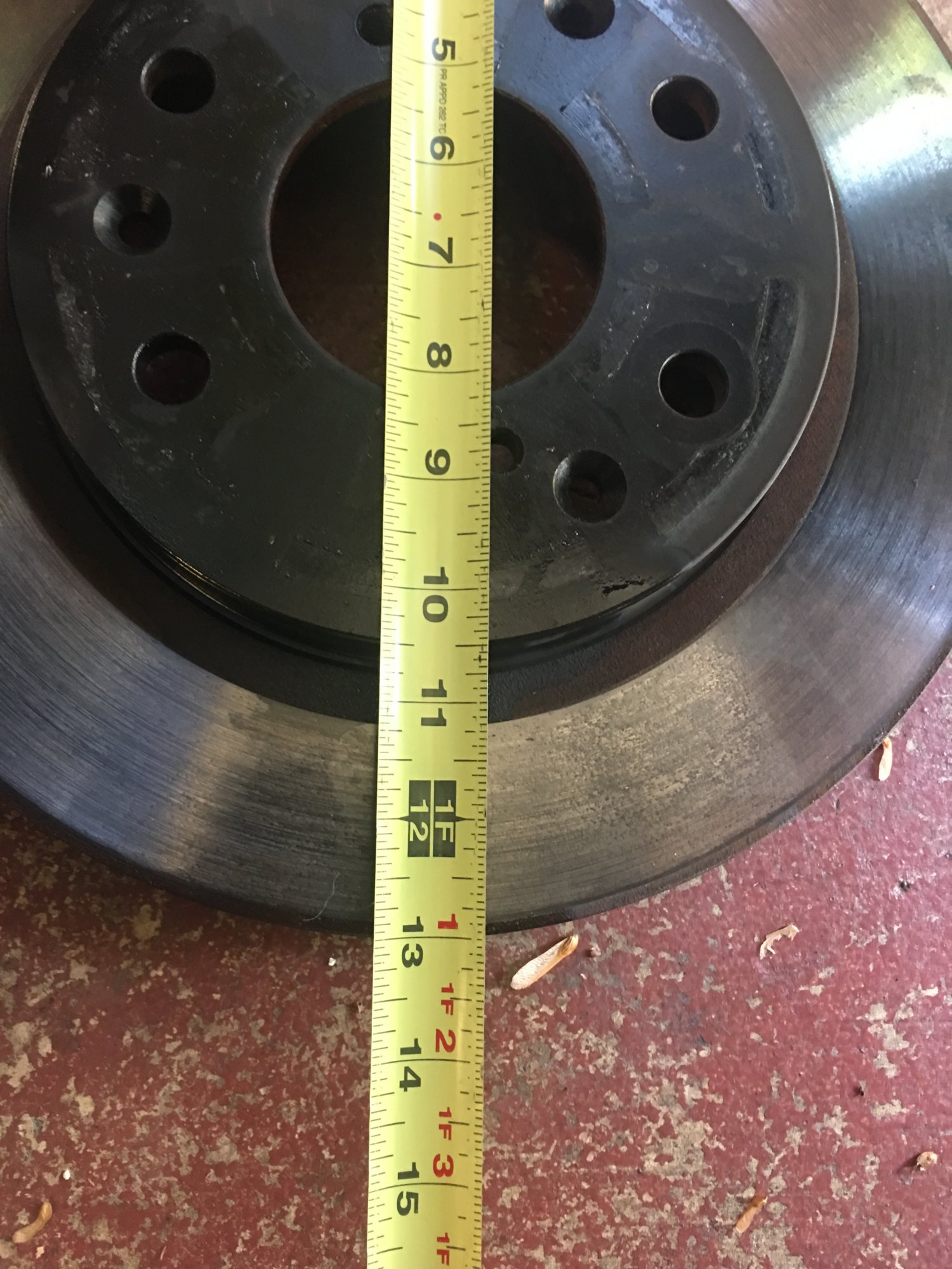

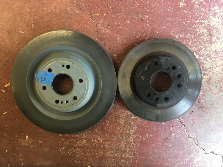

I have not confirmed but I believe the Aftermarket Rotor part number for the 16” rotor is Centric #120.62180 -
