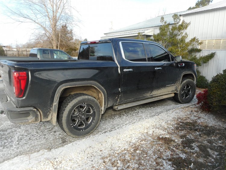

  1. I have had no problems with the Rough Country 2" front level kit. I recommend it 100%. I'm running a 305-50/20 tire. 0 offset wheels... We did have to trim inside the wheelwell, and cut the front mudflap for turn clearance...
  2. It took RC 1 day to figure out my truck. All I did was level the front... they fabbed up a bracket to relocate a sensor, and otherwise just used 2018 part I think. That was before Christmas; I don't know how long it will take to get that out there into a kit... but it is working beautifully, with no electrical glitches or other issues. Brad
  3. Dropping it off tomorrow at Rough Country's R&D shop. They suspect that they will have to relocate a sensor in order to make the standard kit work with no effect on the ARC...
  4. I saw that, and commented in that thread... no reply yet. I just want to know if he had any problems...
  5. Well, I did. Got a bunch of "I don't know" or still working on it replys... That is why I assumed that somebody out there is as impatient as I am, bu maybe has had their truck longer... (I got mine on Saturday...)
  6. Hey folks, I just bought a '19 Sierra Denali crew cab 4 x 4 with Adaptive Ride Control. I want to add a 1.5" or 2" spacer to the front in order to make the truck sit level. Internet reading and a couple of lift kit tech guys suggest that there may be some programming necessary after a kit is installed. Others say it is not. Has anyone done this that can give me a firsthand report on what kit you installed, and what exactly is involved? Thanks, Brad
