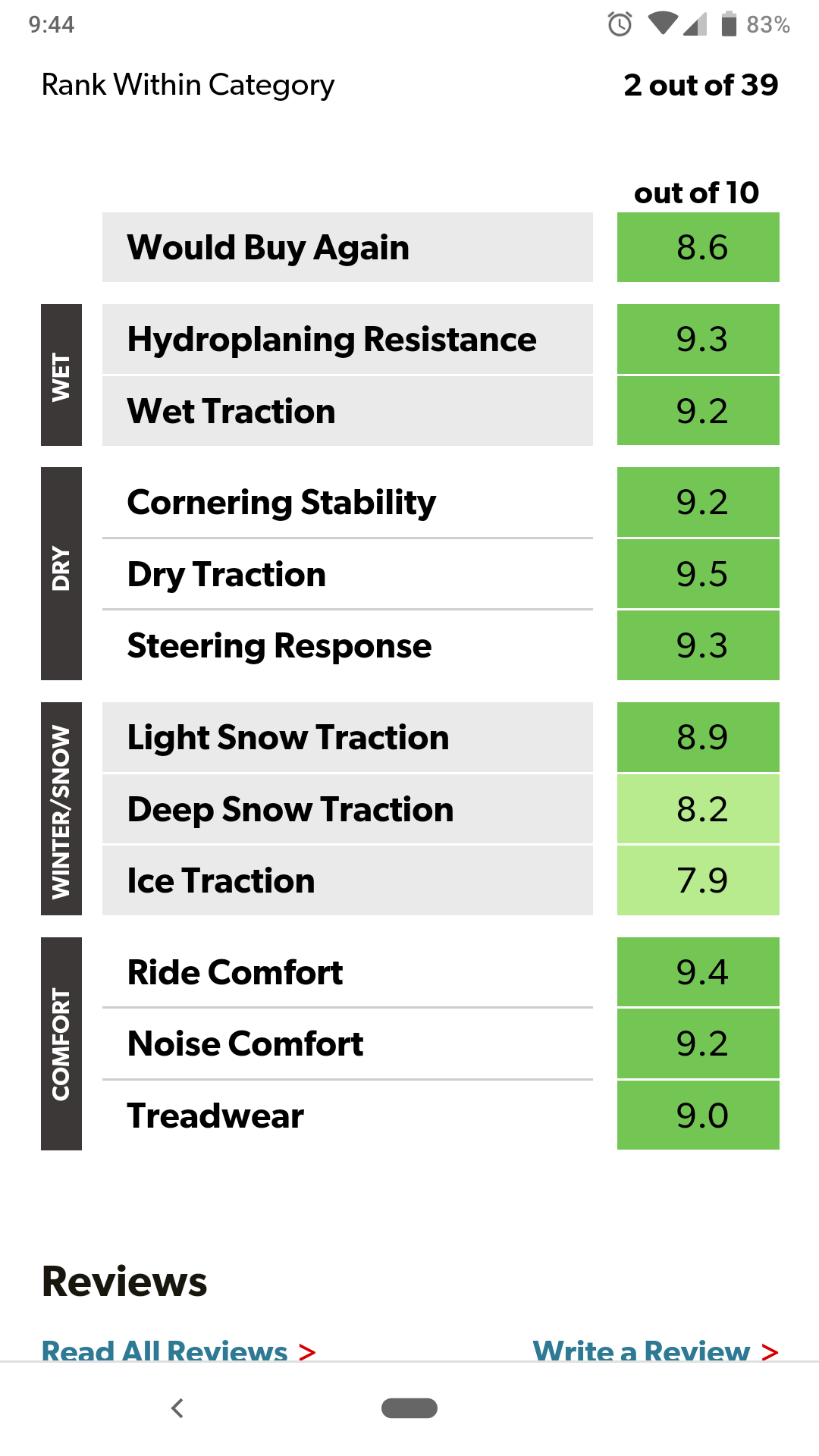

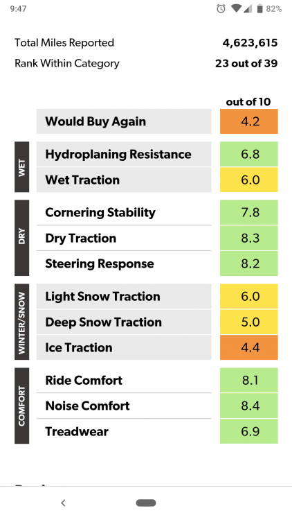

  1. After going through what I went through with the dealership not knowing how to balance a tire, and now the first snow driving with my truck on the Goodyear SR-As, I had enough ammo to justify getting new tires. They are horrible. I switched to Michelin Defender LTX M/S, and it is a world of difference. Quieter, softer, better traction in snow. You can look at the ratings on tirerack and see what I mean. I don't blame Goodyear, as these tires seem to be their budget-level tires, and I would guess all tire manufacturers have a comparable product. But for GM to select them to be put on a $50k truck is wrong.
