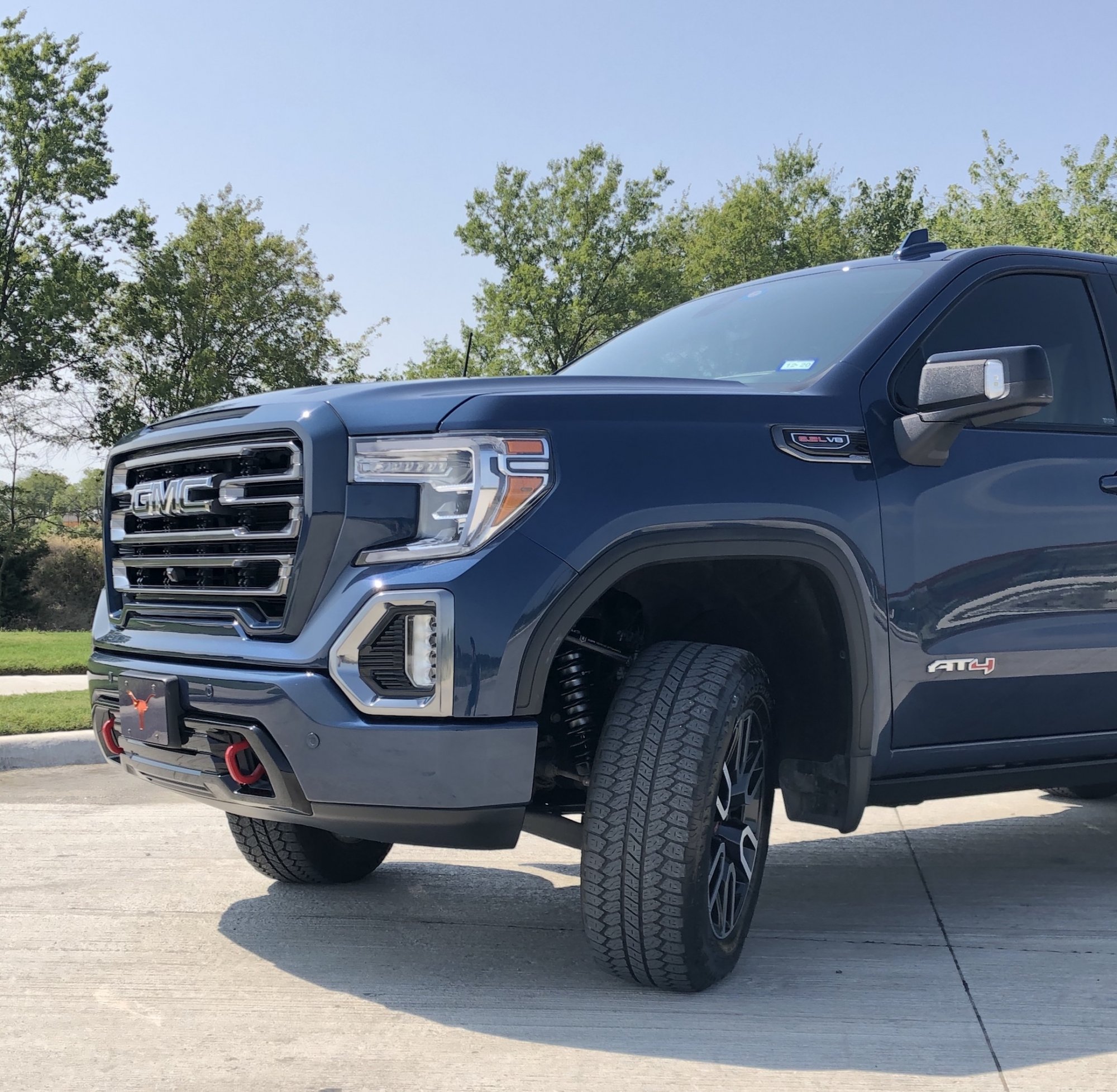

  1. I have the Stage 2 Icon Dynamics Coil over kit. This setup almost leveled the truck out, it added an additional 1.5" lift in the front. I have a very subtle rub at full lock on the driver side after following part of a couple of mods. That rub can be easily fixed with some liner trimming, but I just haven't made the time to do it. I removed the mudflap bracket as shown in this video: I followed most of this mod as well, but I was able to leave the entire bottom part of the mudflap for a stock look. https://wheelsasap.com/gmc-at4-oversized-tire-trimming-guide/

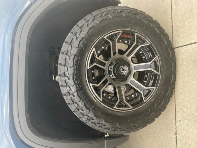

  2. Added 4Play 4P70 wheels and wrapped them with Nittos Recon Grapplers 35x11.5s.

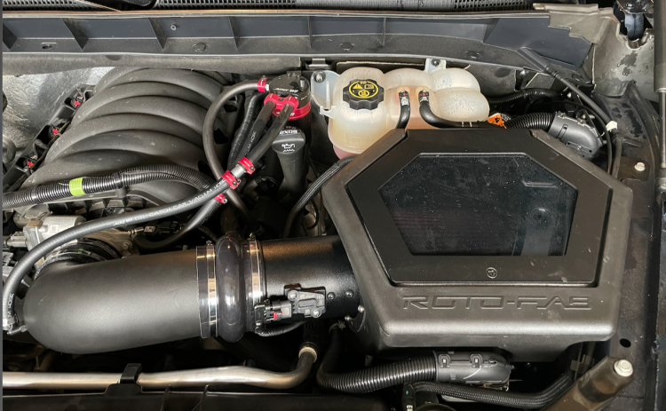

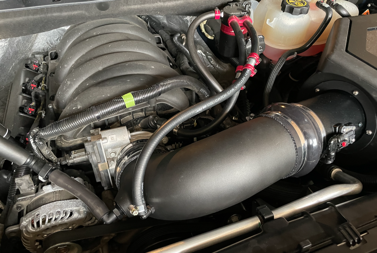

  3. Finally had the chance to install the @Roto-fabCAI and ADD W1 Catch Can. Engine bay looks cleaner and the sound when I step on it (which has been very often as of recent) is very impressive! My AT4 had the performance exhaust from factory, so this completes the system and really improves the feel from the 6.2.
  4. So far I love it. It made the ride firm, but in a really good way and I feel grounded. I no longer have the 5 hour bounce after going over a bump on the road (slightly exaggerating the amount of time), less roll on turns/curves, and there is much more control of the truck. As far as Lift, I was sitting at 38" from floor to the bottom of the plastic fender stock up front and 40.25 in the rear. I am now sitting at 38 7/8" in the front and 40.5" in the rear. I did not make any adjustments to the coil overs as I was told by ICON that they come set for their maximum recommended height (2" to 2.5"of lift on a stock 1500 Sierra non-AT4) from factory. I also measured from the floor up to the bottom of the plastic fender because I didn't change the tires. If I recall correctly, it is recommended to measure from the center of the hub up to an "x" point if you are making additional changes. This is my first suspension mod, so I could also be wrong lol. I looked at the Fox kit, but most of the info I found online stated that Fox users would eventually switch over to ICON. I debated between the ICON and the Fabtech kit, but I wasn't able to get enough info/reviews on the Fabtech's. Granted there is limited info of the ICON & GMC combo, but I liked the adjustability. I found a really good deal online that saved me a few hundred bucks, so I placed the order. The Kings looked good, but I couldn't justify the additional costs for my intended use.

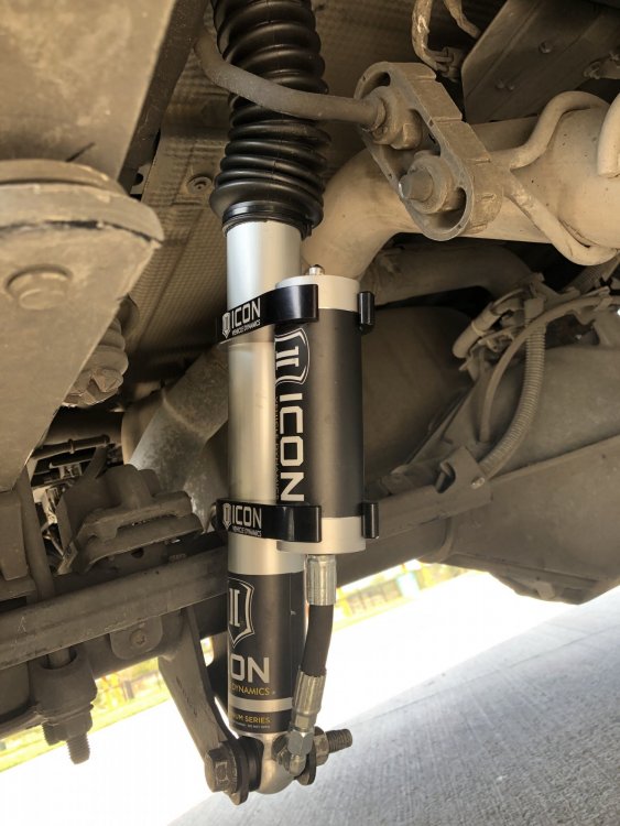

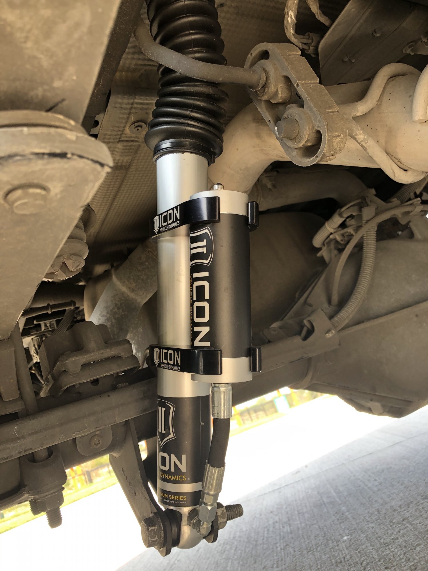

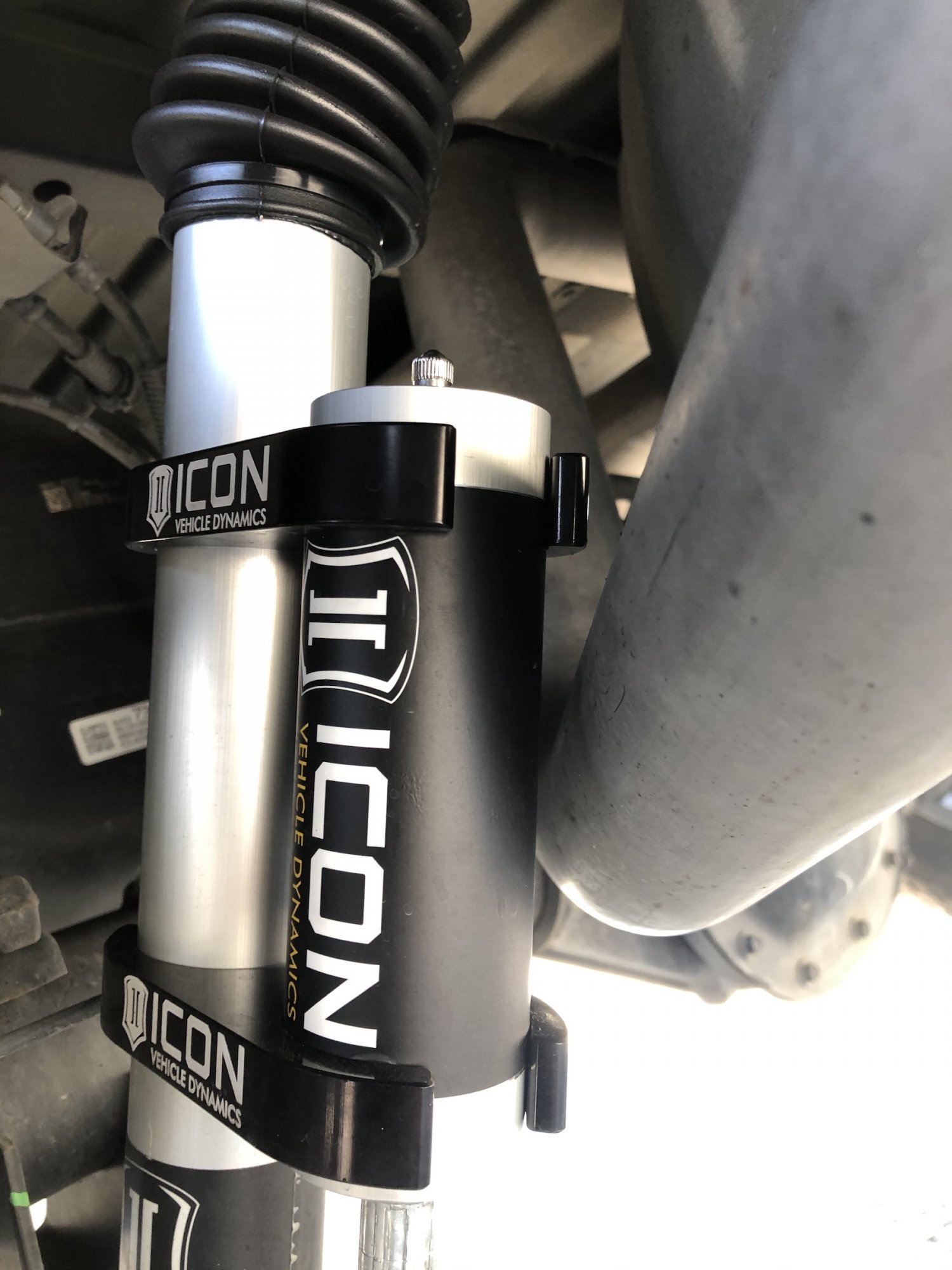

  6. Here are some pics of the rears with the piggy backs. It's really close...

  8. @Flatblack83 Looking forward to seeing what it looks like and know what your ride quality is like once they are installed. I'm liking mine more and more everyday. The piggy back clamps arrived today and I'll be installing those tomorrow. The space was snug on the left rear and I'm afraid that the reservoir is bumping something. I'll post an update later. Stock I was at 38" in the front and 40.25 in the rear with the stock 33's.

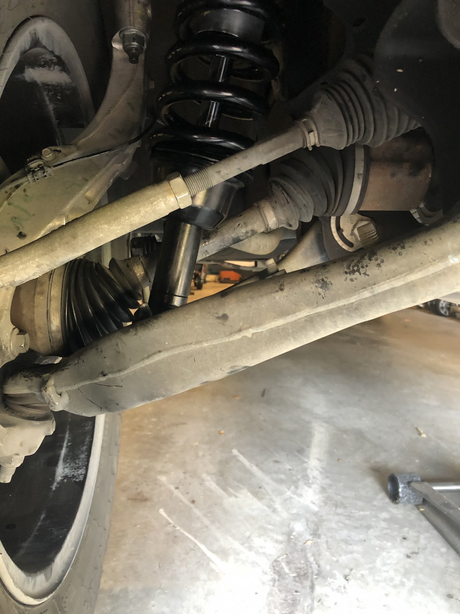

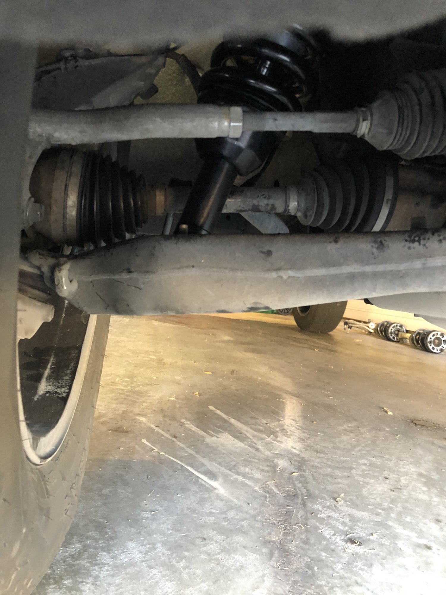

  11. @Flatblack83 Her are the pics at full droop. I don't think I would leave it in the air for too long without a second jack.
