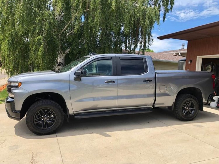

  6. I tried duratracs 35.1 x11.2 and I had maybe 1/4” to the liner. Not much room behind it either. If I cut the liner out in the spot I figure maybe 1/2” before I rub metal if I take it off-roading for hunting. Do you have any issues hitting bumps and dips if your in full lock?

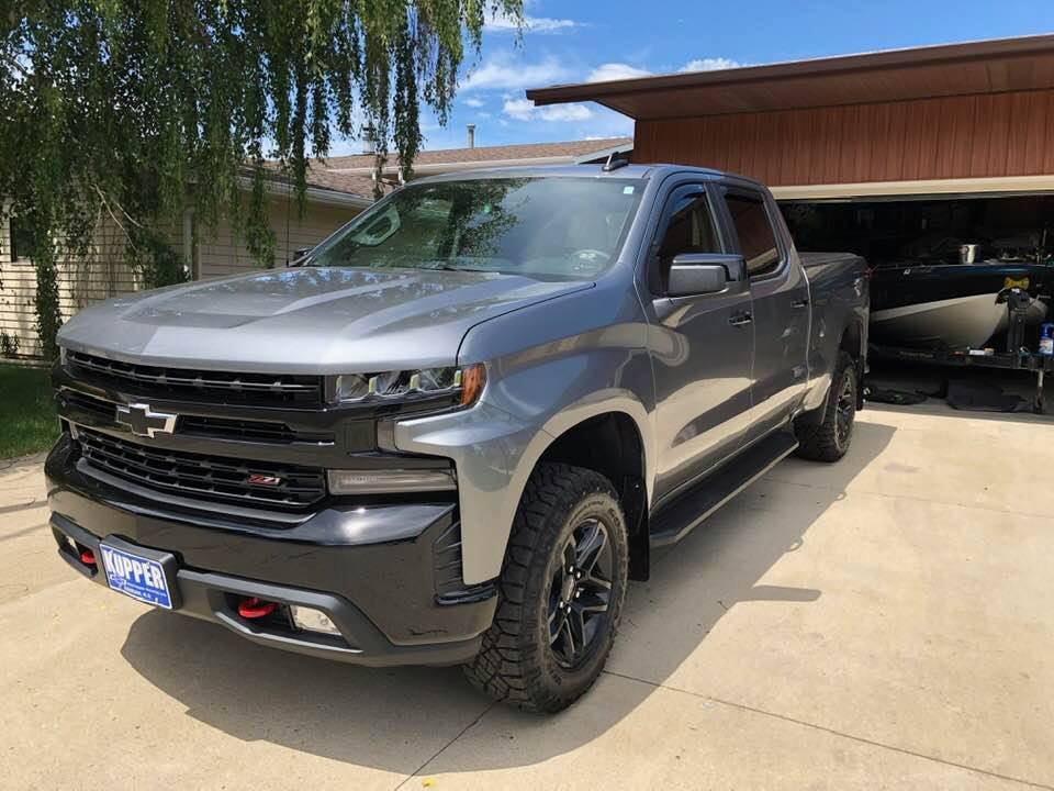

  7. just picked this up yesterday. had boards and tonneau cover waiting. De-badged it today. looks much better without that z71 on the side and trail boss sticker on the box. getting ready for ceramic coat and window tint. Also, got to throw on the 1.5 leveling kit and then I will order wheels and tires.
