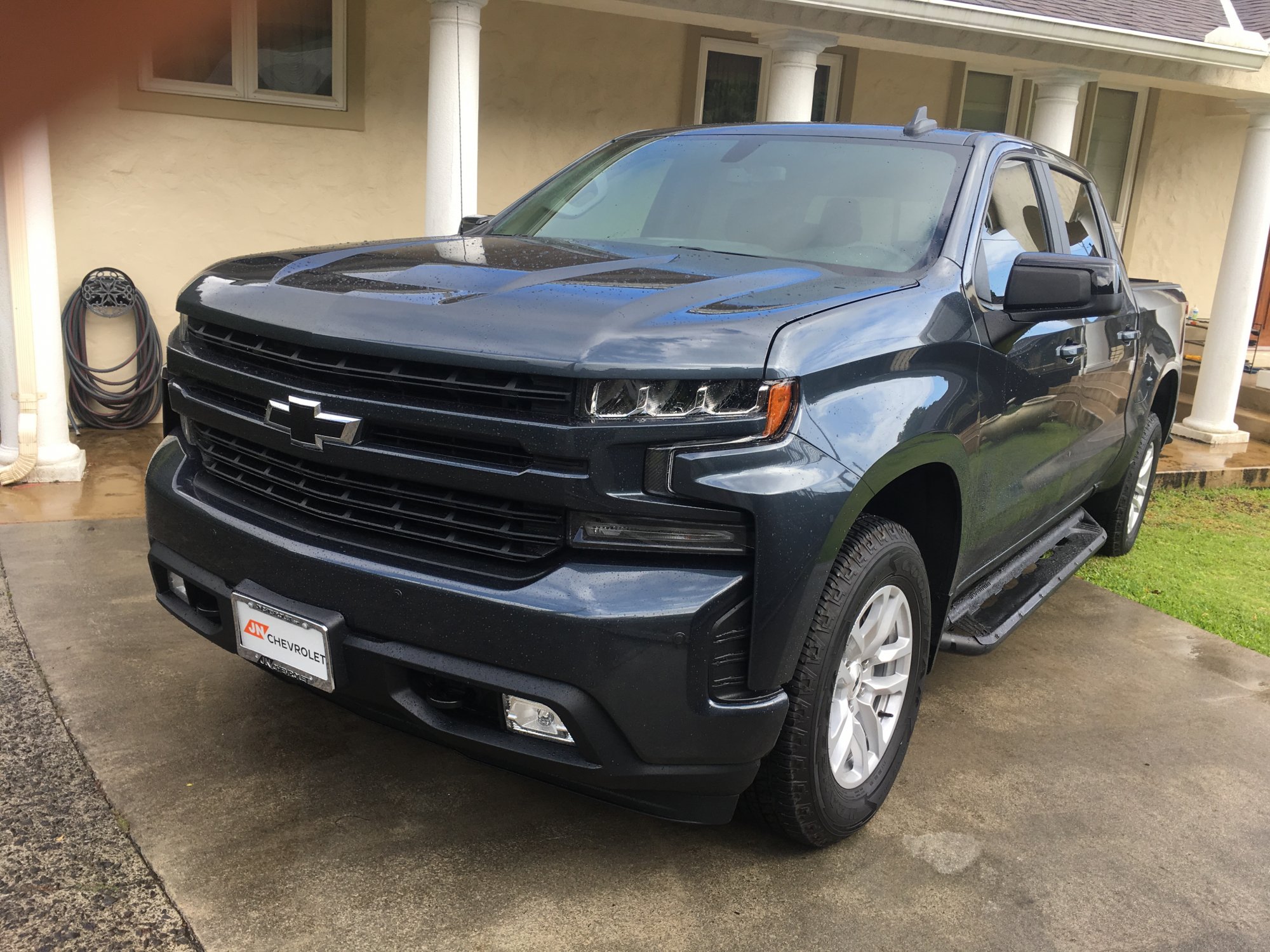

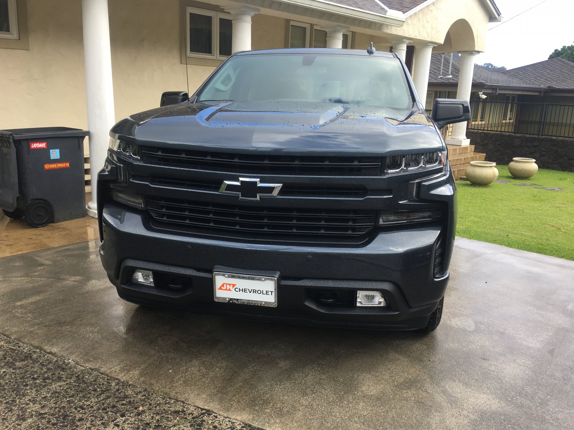

    Honolulu Hawaii

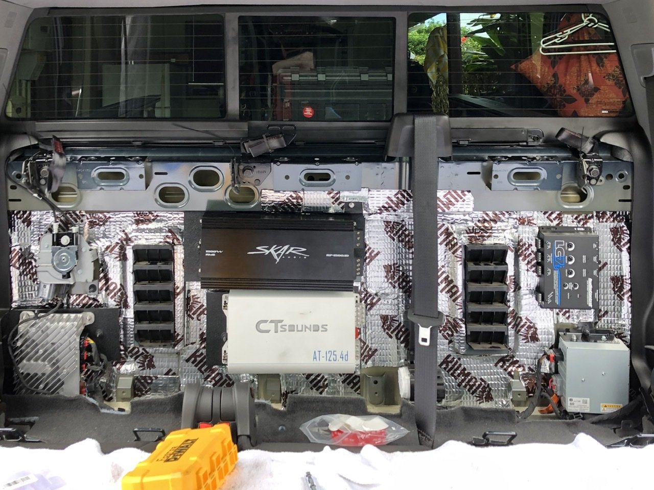

  1. Decided to continue the build as I wait for my LLJ harness. Removed rear seat and decided to relocate the Power inverted and Bose amps to the sides. Was able to fabricate mounting plates made out of 1/8” thick abs plastic sheets and utilize a few pre existing bolts while needing to add a few riv nuts to support a bracket hanging down from the upper metal. Lc7i, power & ground distributions blocks simply 3M double sided taped since they are fairly light. Skar 1500W feeding two 12” CT SOUNDS TROPO dual 4’ohm Wired to 1 ohm. CT sounds AT-125.4D amp gonna be feeding ct sounds 6x9 meso for front doors and 6.5 meso for rear doors. Sound deadened majority of rear wall because I removed all foam material behind seat. its definitely tight. But you can make it work. And looks so clean with everything hidden

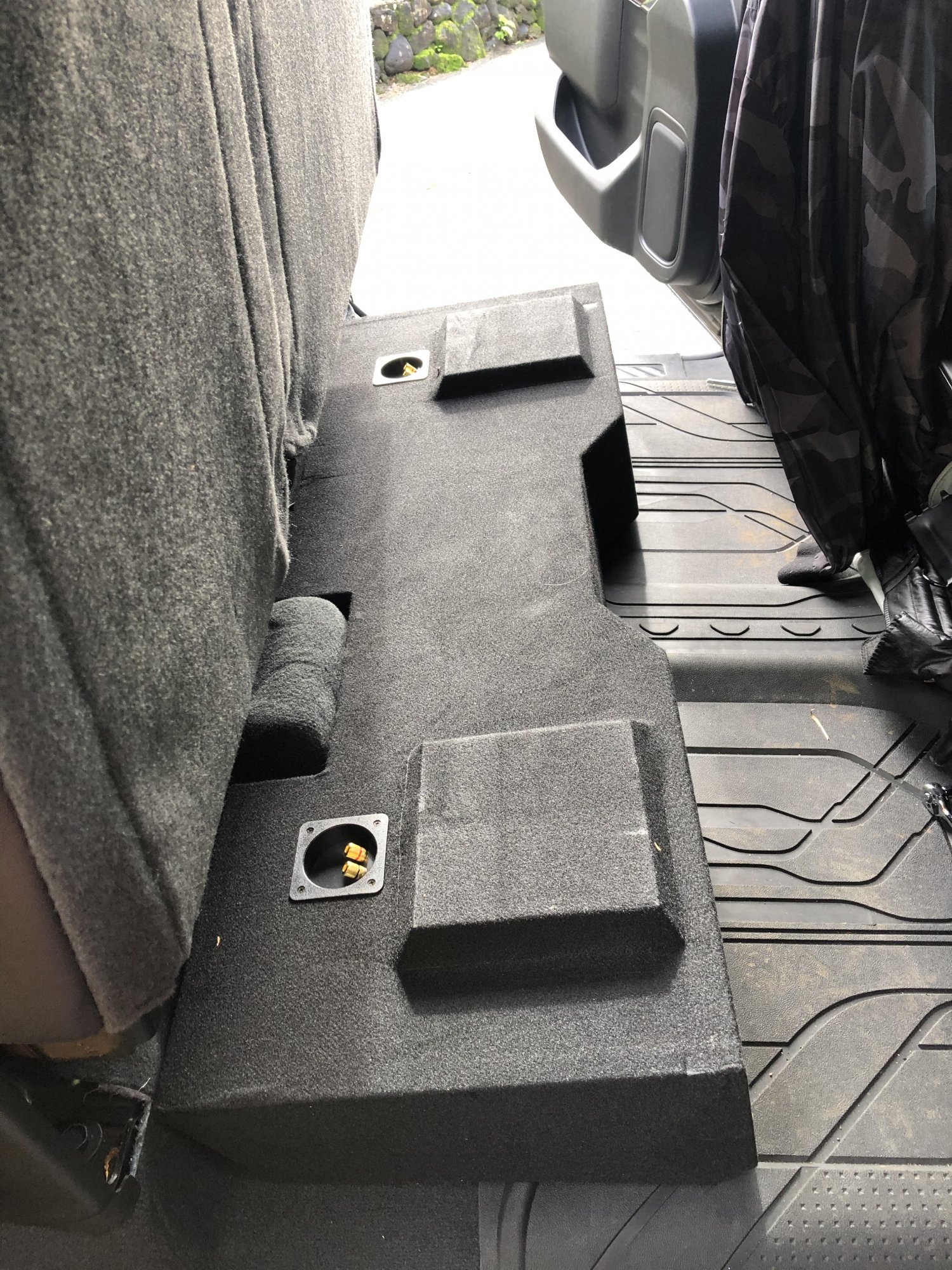

  2. Waiting on LLJ to start my Install. Pic attached is a box made for 14-18 years. Dual 12” damn near perfect fit will post more pics of build progress
