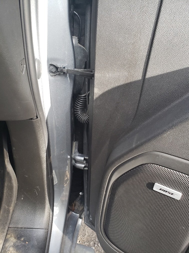

  4. Think I found it, there is some insulation between the door and engine compartment, it was twisted sideways and not really where its supposed to be. I can reach around and feel some loose fuzz. Just a heads up it was wet, had mud and pine needles at the bottom of the door....good place to keep an eye on for rust. I live in pretty heavy pine trees so they gathered there.
  5. You may be on to something.....I looked at the front of the liners but didn’t reach up behind them, will check out in the morning. thanks,
