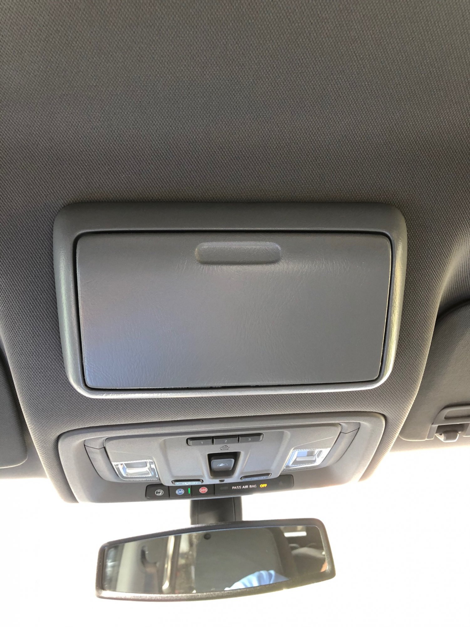

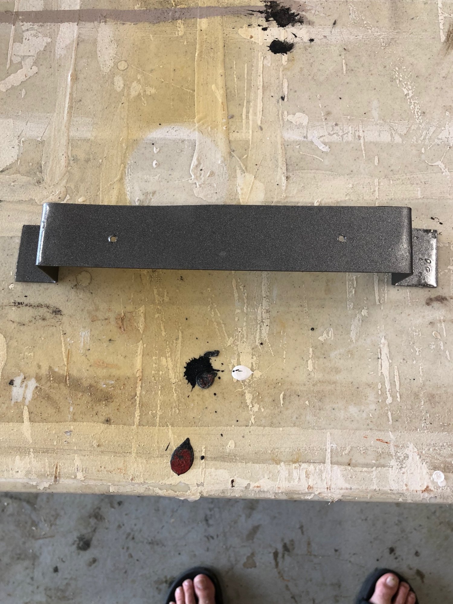

  3. The bracket pinches the sun glass holder to the head liner by using two screws installed through the inside of the sun glass holder into the bracket. If you take out the overhead console, you can see there is plenty of room for the sun glass holder and allows installation of the bracket. Very secure when done.

  5. Paint was just a stock spray can, it is not a perfect match but close enough. Yes, the bracket pinches the headliner against the sunglass holder to keep it in position.

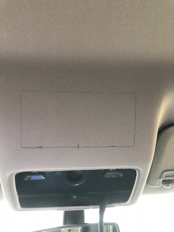

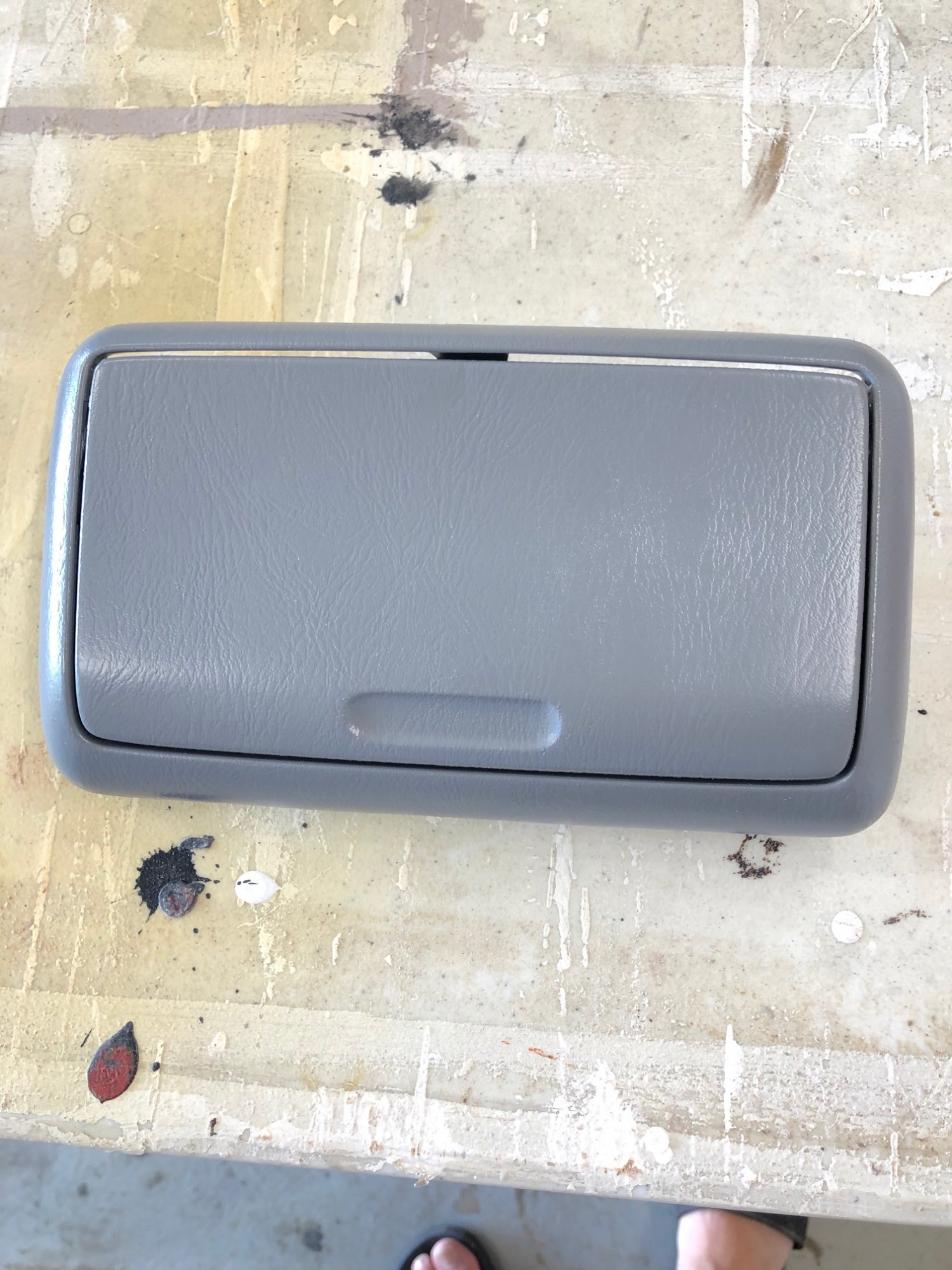

  7. I was missing the overhead console sunglass holder I had in previous trucks so I added one to my truck. The sunglass holder is from a 2002-2004 Nissan Altima that was painted to match the interior of my truck. A cardboard template was made for the cutout size needed to house the holder. The template was then taped to the headliner in the location preferred and traced with pencil. The headliner was cut using a utility knife, very easy to cut. A mounting bracket was fabricated out of 18 gauge sheet metal and painted. The holder was then pushed into the opening and the bracket attached with a couple of screws. Overall I am pleased with the results. I may cut down the trim around the holder so it sits closer to the headliner but will try it out for awhile first.

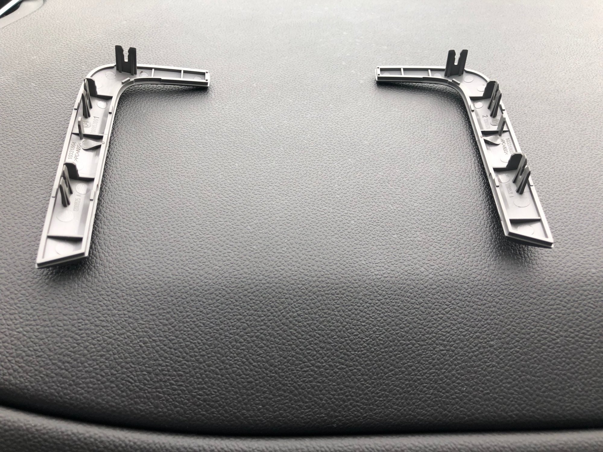

  9. They go around the rear view mirror and enclose the mount.

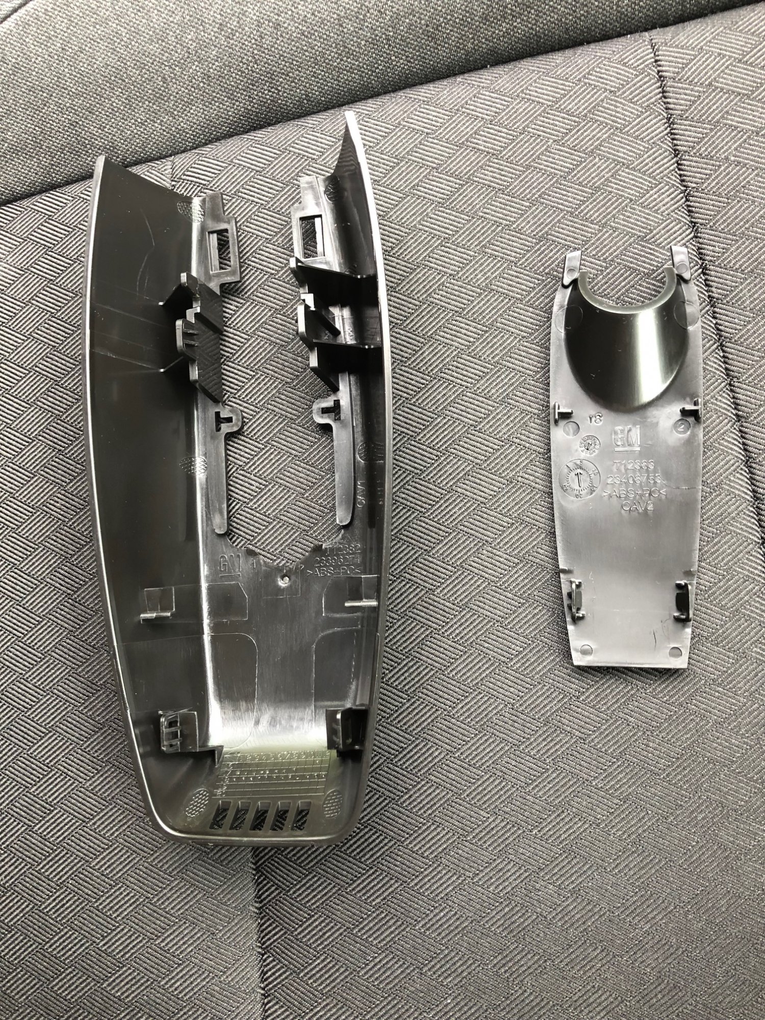

  10. I snapped a few pictures when I changed the mirror to the auto dimming. Maybe they will help someone with the swap.
