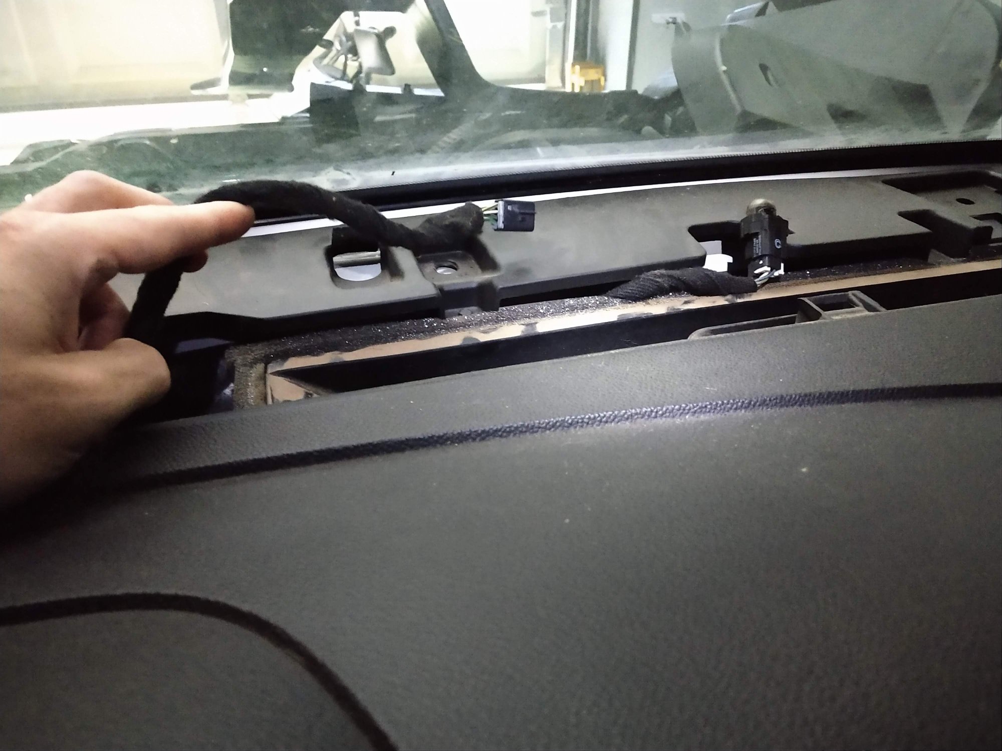

I pulled out the dash slightly (i didn't disconnect any cables so i could only go out so far) but I could not see anything. I did find one extra unused plug neatly tucked near the upper hvac tube delivering air to the very left side of the dash but it's not the correct shape for the receptacle. I'm thinking GM just made a standard wiring harness and whatever option I didn't get on the truck, the plug is left dangling. I am leaning toward it being a HVAC thing or an additional steering wheel control feature. Anyone with heavily optioned trucks, if you wouldn't mind looking under in the area of the steering column and see if you can find this plug? I'll see if i can find a ltz or something to look at. Peace of mind and all that. I'm gonna go ahead and proceed with putting things together and turn it on as soon as i can. Fingers crossed -

I'm putting my truck back together (new cab), and I've got almost everything except for this one plug and for the life of me I cannot figure out where it goes. Attaching pictures. It's not the light sensor which I show in the first picture, already plugged.... I'm stumped right now. Not sure if it is plugged up top or down low (I think I've eliminated the steering column because I don't see any extra receptacles). Already have 2 plugs ready to go for A Pillar tweeters so that's not it either. I've looked under the dash and at the top part of the dash multiple times and can't find anything. I'm really trying to avoid having to pull out the dash a second time Color of wires. I'm off to look for wiring diagrams but I usually don't have much luck finding what I'm looking for. A - Yellow/Blk stripe B - Brown/White Stripe C - Green/Blk stripe D - Green/White Stripe E - F - Solid Tan or light brown G - Solid Dark Green H -
