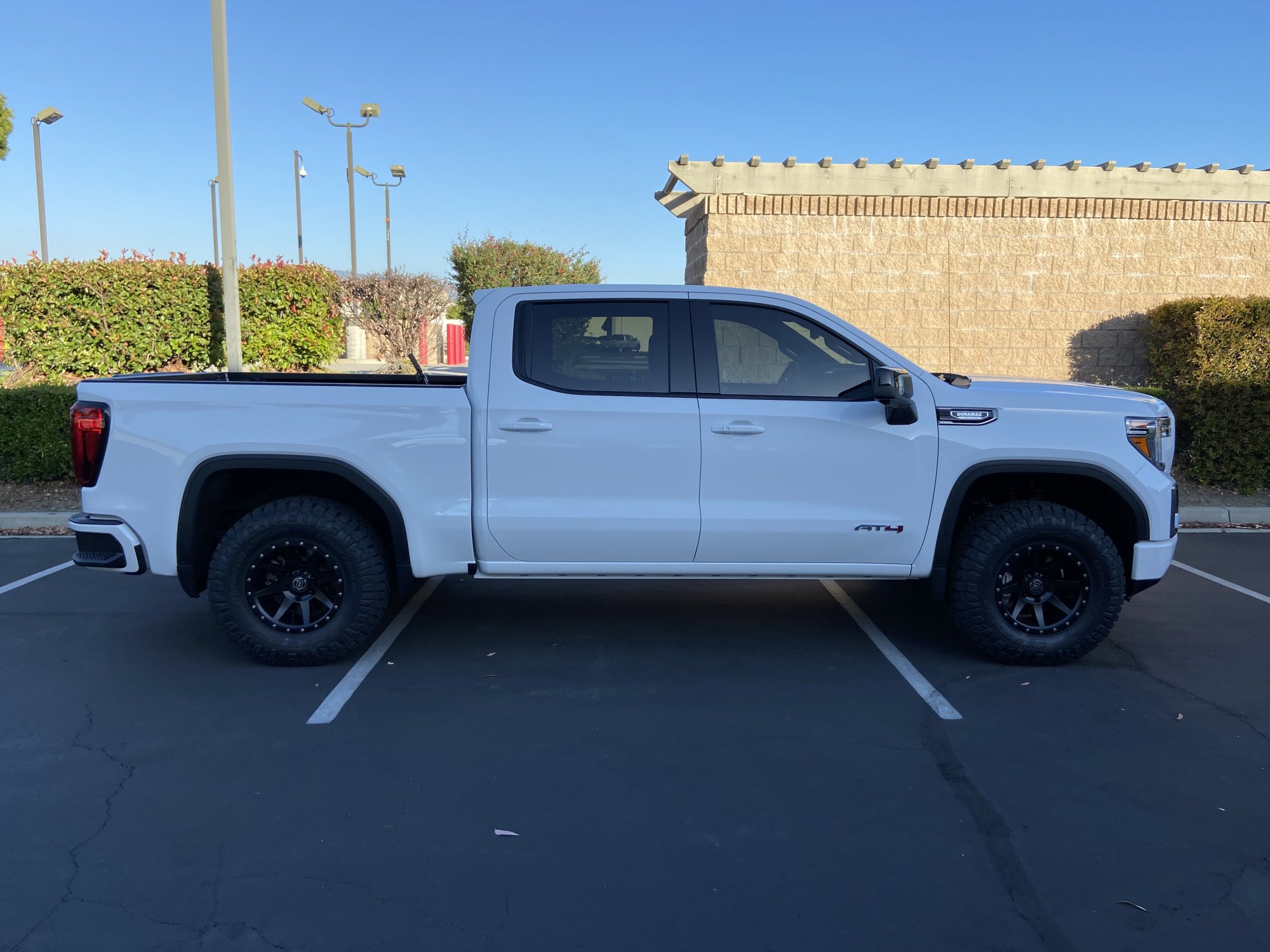

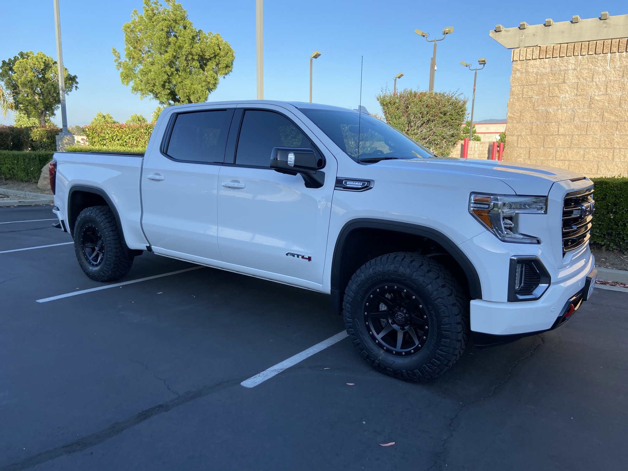

Not sure if this applies to your vehicle but I had my 2" rear blocks removed on my AT4 to get a more leveled look to avoid altering the front end. After driving it around for a week I could definitely feel a difference in the way the rear end handled small and large bumps. The smooth road handling had disappeared. Since the stock OEM Rancho rear shocks were made for the 2" lift I looked for a non AT4/TrailBoss shock replacement with zero lift and went with the Bilstein 5100 which are good for 0-1" lift. Truck now drives better than stock - on and off-road. Very happy with the shock overall.
