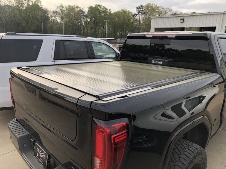

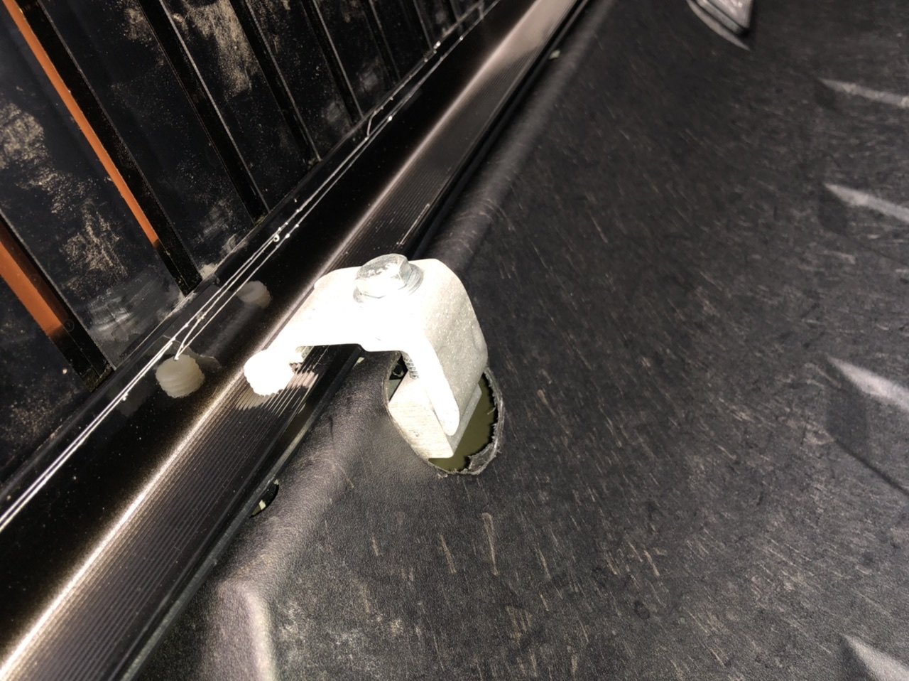

  4. The Retrax came off of my 2019 AT4 so it was already “put together” when I put it on the CarbonPro bed. All I had to do was drill 4 holes in the locations that the clamps go with a 1.5” hole saw. Clamped it down and had no issues with it. Pollen is already taking over here in east Texas.
  5. I successfully installed a Retrax bed cover on my CarbonPro bed this weekend by using the hole saw method. A lot easier than I thought it was going to be. Did not run into any hiccups.
