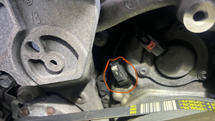

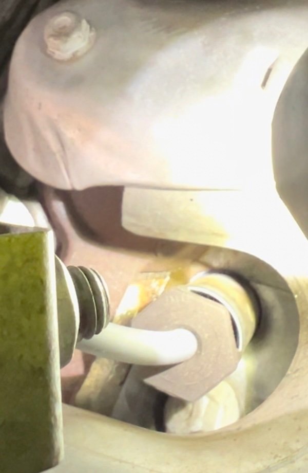

I noticed a small leak around the sensor next to the cam phaser magnet. Can anyone explain of the timing cover has to come out to replace this? If facing the engine its left of the cam phaser magnet. No oil pressure issues or check engine light. I just noticed it because I recently changed the O ring in the phaser and wanted to keep an eye on it.

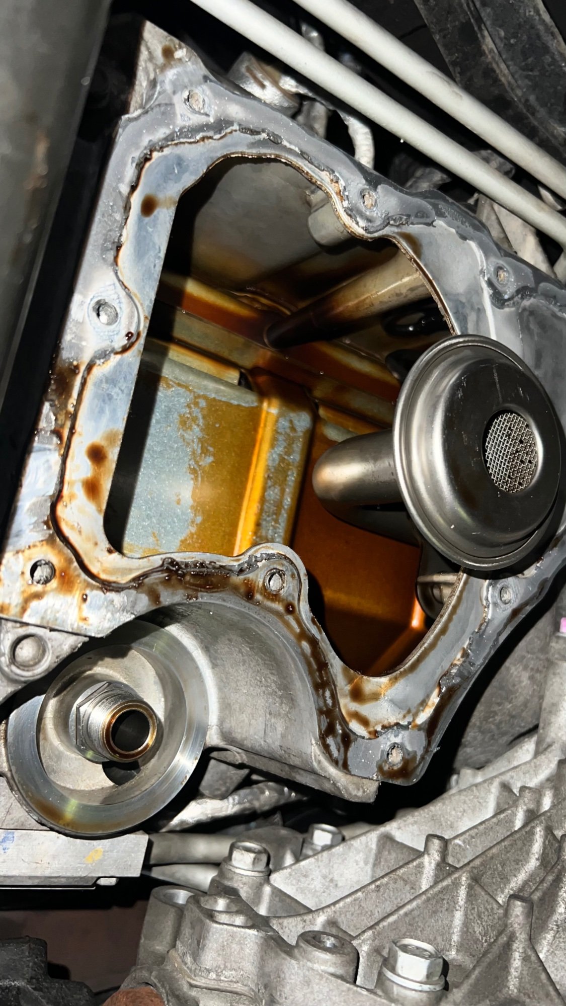

Yup I did all that. I didn’t add oil at all. It’s been sitting since Friday without oil. The oil that’s keeps coming down is small amounts. I put the rtv then waited an hour to torque and the plan was to fill after 24 hours. I attached a pic of the leak. The surface was bone dry when we installed it. From some off reason it doesn’t want to behave.
So my mechanic installed my lower oil pan today on my 2016 Silverado 5.3 and we waited 1hour to torque the bolts down. I also let the truck drain for 4 days prior to install because I broke a bolt that I guess was torqued too many times. The install went well new pan from GM but oil just running after a few hours. When we installed it it was bone dry but after 3 hours I saw a small wet spot near a corner mating surface. I use permetex ultra black will this eventually dry after 24 hours air do I have to do this again? We also didn’t scuff up the pan because the dealer techs said not to.
I have a 2016 Silverado z71 5.3 and I’m going to swap out the lower oil pan because it has a small leak. I purchased the pan from the Chevrolet dealer but they didn’t have the torque specs or tight pattern. I’m sure they did have it but I guess too busy to look it up lol. My truck doesn’t come with the gasket so I also picked up the AC Delco rtv. But I’m having a hard time finding the procedure to install this and allowing it to cure correctly. Can someone help with this? Thx
My 2016 Silverado has a very small leak near where the lower oil pan meets I guess the block. I have been tightening the bolts for two months now but decided to drop the pan and service the leak. My question is can the pan be reused or best to replace? And I believe mine has the rtv which looks like crap from the dealer smh. Is there a process and tight pattern to the rtv? Also should I wait to torque down?

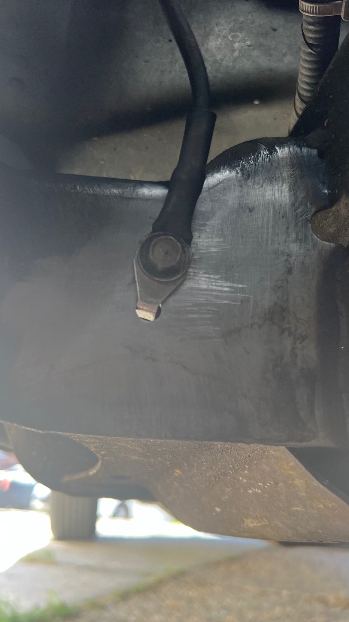

I hope so but this might be the last straw. Great truck but always fixing quality control issues. I’m usually on the highway with y family on baseball tournament trips. Thx god they were home when it happened and I wasn’t on a major highway I actually just got off it. I checked the dash ground and it looked like it was already done by the dealer. No insulation near the ground.
I've had this truck since practically new and never happened. Should not happen to any vehicle. I was told to check the grounds on the body and front drivers dash speaker. So far I just cleaned the chassis one and it was covered in junk. No contact to the body.

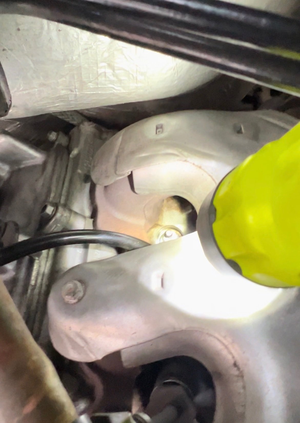

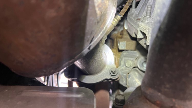

So my exhaust manifold on my drivers side has been wet around the rear bolt and gasket area. I’m not sure if it’s oil or condensation? The reason I say that is it doesn’t burn or smell like oil but looks like it or a rust stain color. It only happens when running and dries up quick. The truck drives fine. Also no smoking at the exhaust pipe. What could this be? I purchased a new manifold, arp bolts, gaskets and valve cover gasket just to replace it but doesn’t look bad. Truck has 101k on it.
So I was doing my spring/summer oil change and noticed this stain on the drivers side head/block. I don’t think it’s oil but I’m also not sure why it is. I sprayed it down with brake cleaner and it left like a water line stain. I also noticed it coming from the rear location of the exhaust manifold on the driver's side. I also see some burnt spots in the middle of the manifold. The rear manifold bolt looks wet when the truck is running but not oil cause it doesn't smell.
