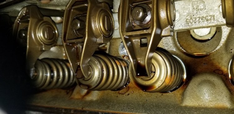

  3. Did it - I pulled the passenger side cover (the one leaking coolant before Bar's Leak), verified that it is not a Castech, and was pleasantly surprised that it looked fairly clean. Is there anything I am looking for besides evidence of a hairline crack? Are those orange marks on the springs rust? I was going to replace the gasket, but decided to keep the existing as an early warning system in case the leak returns.
