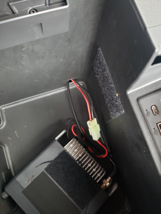

  2. heres some pics of my VHF install. the antenna is hard mounted to the front left fender. theres a company that makes a mount fro the new body style chevys. i used adhesive velcro to attach the radio to the console wall and ran the power and antenna under the seat and along the door sill under the plastic trims.

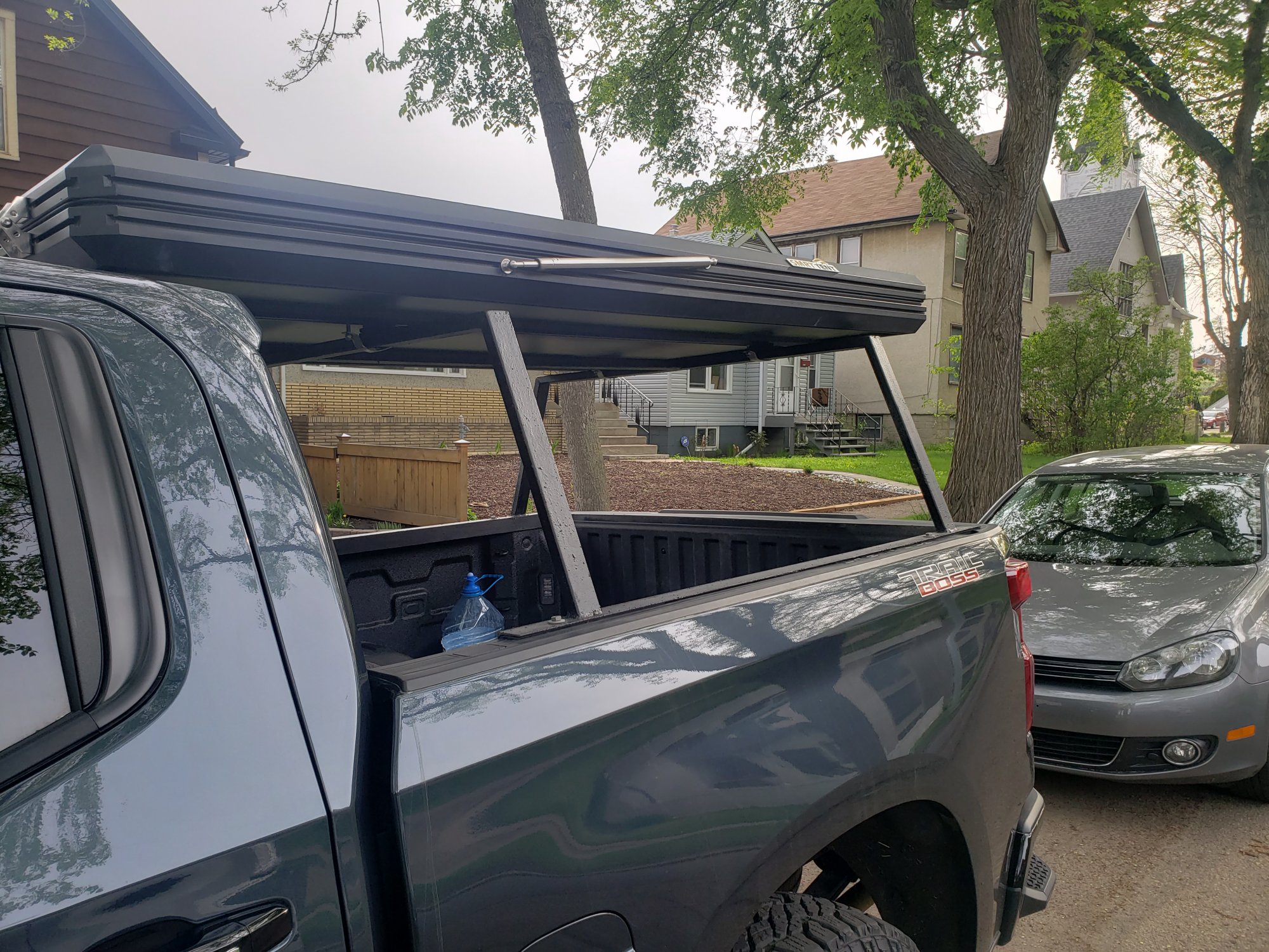

  3. here's a rack i made for my rooftop tent. the steel cost me 57 bucks and it took about 4 hours to make including drinking beer and bullshitting. angle iron keeps it in place and i drilled 2 holes on each side and bolted it to the box. works pretty good. wishing i would have got the 6'6 box so the tent could be flush with the cab, but this way i can jam the quad in there if i air down the tires enough.
  4. i put mine in the center console with a hole drilled in the side for the cabling. ill see if i can get you some pics tonight
