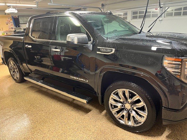

  2. Finished up this morning. Started at 9am, gave the truck a quick wipedown with the prep spray. Took 15 mins. Started on the hood and did it in 4 or 5 sections, taking my time, overlapping each section and applying left-right then up-down to get full coverage. Took about 1.5 hrs to do all the truck panels. Did not do the grille, glass or wheels with the deramic coating. Had to go back and touch up a few areas. Took a long time on the roof. That is a big piece of area. Took another 30 mins to do a spray wax on the wheels and grill, then I hit the running boards again. A few things - Id probably not do this if my truck wasn't black and if I was able to park inside and do regular hand washing. It takes a lot. But having this coating on shoujld allow the truck to stay cleaner much longer and I won't introduce scratches with routine washing & dry. The Adams product goes on easy and wipes off easy. I had a few spots I missed wiping off that I caught after i pulled it outside. Just reapply the coating with the applicator and wipe it clean. Easy. I really like that this stuff can be appleid to glass, plastic, trim etc. It really makes the top of the bed rail, mirrors, running boards etc look good. The overall slickness is very good but maybe not as good as a full carnuba wax But obviously that only lasts a few months. I applied the product pretty heavily and still have over half a bottle. So overall I'd give the Adams product a thumbs up. Now we'll see how well it lasts.

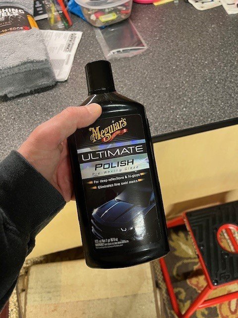

  3. I picked up on this project again today. Been sitting since Thurs night. Got all my supplies from Adams. Worked with the porter cable random orbital buffer and Meguiars polish which is very light for very light scuffs and overall cleaning, not any sort of real cut for deep scratches or swirls but truck is new so that's cool. Spent about 3 hrs to get it right. Ended up going over a few areas twice and spent longer than I should've making sure everything was buffed off after, kinda hard in the garage even with bright LED's and a couple work lights. I wouldn't have spent as much time but knowing this job should last a few years, I was willing to spend the extra time. Overall very happy. Ready to hit it with the prep spray in the morning and lay down the Ceramic. hoping that only takes about 1.5 more hours. Tailgate shine is insane.

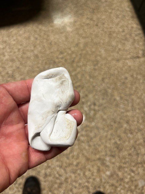

  5. Adding some details here for those who may be interested in doing this themselves. Last night I got started in the garage. Gave the truck a really thorough wash last night, took close to an hour. Paid extra attention to the wheel wells, bumpers, glass, mirrors and running boards. Also ran back over everything with clay bar. It barely picked up any grit at all, maybe a bit around the wheel wells. I debated whether or not a light polish was necessary. The truck only has 2,500 miles on it. Paint is in excellent condition as you can see. I think I'm still going to hit it tonight. I have a Porter Cable random orbital buffer I'll use with the Meguiars polish, has a very light polishing effect. This is more to remove the existing coat of wax. There are a few small light scratches I could see, walking around the truck with a work light. This should knock those down, remove the existing wax and hopefully be ready to start the ceramic coating tomorrow.
